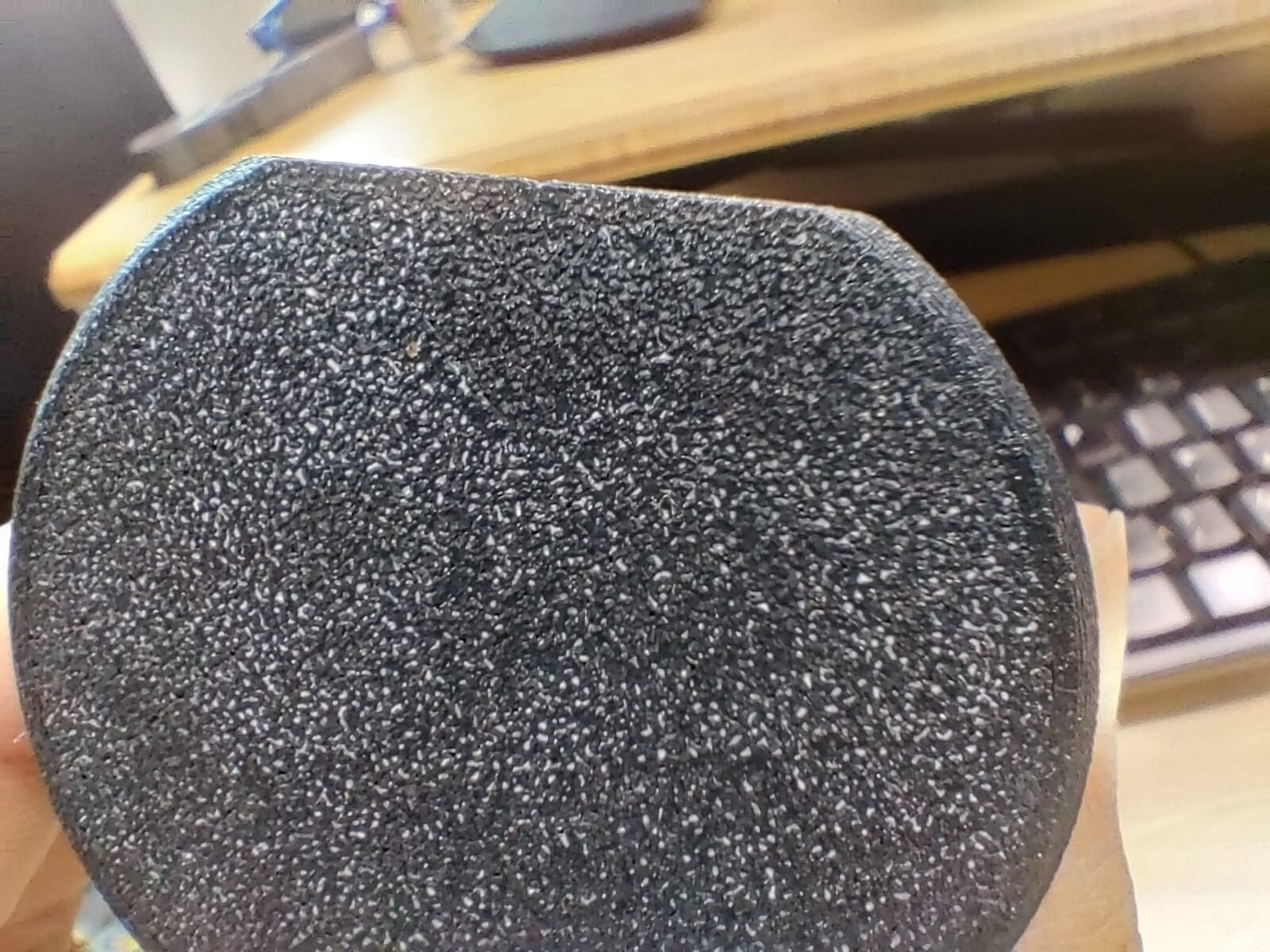

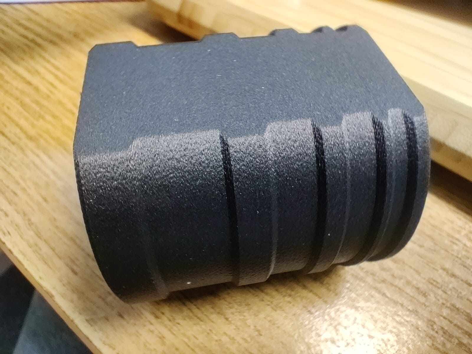

Howdy, I've just started printing with Prusament PC Blend Carbon Fiber Black, Prusa recommend Satin or Textured sheet for printing.
Finish is great, and beds adhere well, but when removing parts there is some kind of a white residue on on the underside.
I use all kinds of material on both beds. Is this residue just leftovers from old prints? That will clean up with continuous printing, or is this bed material which will always be there on every print?

Did you use glue stick on the sheet?

No Gluestick, I just clean with alcohol each time

I printed a fair amount of PC-CF recently and never noticed a white residue so it may well be ghosts of prints past. @clemens-m, I used a 0.4 mm Obxidian nozzle. On my Mk3S printers, I have tungsten carbide nozzles.

Take a look with a strong hand lens; at the print sheet:  if the marks are residue then there may be some remaining residue in the crevices on the sheet, if the marks are sheet material, pei, then there will be broken peaks and small bare patches on the sheet.
My bet is on residue, sticking with just one solvent selectively leaves whatever it can't shift.  DO NOT use acetone on satin or textured sheets but it's worth switching between IPA and dishwashing detergent with HOT water from time to time just to take advantage of the different activity.
