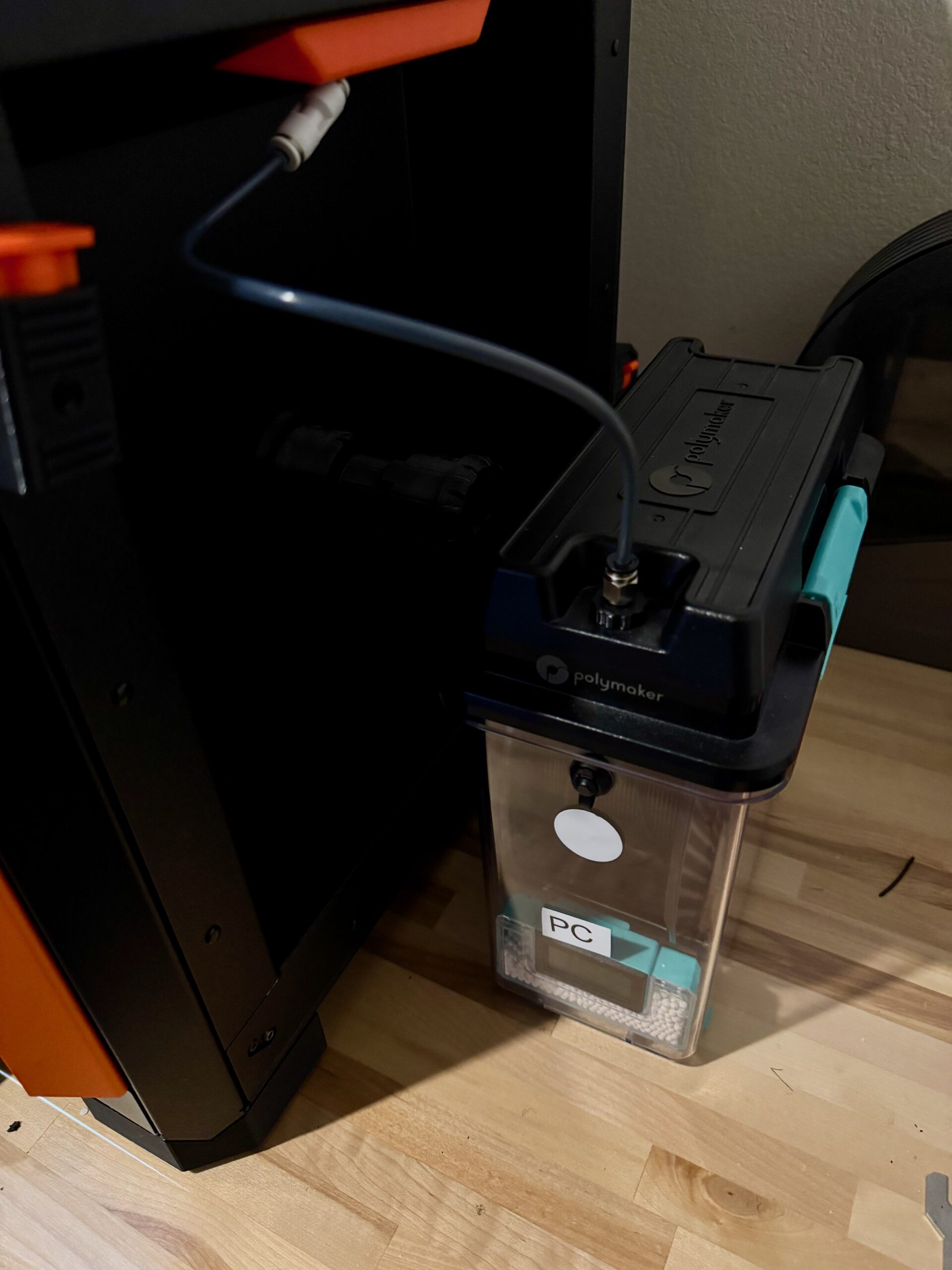

Dryer connection
I am considering buying either the Sunlu dryer or the Polymaker dryer. In both cases, I have the same question. How do I connect the PTFE tube from the dryer to my Core One? The Polymaker comes with 50cm of PTFE tube. Is there a connecter I need to connect the tube from the dryer to the Core One input tube?
Prusa Core One
Posted : 10/01/2026 3:23 pm
RE: Dryer connection
I would avoid the Polymaker dryer unless you only plan on using it with PETG and PLA. It can only reach up to 55C. I do however use the Polymaker dry boxes to store my filament. I use a PTFE coupler with a short length of PTFE tubing. Not the one that comes with the box, they are garbage. Too stiff so I just throw them out. Just pick up several meters from Amazon (or Alibaba etc) and cut as needed. If you want a decent dryer with a great UI, I would suggest the Creality Space Pi 4
PTFE Tube Kit
PC4-M6 Pneumatic Straight Fitting
Polymaker PolyDryer Box PC4-M6 Coupler Adapter

I finally received my Creality dryer and Polymaker dry boxes. I also rcv'd the PTFE kit and PC4-M6 Pneumatic Straight Fitting from amazon that hyiger recommended. I printed the couplers in PETG, for now.  One last question, how do I connect the PTFE from the dry box to the PTFE input of the Core One? I know this seems like a lot of hand holding, but I am totally new to 3d printing. Thank you all in advance.
Also, if I want to spool directly from the Creality dryer, is the connection any different than you've shown in the above Polymaker dry boxes?

Ok, after opening hygier's picture above I see a white couple at the Core One. What is that? And where do I get one?
Prusa Core One
Posted : 17/01/2026 5:01 pm
Posted by: @phil-16
The come with the PTFE tube kit: https://www.amazon.com/dp/B0F27YQF27?ref_=ppx_hzsearch_conn_dt_b_fed_asin_title_55&th=1
