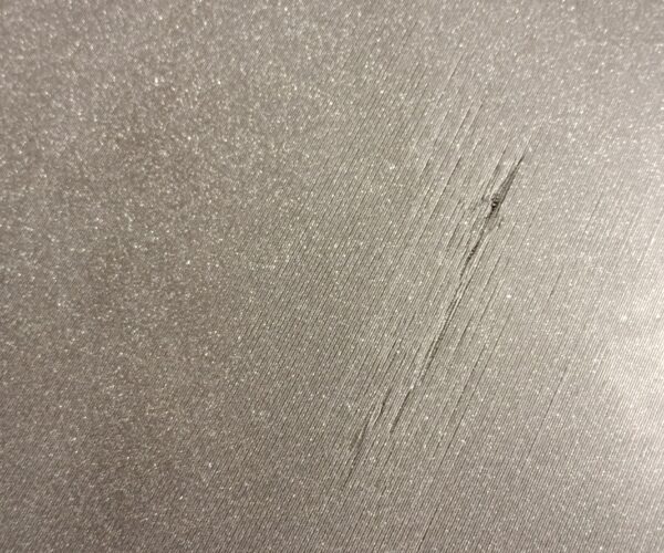

I've been having more quality issues lately and don't know what's causing them.
Maybe one of you has some advice.
I'm printing a large container that almost fills the entire heating bed.
I'm using Prusament Galaxy Black filament.
The heating bed temperature is 60°C, nozzle 222°C.
The underside is printed incorrectly, see photo 1.

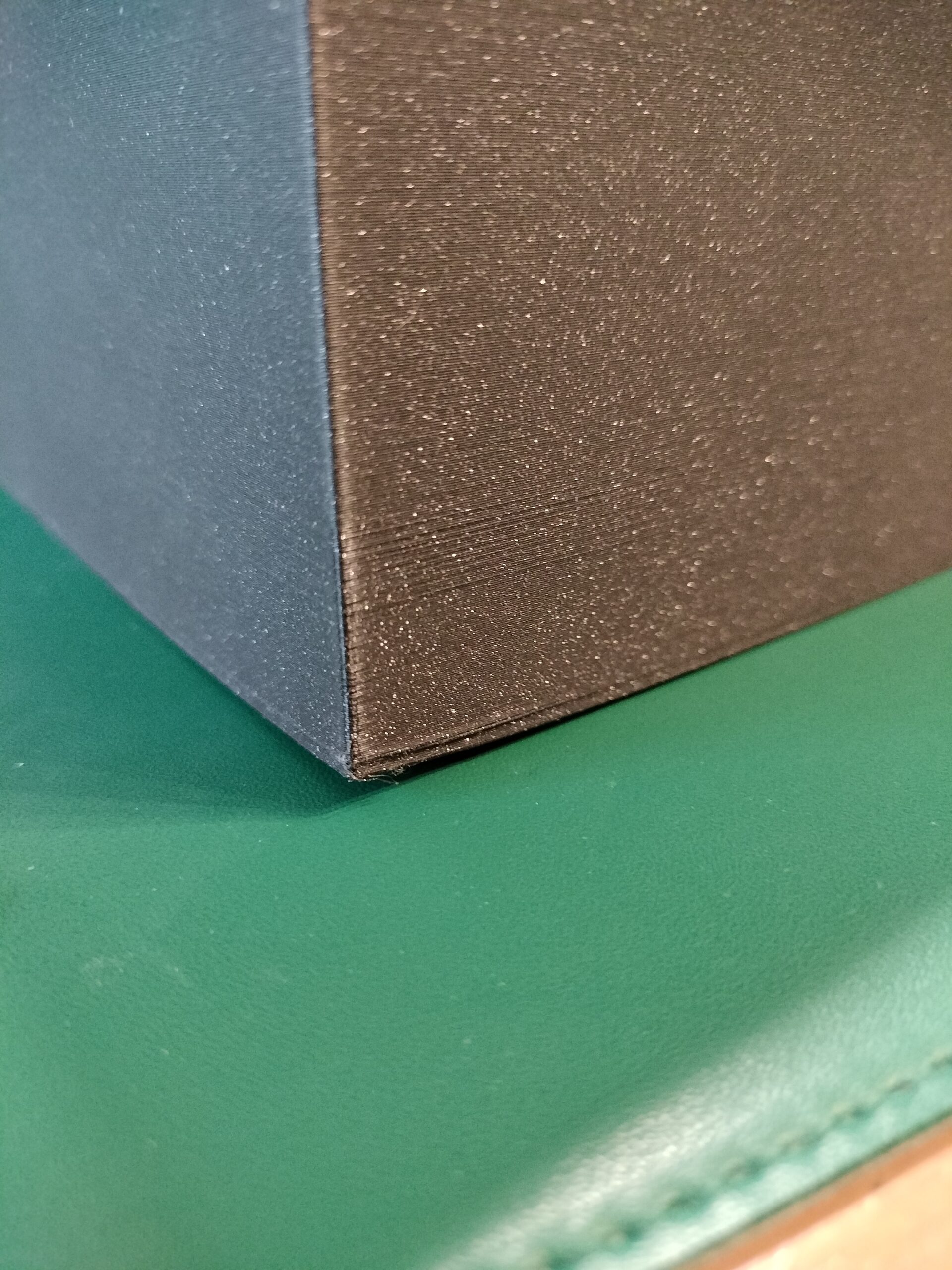

In the corner at the front left edge, the filament comes loose, even when I print something that fills the entire surface of the heating bed (see photo 2).
Thanks for any tips.
Best Answer by mnentwig:
Moisture? Make sure the filament is dry. It's the single most important issue...

With underside I mean the side that lies directly on the heatbed.

...the nozzle temperature doesn't fit to Prusas preset for their own PLA filament!
You have an adhesion problem, yes PLA also can warp. Stick to the preset profile!
Place a brim around larger parts or add the "famous"  mouse ears - called "helper disk" in Prusa Slicer -> add part -> Gallery -> move it to the edge, max 1 layer height!
Avoid "sharp" corners, make round corners when designing yourself.

Recommend starting with the Prusa Research configurations in the slicer until you figure out the idiosyncrasies of your printer. I had this problem also. TRy going up or down ten degrees at a time, and work that. Print a temp tower for that filament and your printer.

Thanks. I did not know the helper disk.

Thank you. This was the point I think. I thought it would not be necessary to put the PLA in a dry box, because it was not indicated on the Prusa Material sheet.
This was a mistake.
Posted by: @mnentwig
