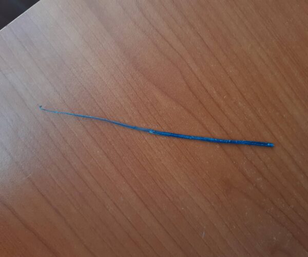

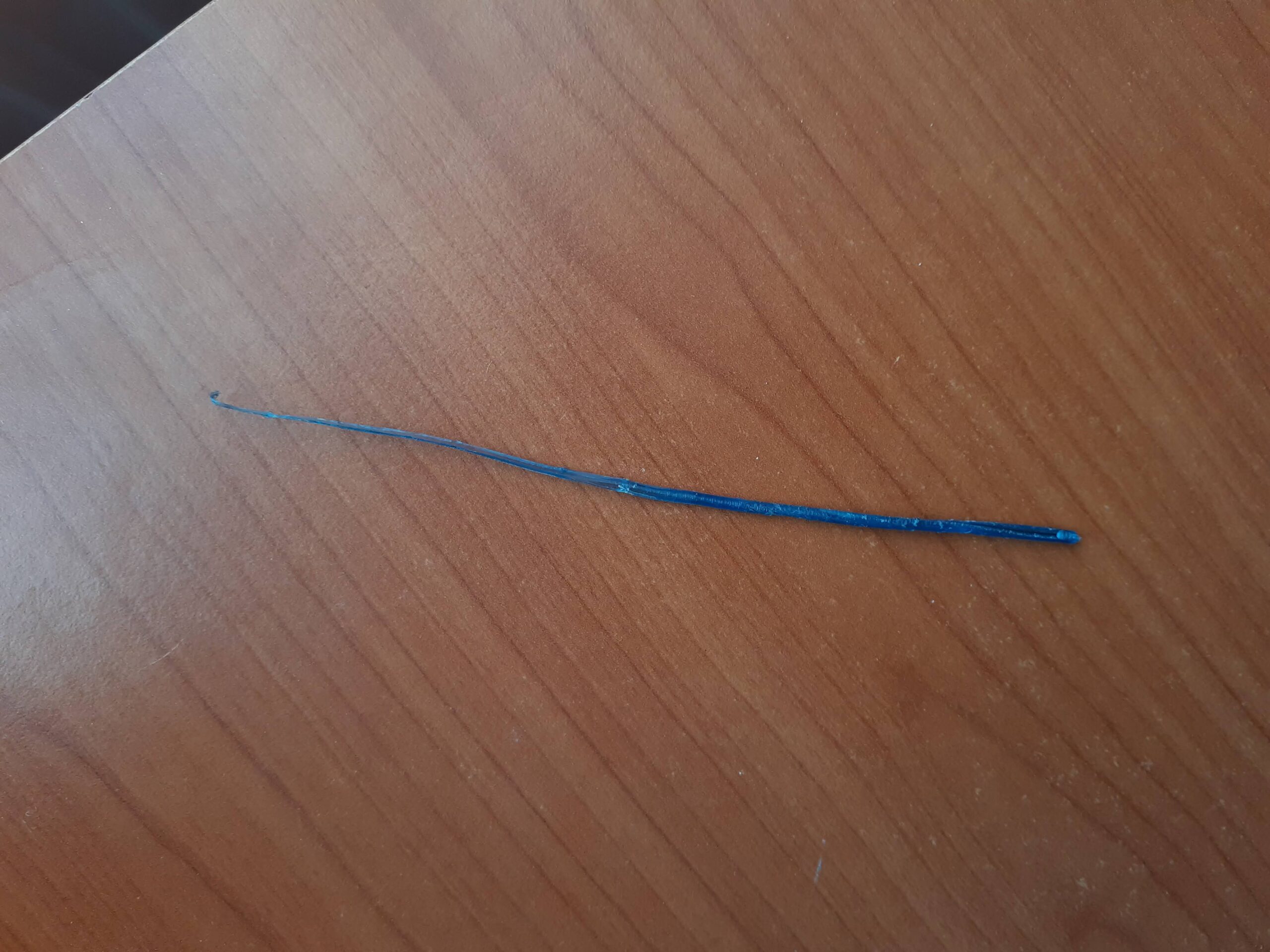

Was something modified regarding the filament sensor? it seems like it doesn't detect the end of the filament as the previous firmware, I am printing with filament from my pullstruder and it used to detect the end of the filament, now it continues to print untill the gears can't push on the filament anymore, and it's not a jammed nozzle problem, and this didn't happen before as it would stop itself, autoloading filament still works so it's not a faulty sensor
pullstruder filament end
