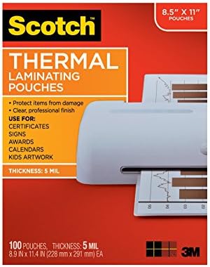

thedachtlers
(@thedachtlers)
RE: Using a Cricut for the transparencies
@merrill-a
we got these on amazon
Scotch Brand Thermal Laminating Pouches, 100-Pack, 8.9 x 11.4 inches, Letter Size Sheets, Clear, 5 Mil Thick for Extra Protection (TP5854-100)

Carl A
(@carl-a)
@thedachtlers
I received from Amazon and found that these are sleeves to be used for certificates and you need a machine to seal them, they are not transparent (clear) on both sides and too thin to be used. Maybe I missed something you are doing to make them work. I have 200 so can afford to expirement.
Posted : 11/04/2020 1:40 am

thedachtlers
(@thedachtlers)
@merrill-a
I’m so sorry. I thought you knew you need a laminating machine as all laminating sleeves like this require heating. Once heated it is clear and semi-rigid
