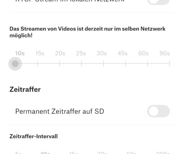

Hey, on ios i was able to update the Prusa App.
I also see some more options, like enabling the stream for the local network. Unfortunately I'm not able to set the new options. Can't figure out why.

I tried resetting my cam. Is it a successful reset, when the cam wants to scan a qr code? I tried pressing the button 1 sec, 3 sec, 7 sec. Always just scanning the qr code. Of course after deleting it from connect.
But still no possibility to activate the new features. Also where do you have the possibility to change the mode? Day, Night, Auto?

Someone already managed to get RTSP working? I enabled it in the Prusa app. But can't access it via RTSP. Is it a specific port?
