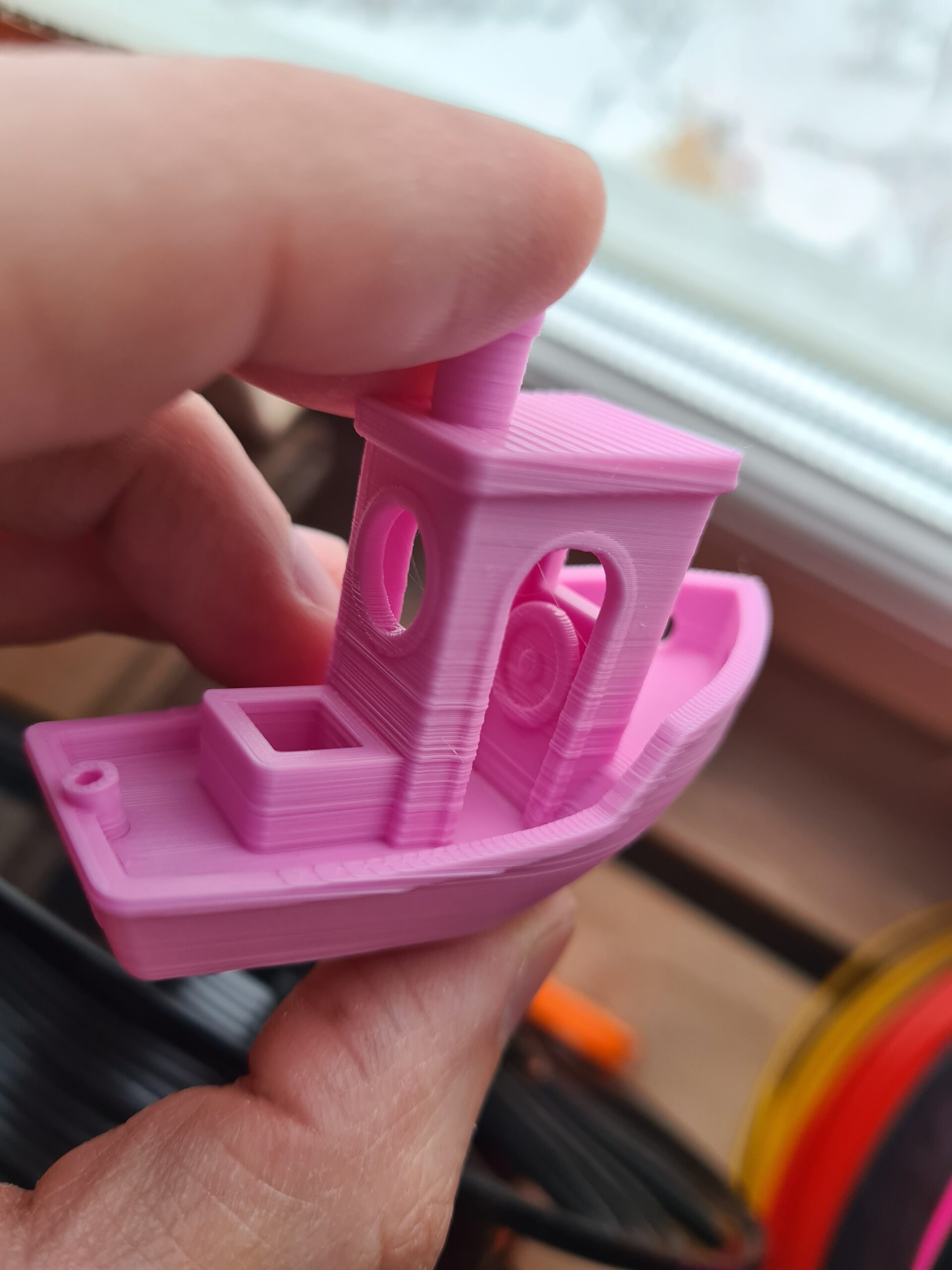

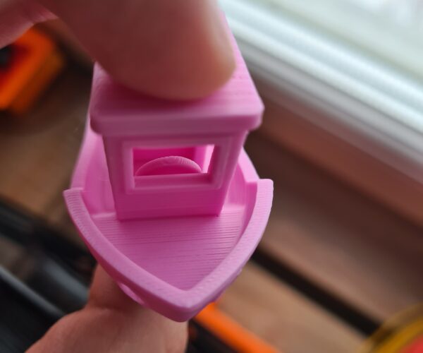

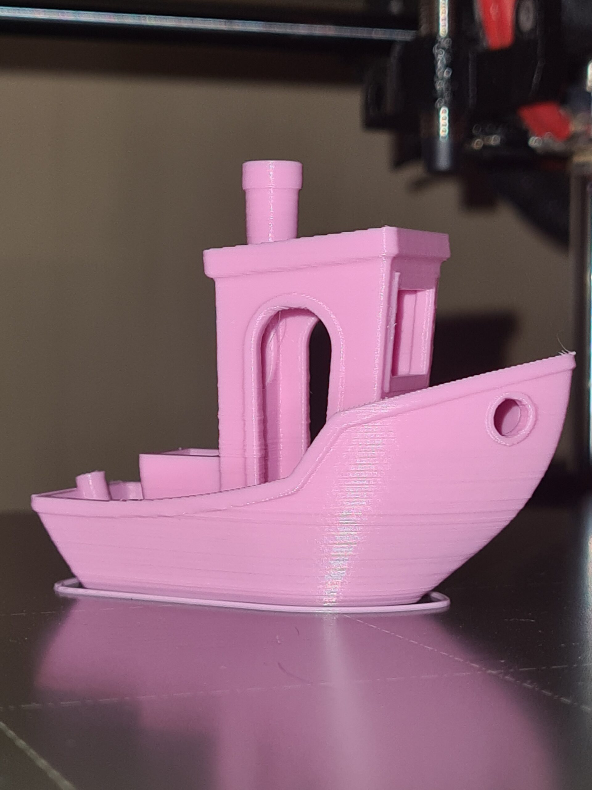

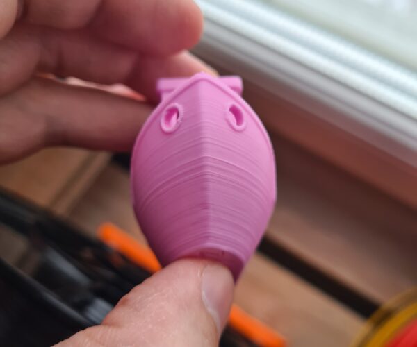

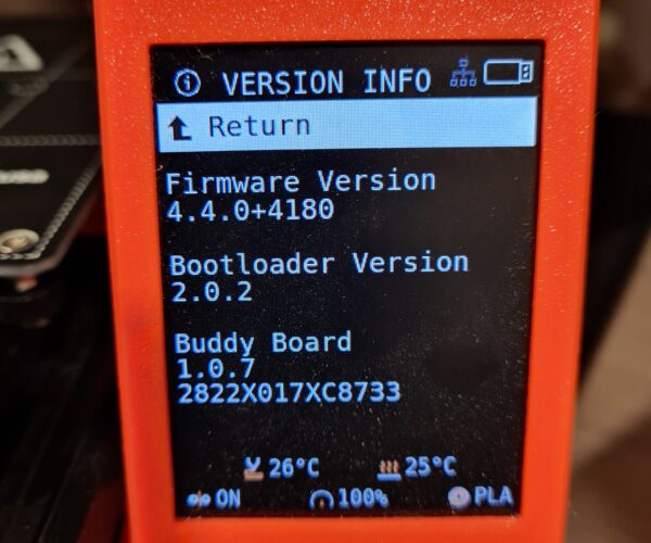

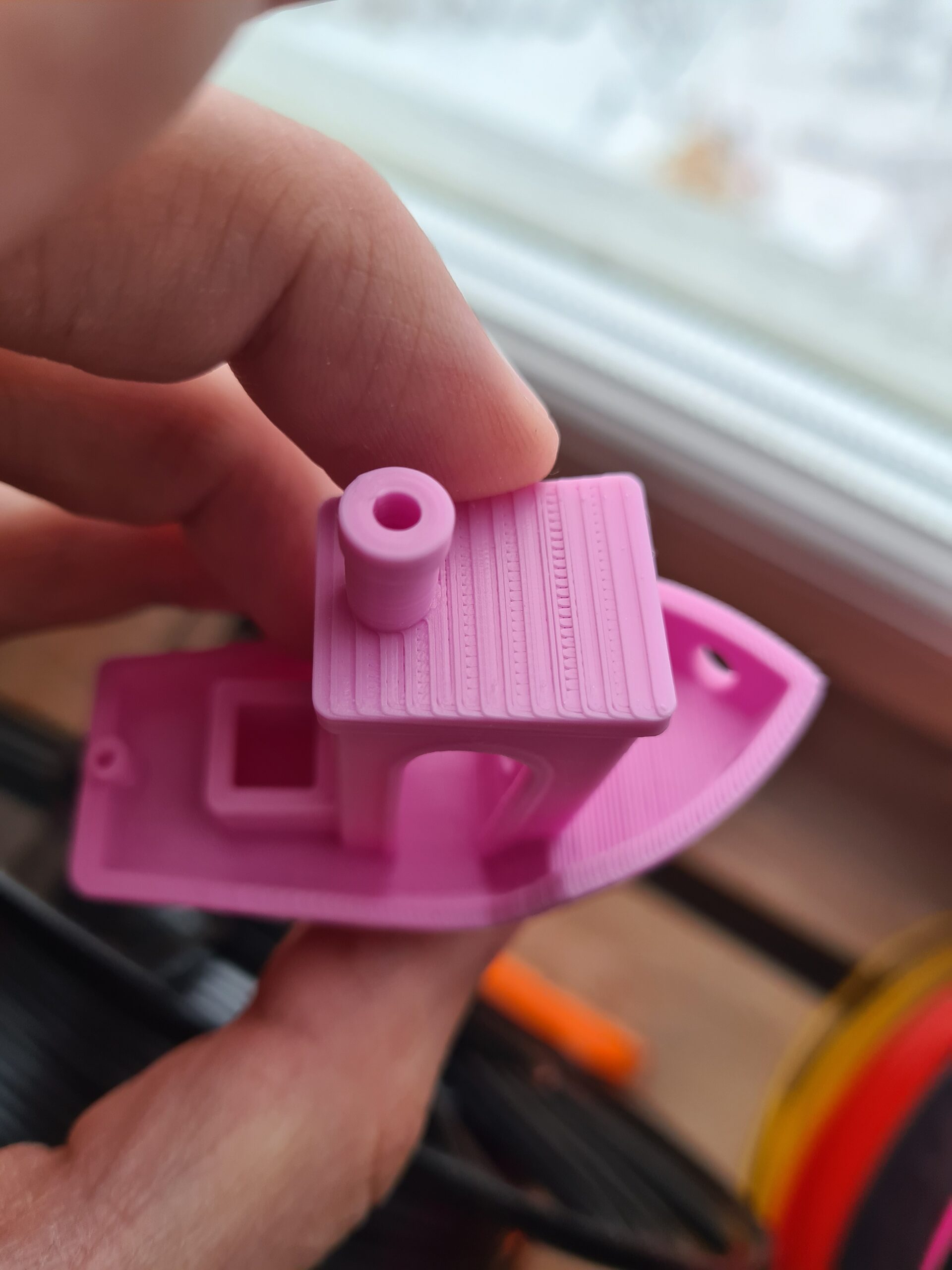

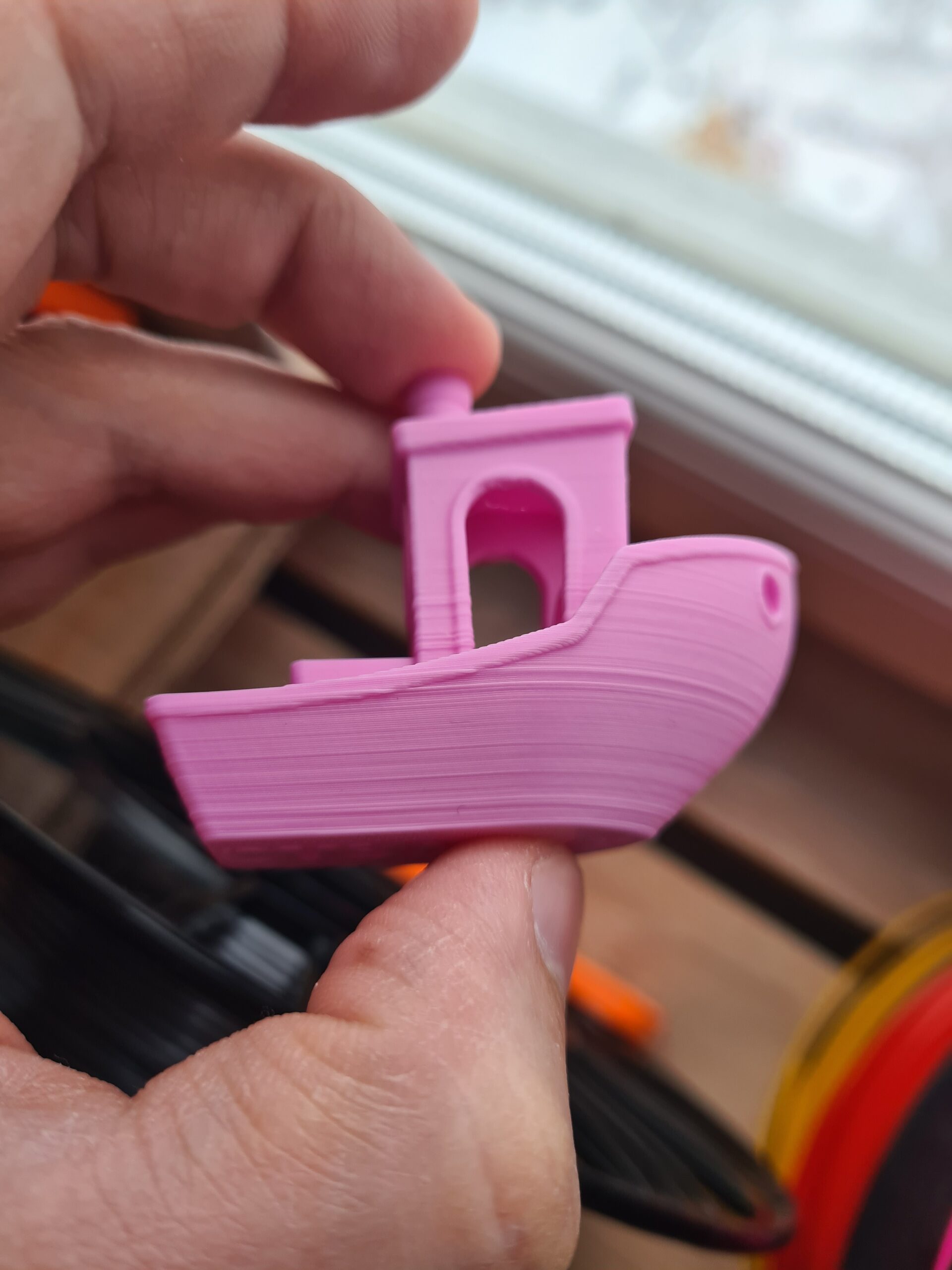

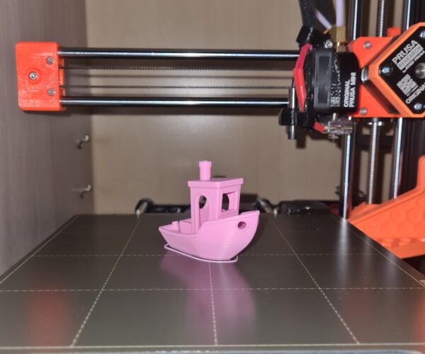

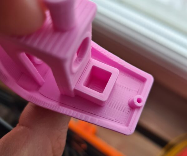

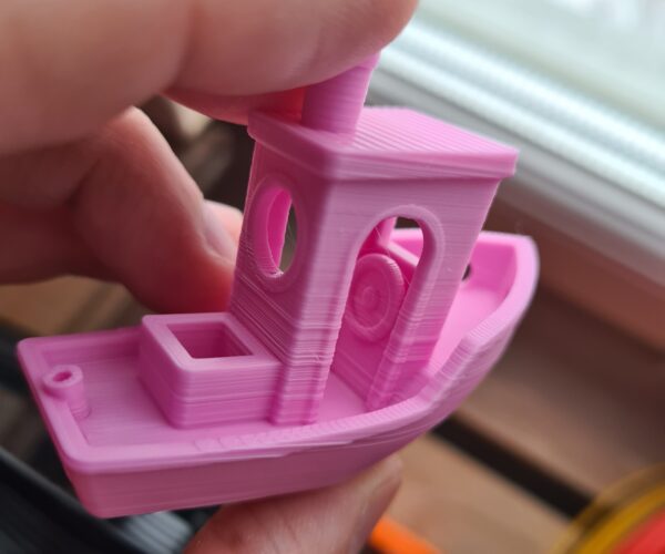

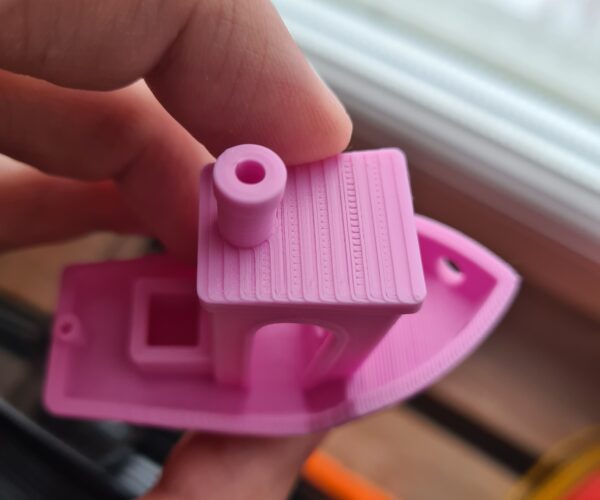

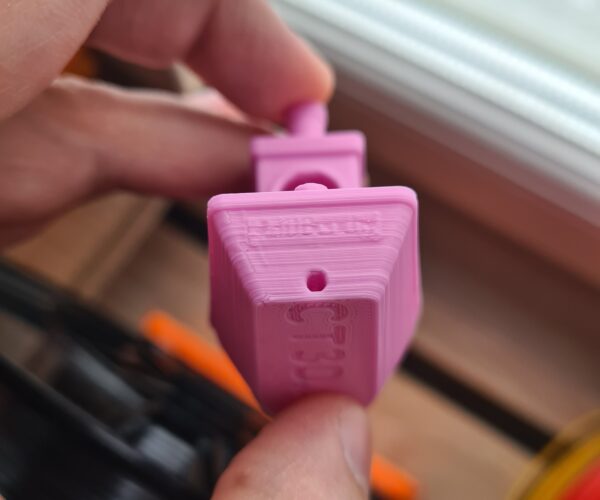

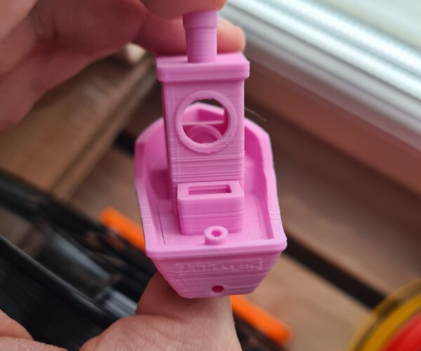

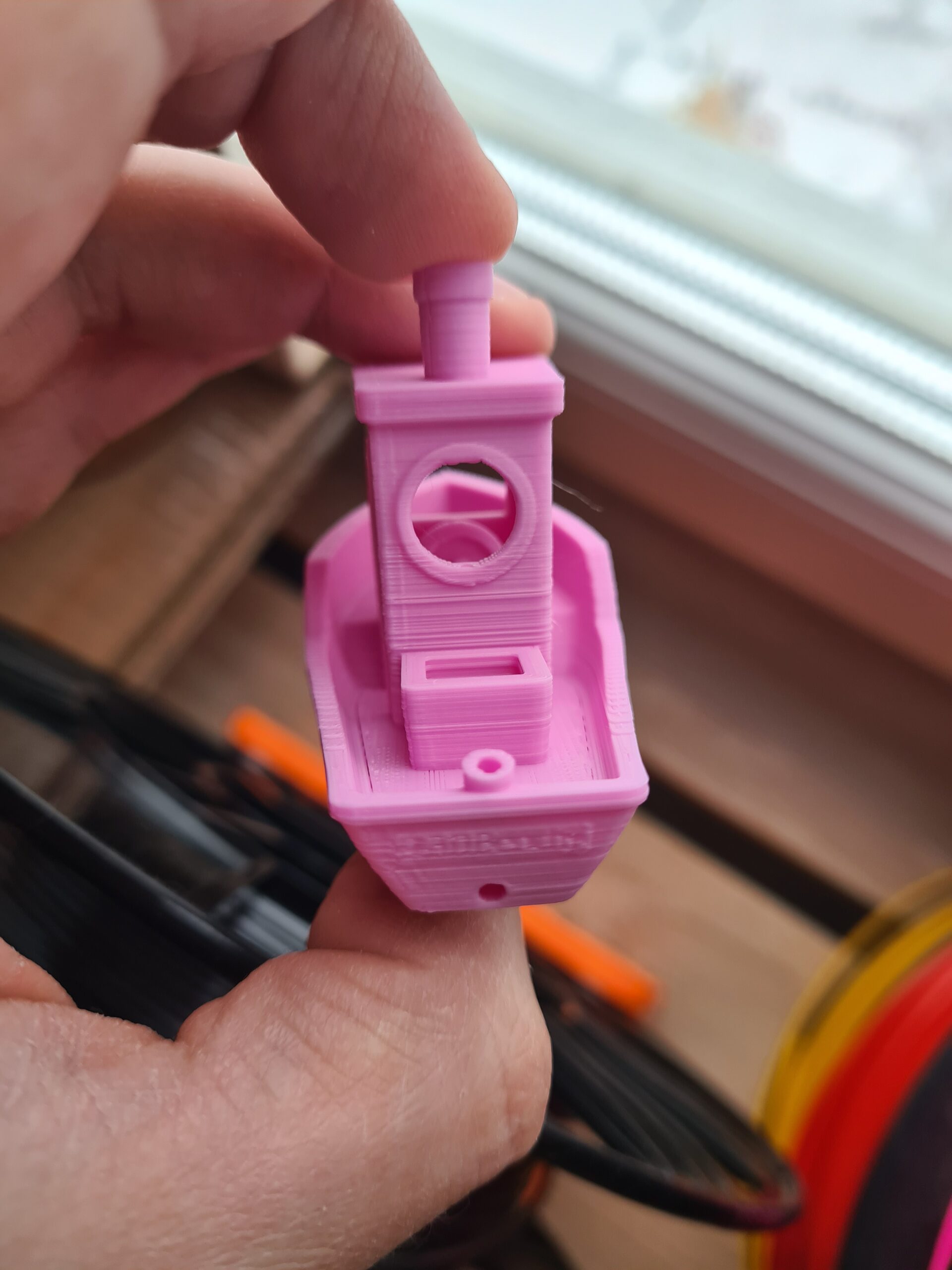

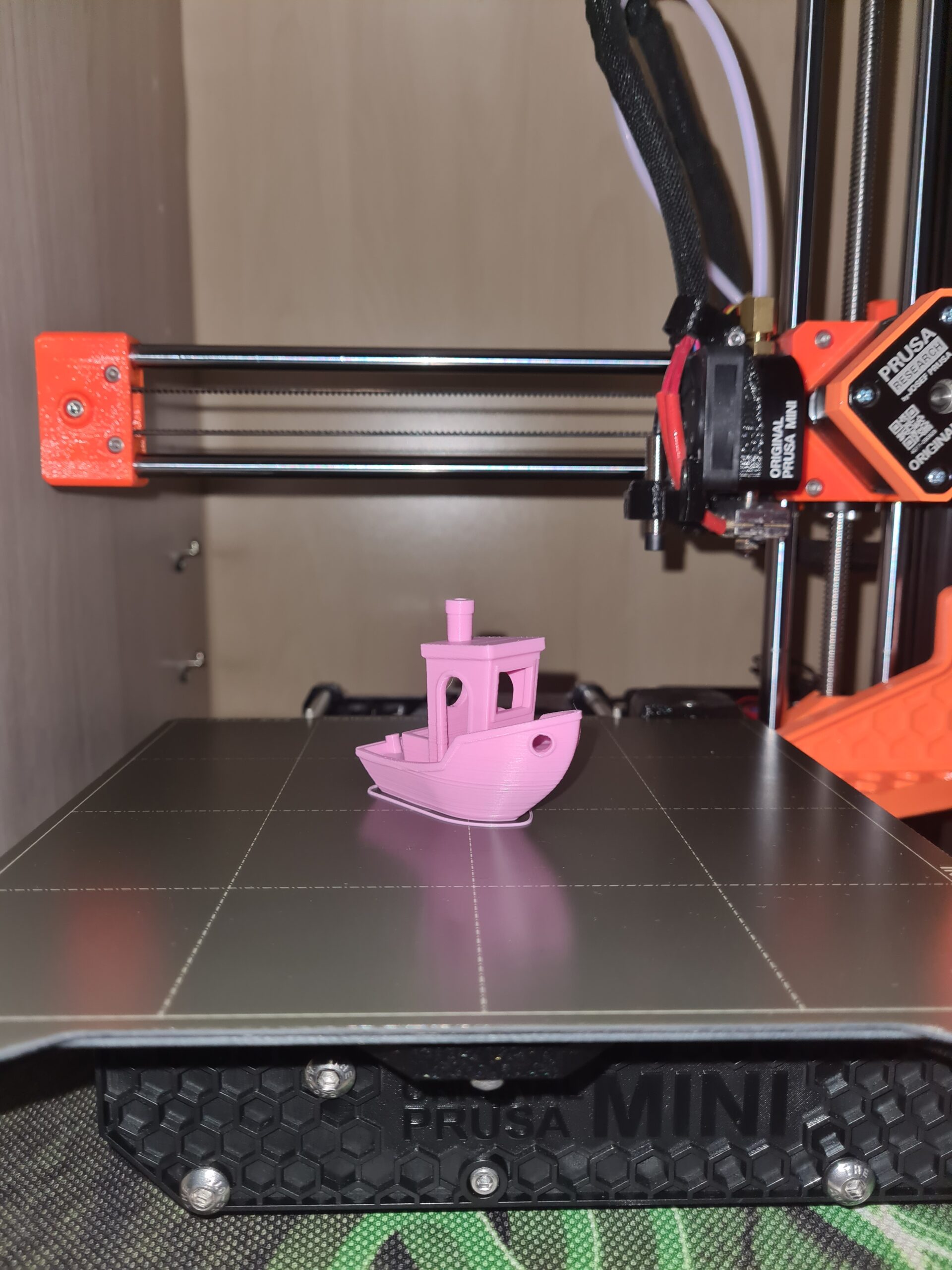

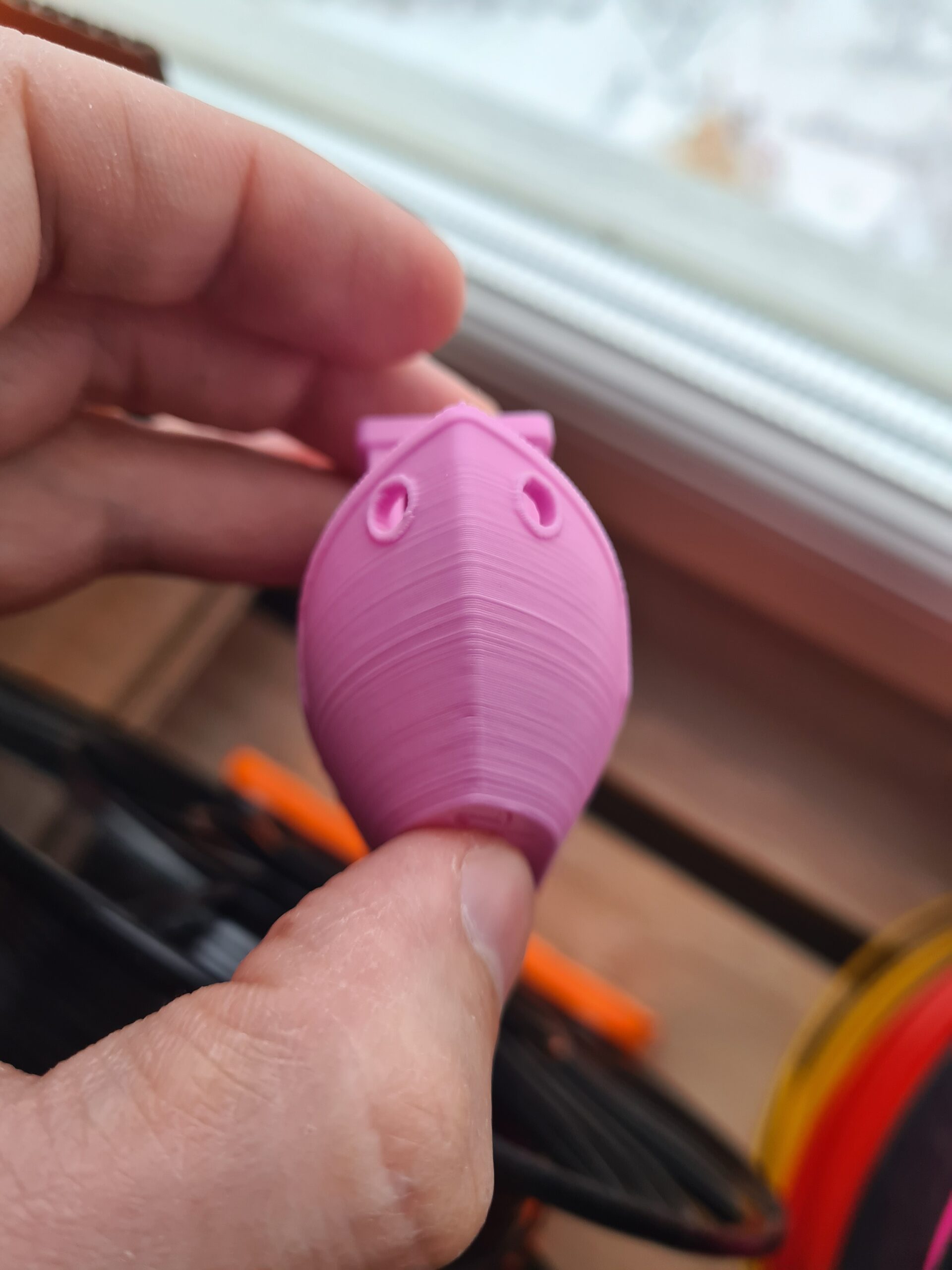

hello community!I can't find the reason.I have 2 prusa mini+assembled the same way.on one, the result is excellent, and on the second, these are such terrible layers.I tried to tighten and loosen the straps.I tried to change the plastic.I tried updating the firmware.started testing.checked the angles of the X and Y axisI can't think of anything else to check to try to find a solution to the quality problem.

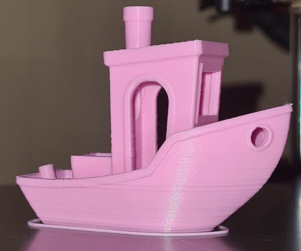

problem was solved with help Assembled hotend MINI/+   ( https://www.prusa3d.com/product/assembled-hotend-mini/)
I just swapped out a brand new assembled hotend that came with a printer that wasn't in use. on a new one bought in reserve. I understand I got a factory marriage.
