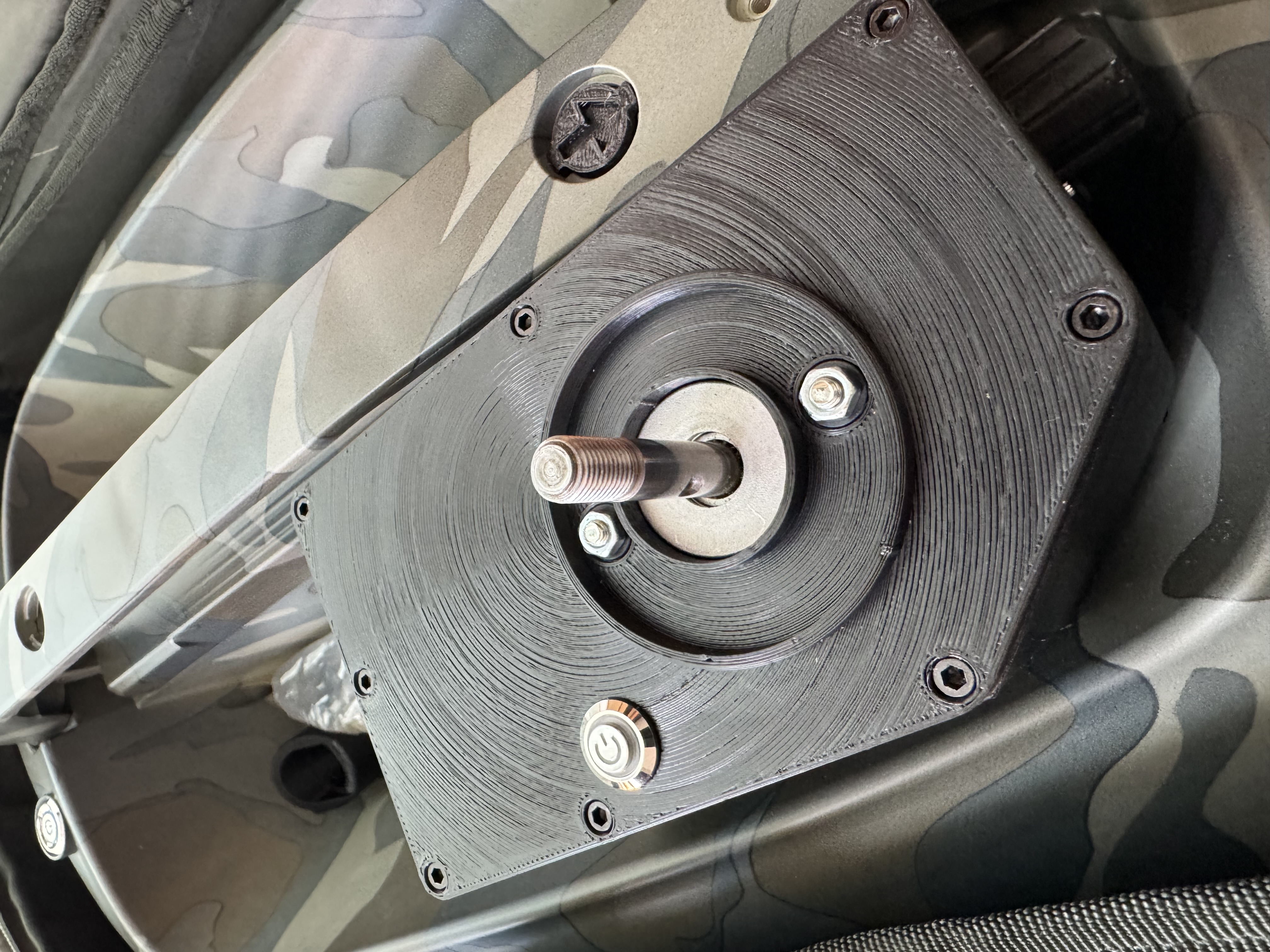

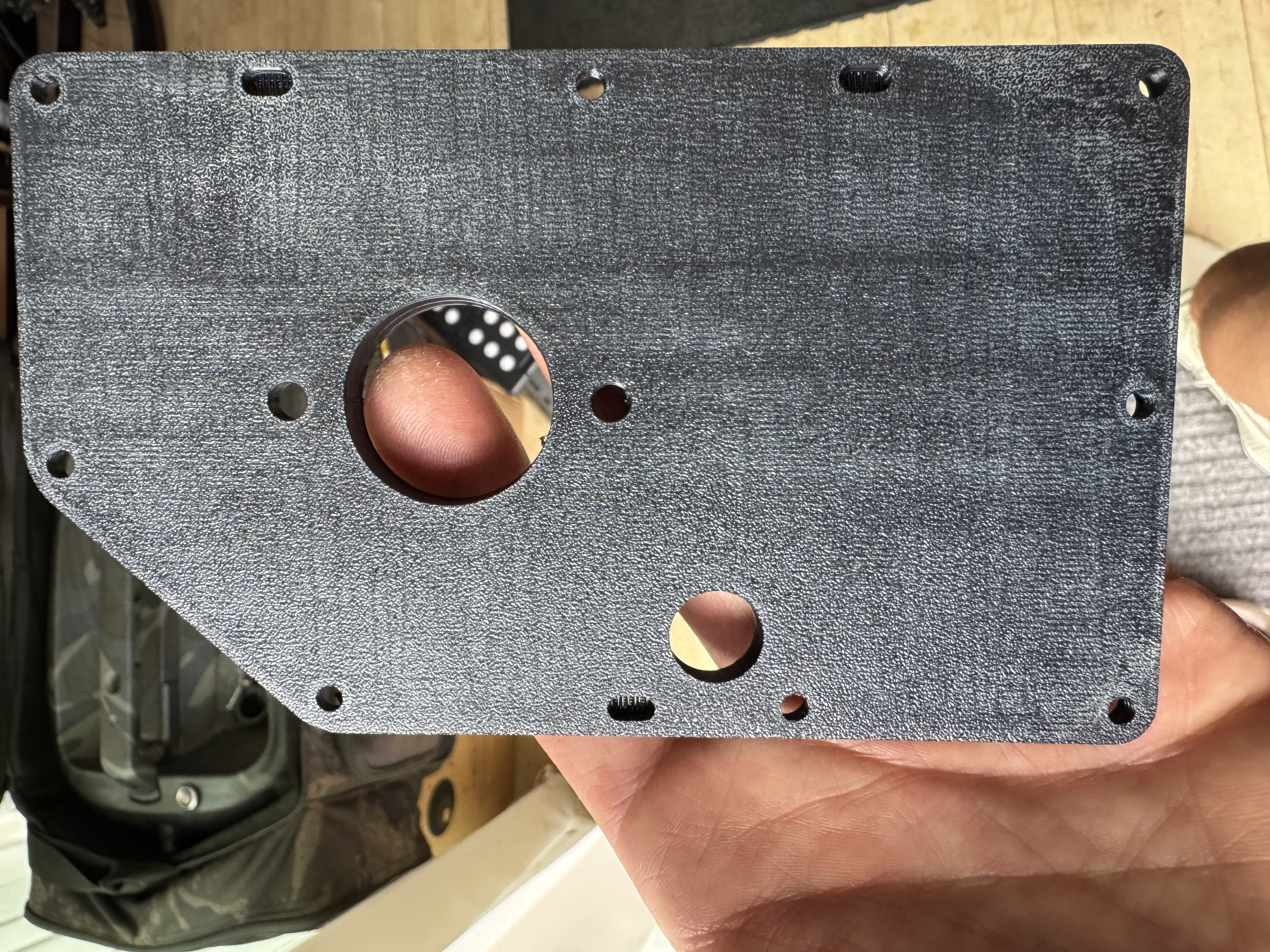

Figured out my adhesion problems and using some 3Dlac it’s secured to the bed without any warp
now my issue is to get a smooth top
I’ve tried different patterns but haven’t had consistency to reproduce a smooth top

Bottom

Top which I’m having issues with
