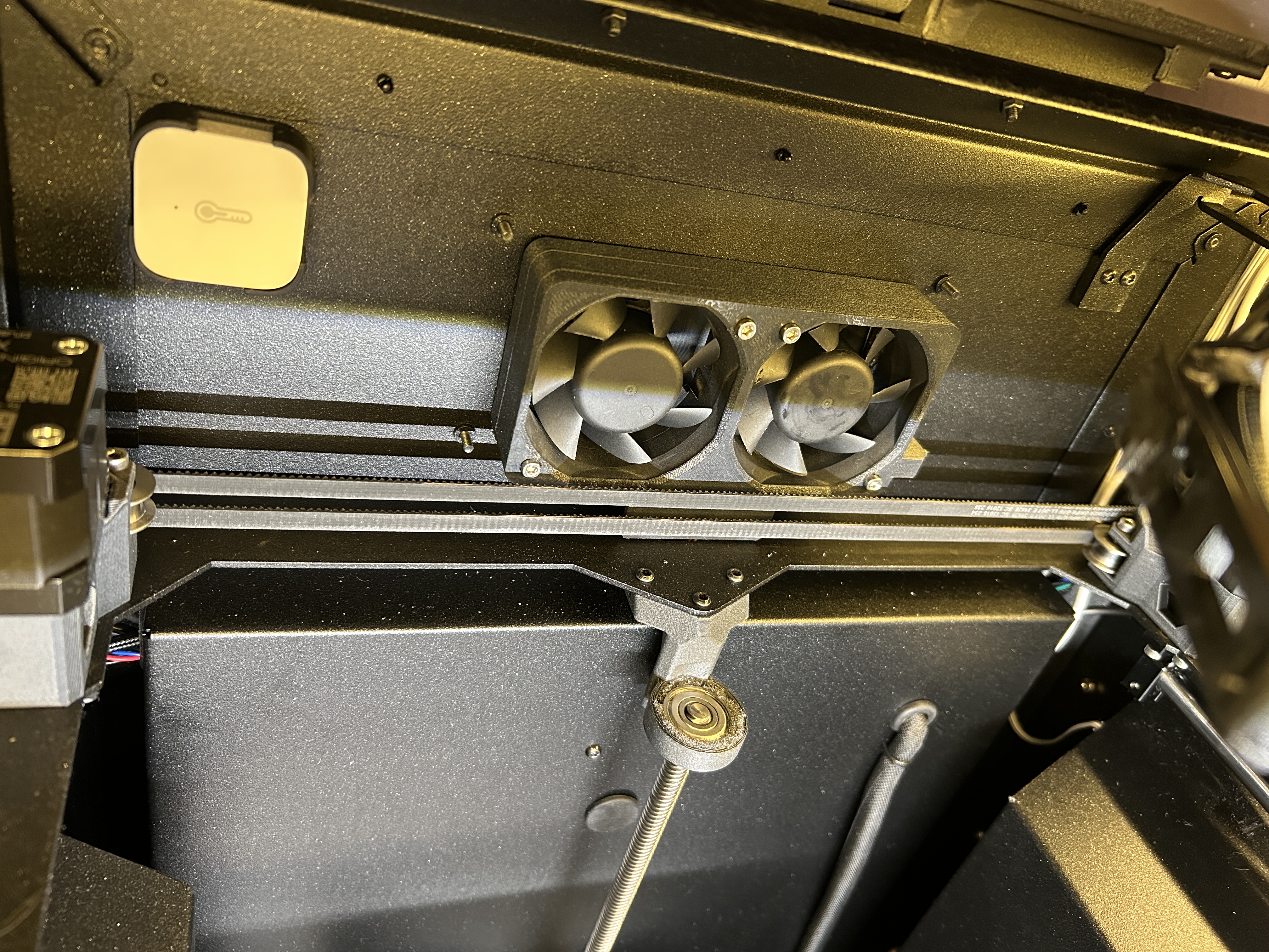

Hi, i find the chamber fans very loud.. (reduced them to max 30% in the settings, but for PLA that sometimes is not enough)
So did anybody test an other solutiom or has an idea.
(maybe for the filtration one needs a lot of pressure, but with not filtration, shouldn't something "weaker" be sufficient?)

The filtration kit disables the chamber fans, since they don't help at all, as soon as there's a need for static pressure (like pushing through a HEPA filter).
For that, you need radial fans, like the one that comes with the filtration kit.
The fans in the Core One aren't the most silent, but they aren't bad either. The issue when optimising is, that it's not a round opening in the back, so a 140 mm Noctua or so wouldn't work well and smaller fans are always less efficient.
The standard fans also aren't decoupled via rubber pins and the grid in the back and in front of the fans is blocking quite a lot of air.
Another issue: molex plugs.
Different fans would require to either cut the standard cables and the cables of the new fans, then soldering - or creating your own adapter cables:
Buy two standard 4-pin fans extension cables and a cable with the correct molex plugs on both ends, then cut them all and solder the molex plug on the 4-pin extension socket.
I thought about taking the standard fans out, cutting the grid in the back completely open and printing a sealed/dampened duct with a decoupled 140 mm Noctua industrial fan in the back.
Which brings me to the next issue: good luck finding a 24V, max. 0.5A, 4-pin PWM fan, that's actually better, than the standard fans.
The Noctua industrial fan was the only one I could find and it costs about 50€.
Overall, I just got used to the noise for now...

Sunon are another well regarded brand who make a huge number of fans, with their "MAGLev" bearings being their quiet variant. It looks like the MF60252V1-10000-A99 (on Mouser as MF60252V1-1000U-A99) would fit the bill - 60x60x25mm 24v 0.5A 4500 RPM (my stock fans are 4300RPM at 40%) BUT that's only 2 pin. As above we need a 4 pin variant, which they do also offer (S99 suffix) but only when made to order in bulk. Sometimes you can find Sunon fans on AliExpress that have been customised for a specific company and are leftovers/rejects because the vendor code is something other than 10000, but I couldn't find an S99 version of this fan anywhere. For reference here's a PDF of all Sunon fans and variants available. However there is a setting in the printer's menu to disable fan checks, which I assume removes the need for a tachometer wire. And I guess you don't need a PWM wire if the fan's max speed matches what you want already. So the 2 wire MF60252V1-1000U-A99 might actually work, but no guarantee it would be any quieter in practice.
I noticed that shutting the top vent muffles some of the noise. Can't do that with PLA/PETG, but I wonder if there's another way we can muffle the noise. I printed this automatic vents mod to hopefully "redirect" some of the sound backwards and muffle it. Inconclusive results but maybe some other kind of baffle could be designed with foam inside to dampen the sound. It'll only make a small difference though.
Equally I imagine the sound coming from the back could also be muffled. I'm wondering if this huge DIY filter mod would dampen the sound, while having such a large surface area filter to not require higher static pressure fans.
Does anyone have the official Advanced Filtration add-on to comment on whether it's louder or quieter than the built in fans?

there's room for a thin TPU shim behind the fans and O rings on the bolt heads. That helps noise a lot.

For me I solved it this way 😁
https://www.printables.com/model/1407730-silent-chamber-cooling-using-the-advanced-filtrati
I used only the filtration fan without the filter because  seldom print asa ore similar

Hi, thanks for sharing your experience. Since the chamber fans are not needed anymore, did you end up removing them to have less obstacles in the airflow?

In my case, I left them on because they shouldn't impede airflow. Also, though the chamber thermistor sticks out into the chamber slightly and is held in place by the fan grill. If you remove the fans then would need to create/print a replacement bracket for it.

I removed the original grid and made a cleaner cover, also with a place for the thermistor
