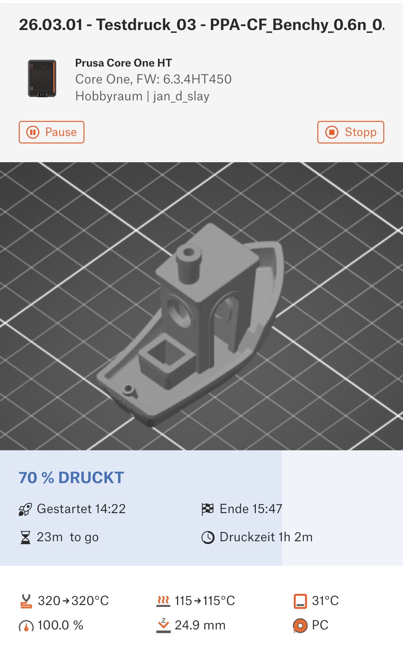

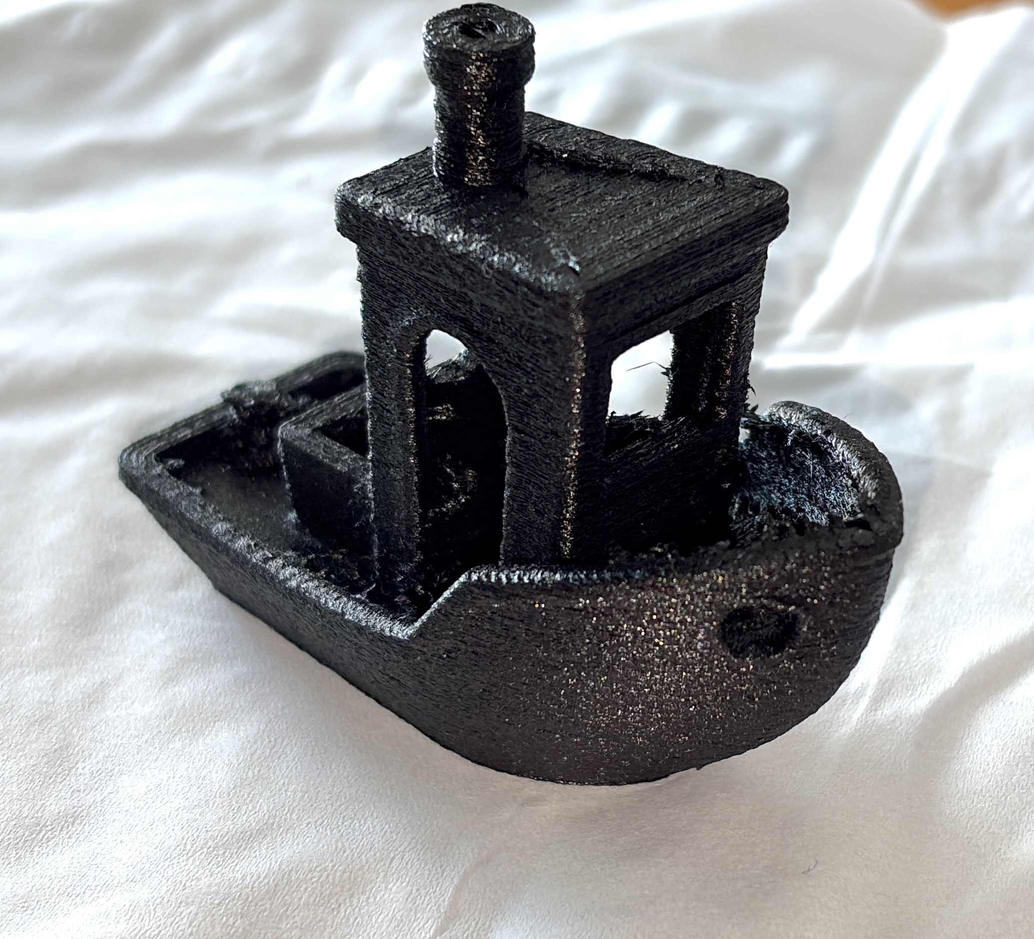

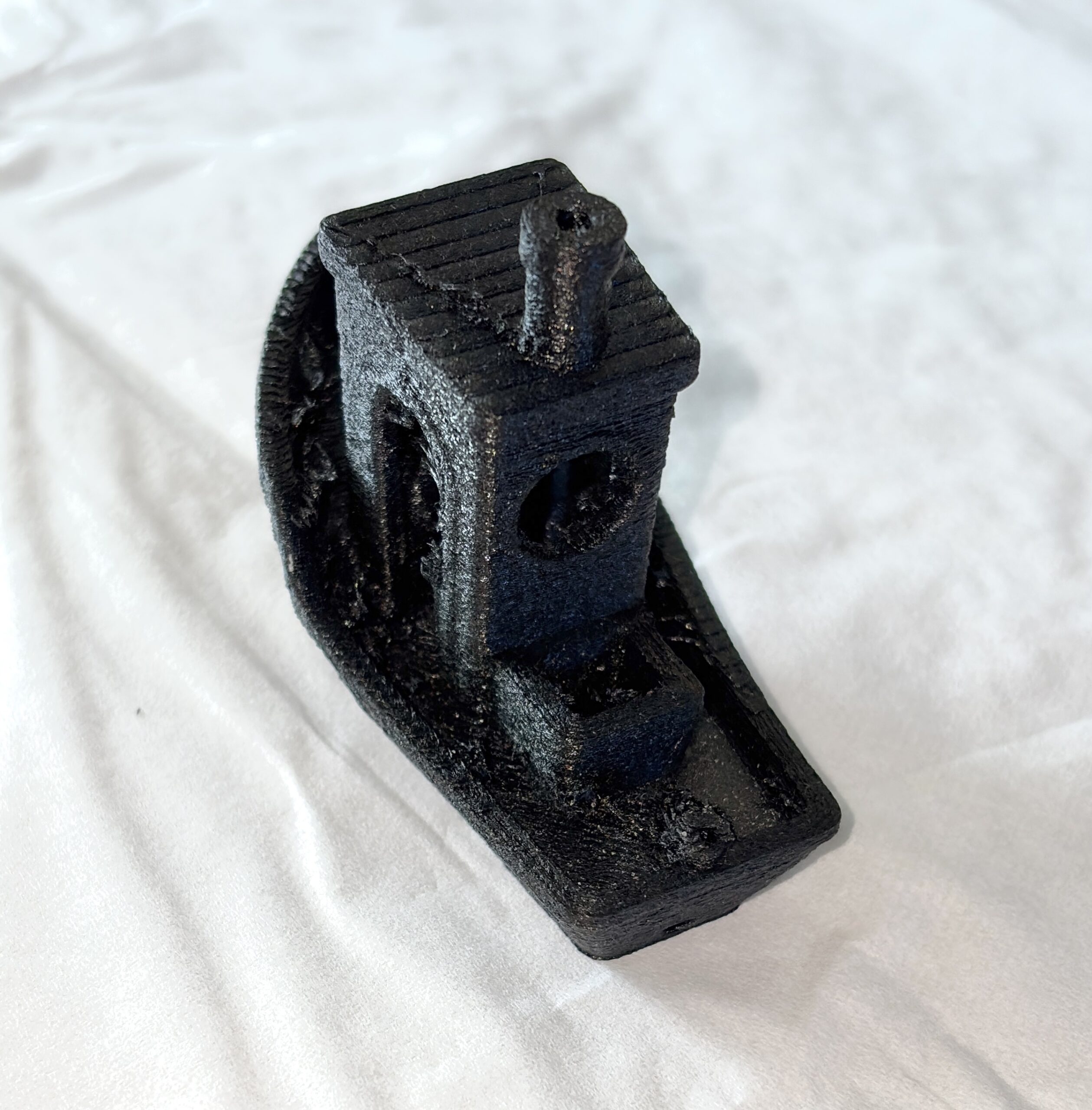

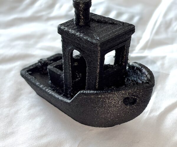

Hello,
The idler, with only one roller, works perfectly. After the conversion, I clamped in some leftover undried PPA-CF and printed a Benchy.
320 degrees without any problems from start to finish, even the first roof lines of the boat.
Untidy and a lot of ozzing, but once again a new before-and-after comparison.
Heat protection for the heating block is coming now, finally!
