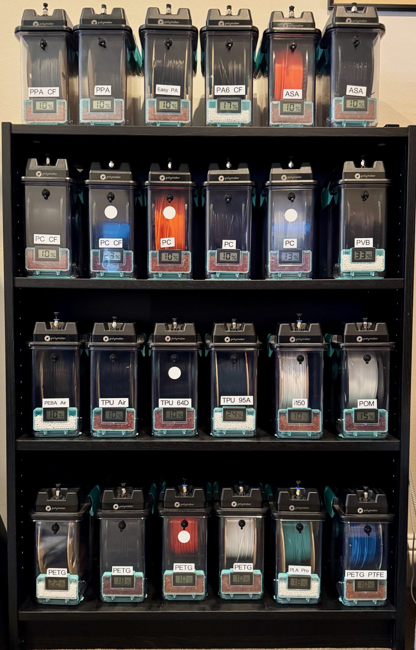

Hey folks,
after years with Ultimaker, I jumped to Core One; built the kit, prints fine. Now I'm slowly wading through different mods on printables and came across the Side door for filament cover.
It seems rather reasonable, but it's not much of a drybox with the gaping holes in the side panel.
I'm wondering -- how terrible of an idea would it be to seal the seams with some silicone sealant (say, black Sikaflex-522).
But maybe I'm not seeing some obvious problem with this. So, how bad of an idea is it?

Using my similar https://www.printables.com/model/1556359-core-one-side-dry-box-cover I regularly get 15% humidity, so I did not try to further seal it. The enclosure fans do move some air through the dry box area.
Regards,
Mark

Whether it is useful or not kind of depends on your workflow. I frequently replace out filaments depending on my projects but it's enough that portable and easily detachable dry boxes work best for me. Also, especially with Nylon, I print it from the drier while it's drying. So a semi-permanent drybox would get in the way.
Posted : 27/02/2026 3:43 pm
RE: Filament drybox on the right side
Here is my setup. I just grab a box, set it next to the printer, attach it to the Bowden input and print from the box
Posted : 28/02/2026 1:00 am
Posted by: @hyiger
OK, this is beautiful. Inspiring, even. Thanks. 🙂
