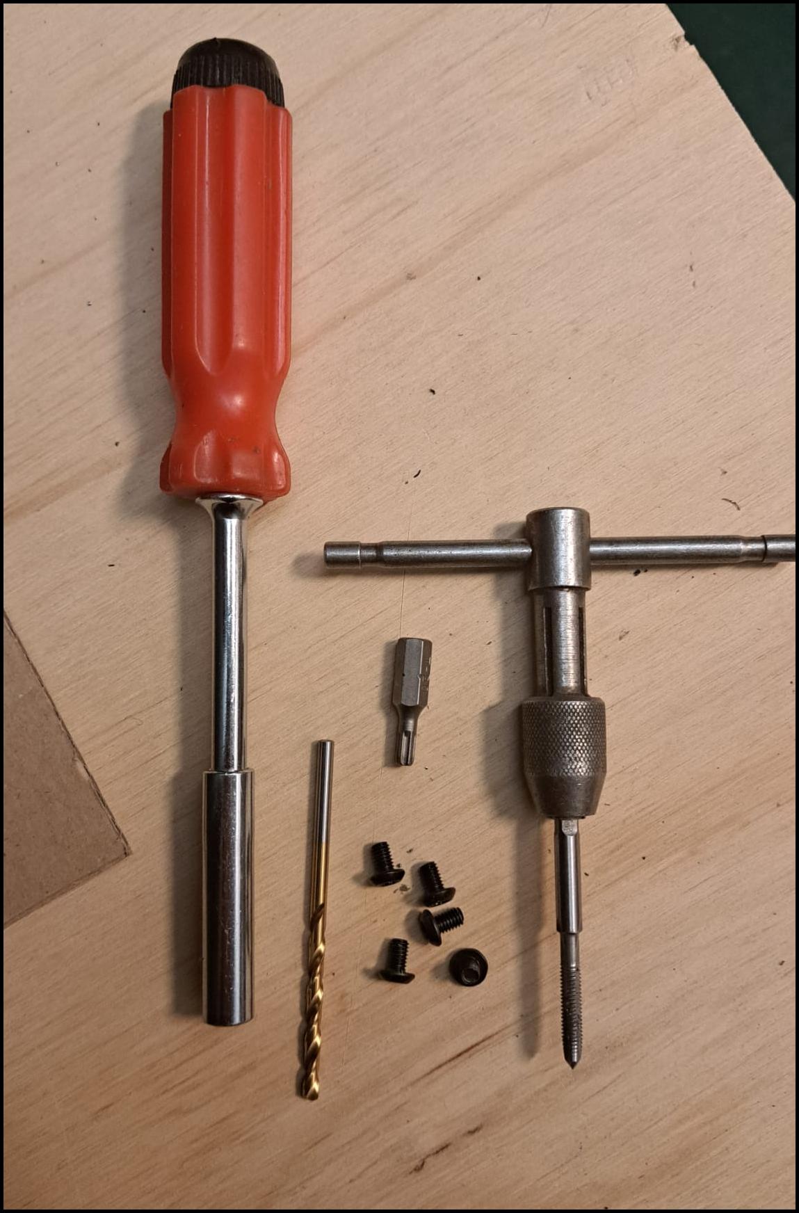

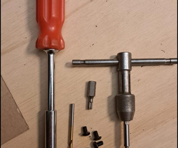

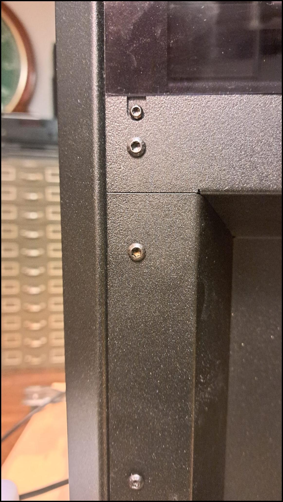

Drill and Tap for M4-07 Torx screw
I quickly decided that the rivets made little sense. What I did was drill out all the side connector holes to tap for an M4-07 Torx screw.
This has proved very useful as I had been dealing with the upgrade to the core one + as well as the rebooting issue due to a lack of a effective ground from the x and y axis to the painted frame.
It's had to understand why Prusa went for the silly rivets when a m3 torx would have been a no brainer.  The m4 is a bit bigger as a result of the existing holes being to big for an M3.  But as you can see from the photos the m4's don't look that out of place.
You can order them here:
https://www.amazon.com/dp/B0FY2TFD7H?ref=ppx_yo2ov_dt_b_fed_asin_title&th=1
You can get the Tap and correct drill here:
https://www.amazon.com/uxcell-Spiral-Titanium-Machine-Threading/dp/B09TYT39LY/ref=sr_1_3?adgrpid=186566558379&dib=eyJ2IjoiMSJ9.82oh4PY909h9Y6ArM94oUHLrIWXfVDvejWlqFT0Ay7kDsRHxS_LF3XYMFNhLC6NS8aVxh51EsnfF7jHLlKWzsFS8EUMGf7OLzdZnOxLU41ktB-faY9ff4PY8HtFHKAz4PDdm2JW2uxpFfSdBksbWQ3XJ7JECwZ6a293uj3yL7H-rxWAcUDYaVgew0zpzfY21uUgbcwO0GBuMrjKlSSpB7X_-qwa0dFKJA2Plgxsm0tA.XrF8jVJTsO56WoMoLkQX_Zi26vdT9p1Xu8c3784RDIs&dib_tag=se&hvadid=779546370712&hvdev=c&hvexpln=0&hvlocphy=9060351&hvnetw=g&hvocijid=16207660410231928228--&hvqmt=b&hvrand=16207660410231928228&hvtargid=kwd-2408723580634&hydadcr=953_1015322473_14577&keywords=m4%2Bx%2B07%2Bdrill%2Btap&mcid=729f2564d5b8391fafa8eea5aac1c5ae&qid=1765393912&sr=8-3&th=1
Posted : 10/12/2025 7:16 pm

This has worked out great for me as I have experienced many Core One issues that resulted in having to remove and replace both side covers many times.   One point ... I never did anything to the top plastic cover as it seems quite ok to just let it sit there by gravity.
One person had commented that he would never trust screws holding in thin sheet metal.  The entire metal frame of the Prusa Core one is thin sheet metal that is held together by  screws and tapped holes .
Posted : 08/04/2026 5:08 pm

RE: Any alternative for rivets?
Posted by: @dr-skycat
That's not correct. At least in my Core One, Prusa has not tapped any threads just into the thin sheet metal frame profiles. There are press-fitted metal inserts (or rings welded to the back?) which carry the threads.
Even in cheap enclosures, the worst I have seen were holes that had been punched out leaving a slight collar, which provided enough depth for a few turns of the thread. But threading an M3 or M4 screw into a plain circular hole in sheet metal is not a good solution.
As Conrad mentioned, the Nylon rivets are fine. Either use the tool suggested above, or just push them out from the inside with your fingers. (Center pin first, then the outer collar.) I have not ordered any extras, since I have not damaged one yet.
Posted : 08/04/2026 7:10 pm
