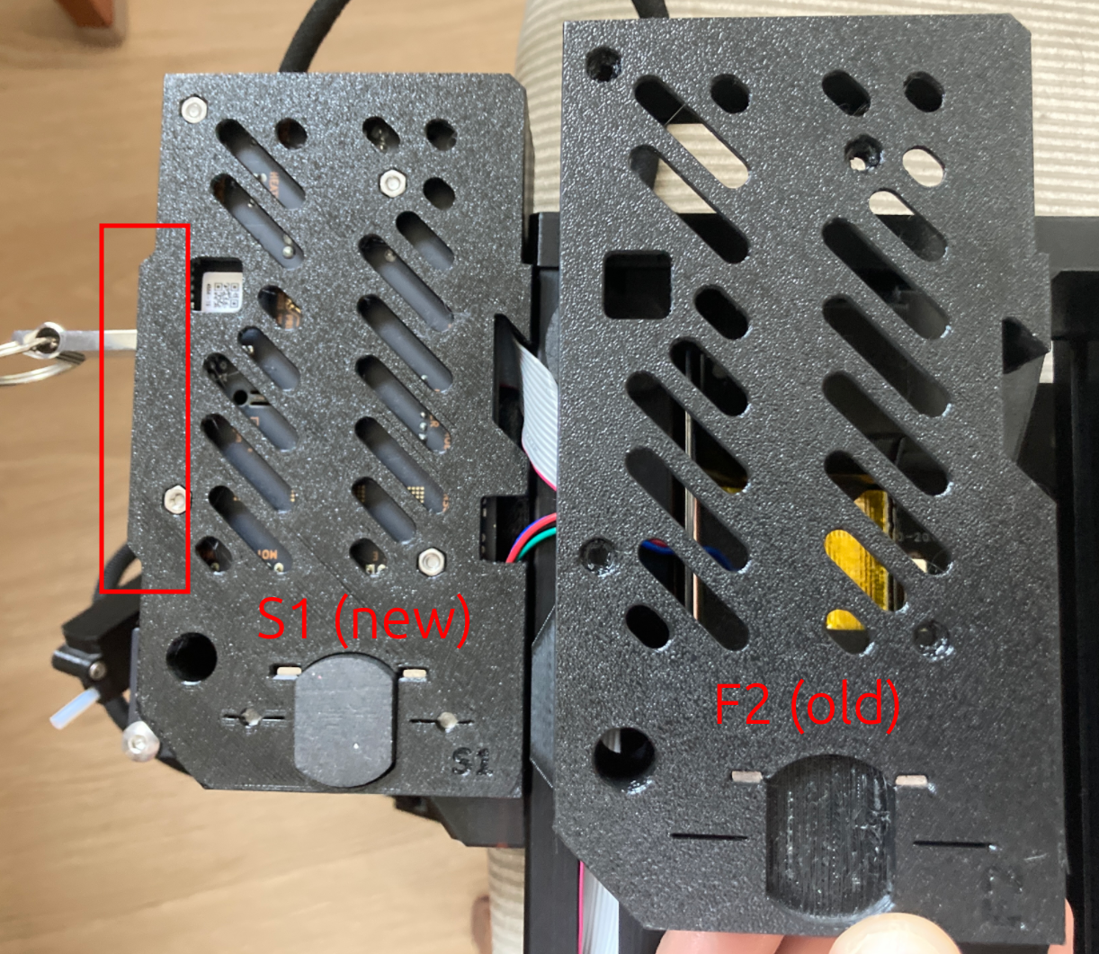

I found a compatibility issue with the Prusa MINI base mod.
Originally, I had the Z-axis base version F2, and the mod fit correctly there. However, my Buddy board cover cracked, so I printed the S1 version from Printables as a replacement.
After replacing it, I found that the mod no longer fits into the MINI base RR leg. The Buddy board box / cover on the S1 version is a few millimeters wider, so it does not fit properly.
So it seems this user mod is compatible with Z-axis base version F2, but not with version S1.
I’m posting this in case someone runs into the same problem, and maybe the compatibility info could be updated.
