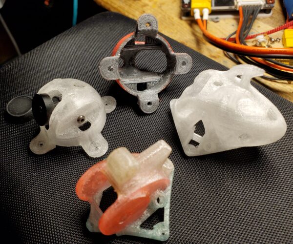

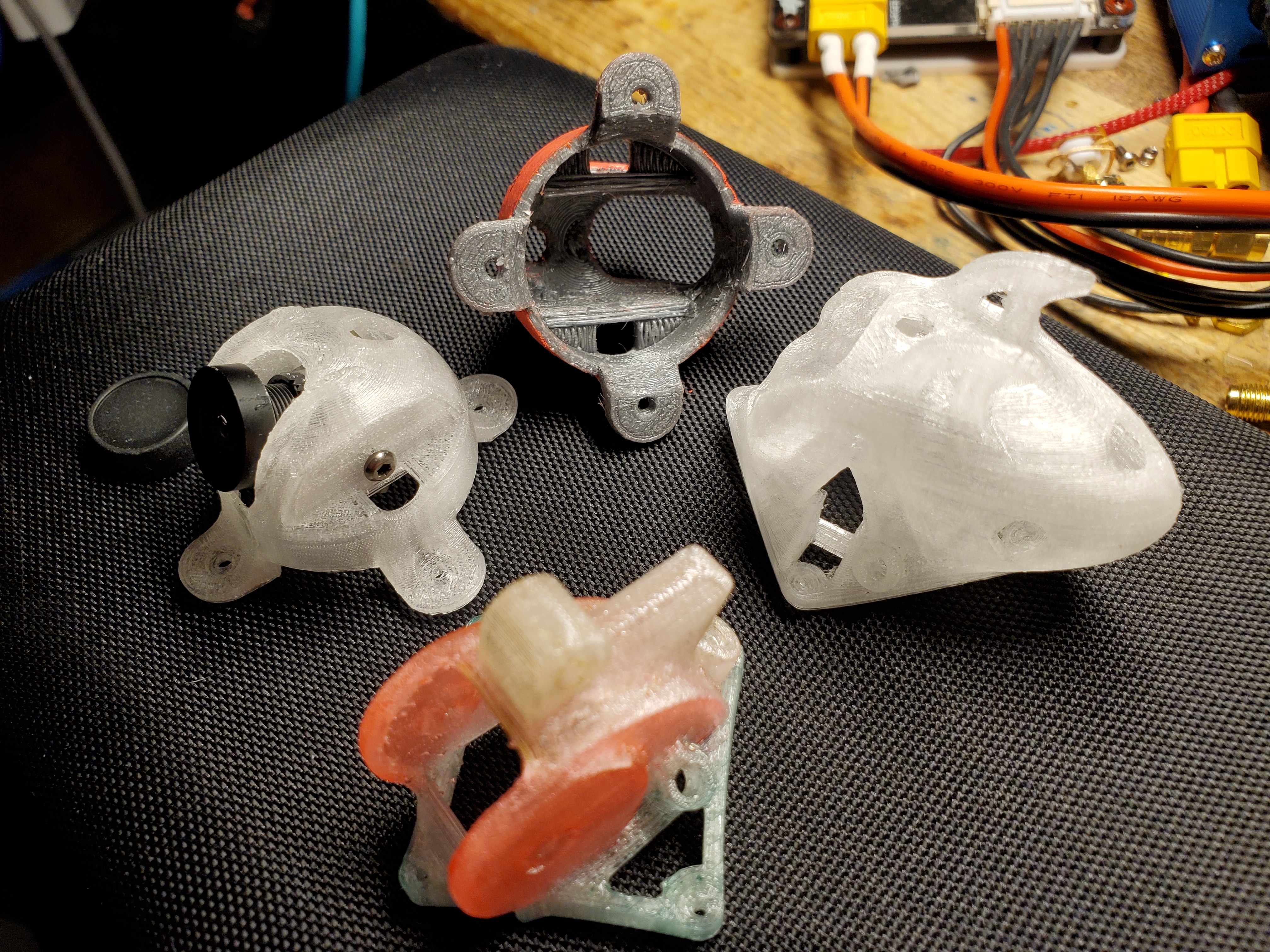

So, I'd be happy to share with you, any details of my setup. I came back here with the primary objective of sharing some photos of the print(s) I referred to previously, specifically TPU prints with overhang that were printed without support material. I will post these photos here, and then return with the information you requested. Roughly, I used stock Prusa TPU profiles, with minimal adjustments to heat bed temp, brim, and first layer height. Stand by for exact details.
For now, here are some TPU prints from my Mini. They have been cleaned up. (I will soon post some fresh prints, hot off the bed with no cleanup, in order to give the most honest representation of the quality.) Three of the pictured prints are made from Filamentum 98A, and the fourth is Sainsmart TPU (which also claims 98A, but is definitely softer than Filamentum 98A.) All were printed without the use of support material, and all feature various degrees of overhang in their design. All were printed in their upright orientations. Most of the photos are various angles of the same single print, which is my attempt to represent the average quality, and general characteristics of prints coming off my Prusa Mini. Silver grey print is Sainsmart TPU, while the clear/natural is Filamentum 98A.

*How to adjust the Prusa Mini stock extruder idler for use with FLEX [TPU] filaments: Loosen idler screw all the way.
I achieved this by backing out the screw until it fell out, onto the desk, rolled to the edge, and fell off onto the floor. I then picked it up, put it back in, and gave it two or three turns so it wouldn't rattle out, making sure I didn't turn it so far as to feel any tension.
I have the filament sensor, and so followed the advice for loading flexible filament into the Mini, offered in this blog post https://bit.ly/3nX9yv7, where the author has managed to successfully print Ninjaflex (apparently a very soft TPU,) with the Prusa Mini.
Below this point is a summary (my personal notes are in italics,) of the actionable information found in this blog post on the topic of printing FLEX materials with Prusa printers, including the Mini: https://bit.ly/3fAYh0t
If your printer is satisfactorily printing with PLA, here is, presumably, everything one must know/do, in order to successfully print TPU with a stock Prusa Mini:
.5) Changing filament from black PLA, to natural (clear) TPU, I performed 4 or 5 cold pulls (my first attempts at this procedure.) I suspect two, in this particular case, would have been sufficient, as each additional cold pull yielded no further bits of the black PLA that was previously loaded.
1) Loosen your idler as much as possible before you start loading the filament/printing.  -See above.
2) Spread a thin layer of glue on your print surface (regular paper glue stick should work fine). This step is necessary when using the smooth PEI sheet. You don’t need to use glue on powder coated sheets.  -Thankfully I entered the field of 3d printing post the era where exotic, or counter intuitive substances like, glue stick, Aqua Net (hair spray,) rhinoceros saliva, and common ear wax (no lint,) were used to dynamically promote bed adhesion, and as release material, at the same time!
3) You have to print very slowly, typical safe speed is 20mm/s.  -I simply relied on the tuned profiles available in PrusaSlicer. I have these set to automatically update, so I'm always wielding the latest insights/settings gleaned from Prusa's tireless Research.
4) Keep your filament dry.  -I live in the desert. I suggest you do the same.
For better looking prints:
5) We suggest setting a less dense infill if you want your object to be more flexible. However, you should add more top solid layers (Print settings – Layers and perimeters – Horizontal shells).  -Never touched this. Relied on profile defaults thus far.
6) Set retractions as low as possible. If you struggle to find an optimal value, try to turn them off completely, then raise them little by little.  -I figured this would be built into the FLEX profiles. It is not. I've read multiple sources that suggest turning retractions off entirely. I will play with this on my next print, even though I find prints using the default settings to be acceptable. See image at the end of this post for an example of the stringing.
7) Raise the recommended hotend temperature to 5°C higher, and keep the print fan turned off.  -I have not done this, instead relying on the default profile settings. See the reslutant prints in my previous post, and at the end of this post.
8) If you need to print supports, set the gap between the layers in Z-axis to at least 0,3mm (in Slicer PE under Print settings – Support material – Contact Z distance).  -Since I whined about this, I guess I should try making this adjustment, if it isn't the profile default.
End summary-

Post Lastly: Here is a star spinner fresh of the heat bed, untouched.
