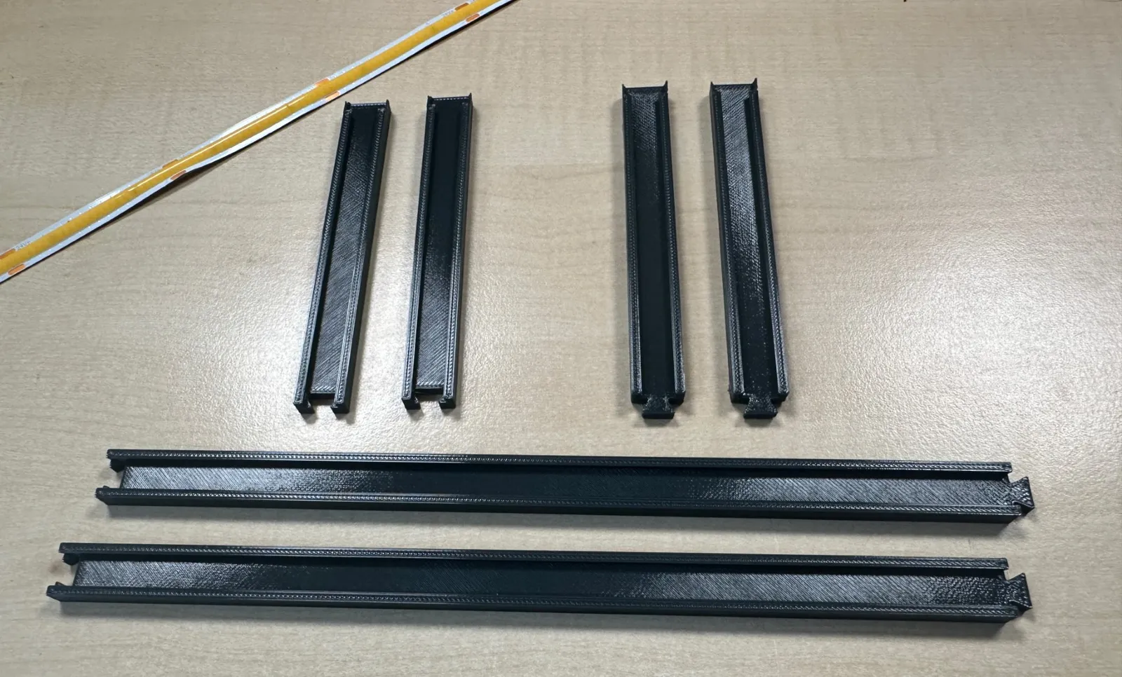

I did it a little different because I don't like anything sticking out of the front of my printer. If I need some light directly on the nozzle then I have an extra strong LED next to the camera controlled by software. I used 24V LED strip and a 16x9.3mm aluminium profile to get rid of heat, a plastic profile is generally a bad idea because a bright LEDs get a bit hot after some time. BTW, the whole thing requires a minimum of plastic, it is powered directly from the printer, fits mk3s/+ and mk4 frame, also fits with mmu2s unit. Here are the files you can use: https://www.printables.com/pl/model/619904-mk3s-mk4-led-light/files

I actually solved the problem with an almost metal-free solution: https://www.printables.com/model/619620-magnetic-modular-led-strip-for-the-prusa-enclosure
I had the lights running for 20 hours straight since yesterday, and they did not become warm at all. At least with the type of strip I used, there really are no thermal problems, I'd dare to say.
