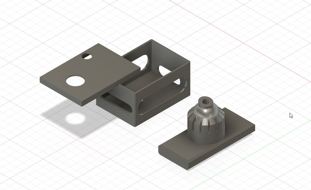

jerzeek
(@jerzeek)
RE: ESP32 Cam Support
I made this:
It is for the Prusa Mini, But I am looking into ways to develop it for the MK4, but I don't have an MK4.
Let me know if you want one, or if I should document it somewhere
