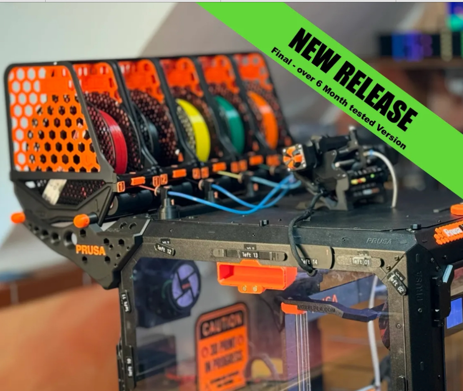

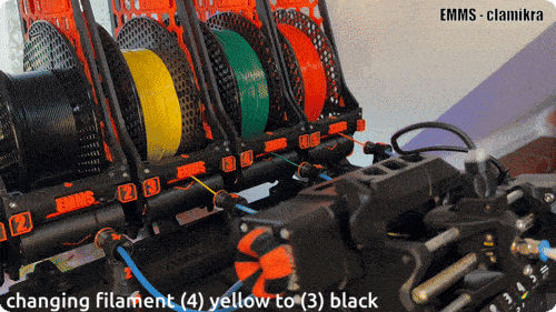

RE: Enclosure plus MMU3?
https://www.printables.com/model/914116-external-mmu-mounting-system-emms-for-original-pru
I made a system with autorewind spools for Original Prusa enclosure, MK4(s) and mmu3. Spools are placed without any modification on the carriers outside the OPE and all components are easily accessible!
runs without issues for almost a year now.
download and instruction are on printables for free (see link above).
