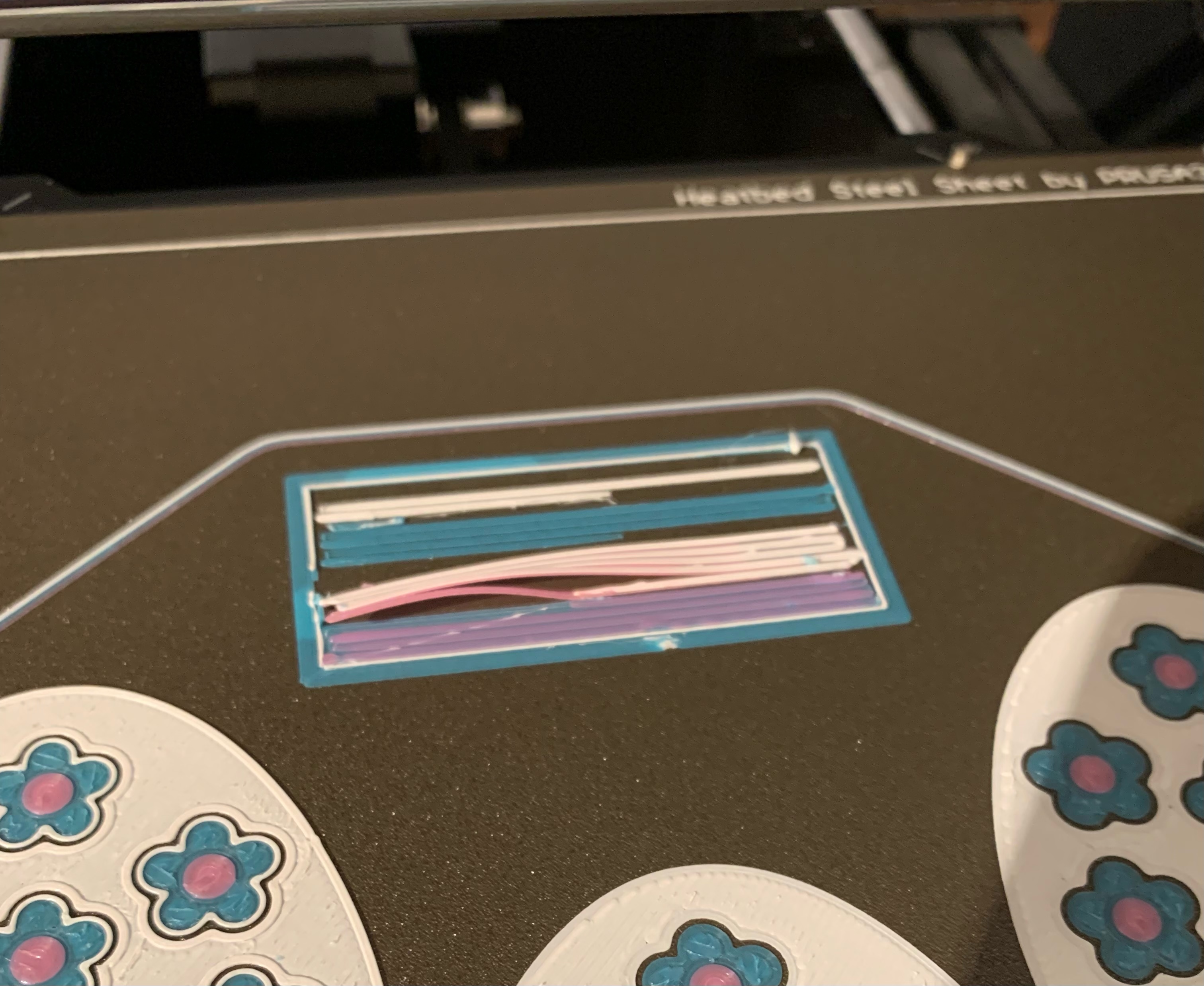

I have a MK4S, using PrusaSlicer 2.9.2 presently. I was using earlier versions had the same results.  I've only had the MK4S for a few months and when I first received it I printed some parts using PETG and they came out perfect,  but a bear to get off the plate,  I was using the Smooth PEI sheet, well come to find out it is suggested for PETG to use the Steel sheet, so I purchased a new one,  went through cleaning it good and it worked perfect for PETG no more struggles to remove prints. I end up using the steel sheet for pla too and once cool the prints come off nicely.
But now that I am using the MMU3 and a Wipe Tower,  printing with PLA and using the Steel Plate the wipe tower constantly fails either right away or in the middle of a print,  the edges of the wipe tower lifts causing it to come loose and even one time stuck to the print head and created a mess to say the least.  How ever the print / model sticks just fine.  I re-clean and even change position of wipe tower and it don't make a difference.
But I switched back to the smooth plate and have No issues with the wipe tower or prints sticking to the plate.
I prefer the steel plate most of the time since prints come off easy compared to the smooth plate. So I am thinking I am missing something somewhere ???
Attached are a couple of the failed towers,  also the same print on the smooth plate with out problems.

The answer to your problem may be as simple as Glue stick, for both the smooth PEI sheet and the other I'm guessing textured sheet? This should give you the adhesion you need for the textured sheet, and the release you need for the Smooth sheet, and yes it works like that 😉.
If your not having problems with the print itself, only the wipe tower, you can just use the glue stick in the area of the wipe tower.
A glue stick should have been included with your printer, if I'm not mistaken. Give this a try and see how it works.

Sorry, I don't own an MK4 and never will, my understanding from reading PRUSA's rhetoric is that the MK4 will always lay the perfect first layer, if this is true that couldn't possibly be the problem ?(BTW I'm not implying its not a good machine). I have several MK3 series printers, and they are good. I could tell you from the one image you posted what I see, the extrusions look over extruded, and I would guess that your purging may be even more over extruded, possibly pulling on the previously laid extrusions, on a sheet type that has been known to have slightly less ability to hold, and you are reporting as such. You can adjust for over extrusion, and I could teach you a thing or two that I'll bet you don't know about cleaning a build plate. Me, I always go for what works, If I have a way to fix it, Layerneer in my case, It's getting used. But if you want to fight the fight, whatever you perceive that to be, have at it. However your bottle of magigoo will make it go away. Frankly it could be as simple as a finger or thumb print on the build plate.

Hi  From what I understand Under the Wipe tower group settings, there is a  setting "Extra flow for purging"  default setting is 250%   So I'm thinking maybe that might have something to do with it ?  but I have no idea what the setting would be.  I tried looking it up but didn't find any info.

As far as the extrusion goes you will have to test (play with) the purge tower "Extra flow for purging" and see how it reacts with the filaments your using, it's very specific to your filament and the environment your printing in. You need to determine that for yourself. (Speed of print can be a factor)
