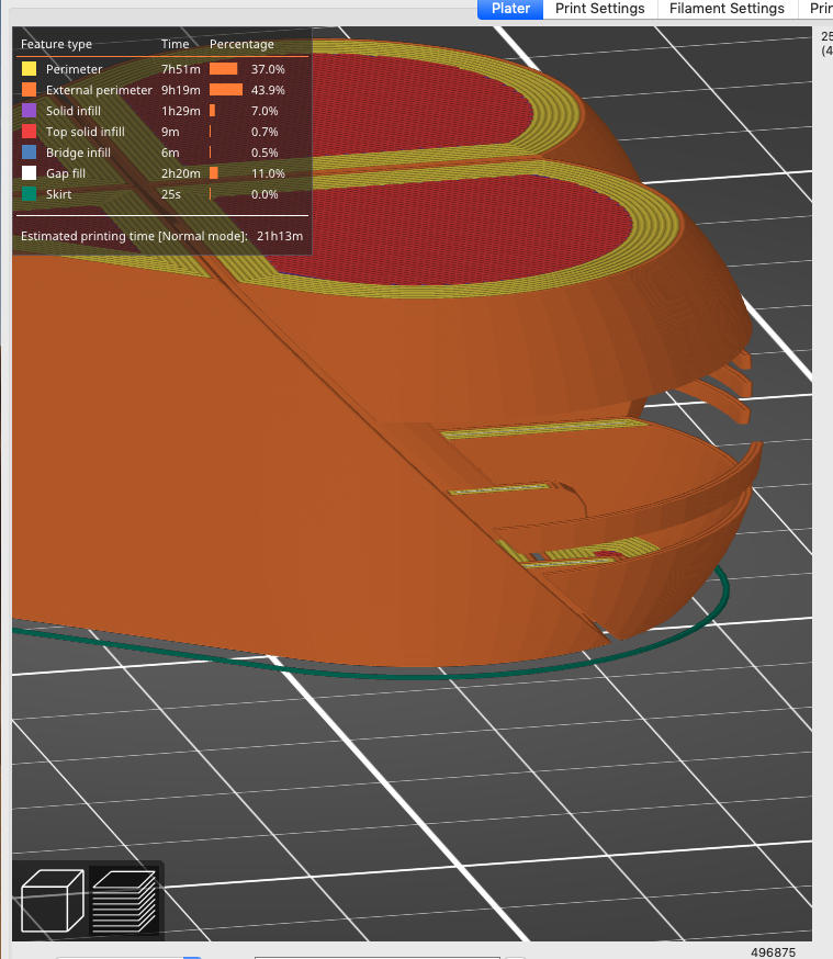

My niece has a wedding coming up in June and I'm looking for something neat to print for her, I tried printing a heart box from Thingiverse: https://www.thingiverse.com/thing:44579
The model has thin walls, in the best of cases it's two layers thick, but a section of the model has no shell at all in one part.  I've tried changing wall thickness and perimeters without any change.  On other models I've worked with that have had similar problems I've scaled the model up a little but, but that doesn't help either, I set it to 150% with no change.
Are there slicer settings that I can use to successfully print this?

As I said, the problem is in Slicer, the model is supposed to have complete walls, but in one part of the sliced profile it has gaps.

I have just downloaded the model myself and sliced in PrusaSlicer and think I see the problem you are describing, same for me. Rear right curved corner has sections missing, have tried thin walls and extra perimiter options and nothing seems to cure it.
However I sliced it in Cura and looks fine.

Just got your image to load, exact same issue for me with PrusaSlicer 2.3.0
Looks perfect in Cura 4.8.0

Still not sure this is truly a bug. I suspect these are very thin walls, close to the edge of printability, Remember that all these models are made of triangles, so there's no real "curve", and if due to the curvature of the walls the thickness slips down below a certain value, PS may just give up on it.

The original one ( https://www.thingiverse.com/thing:44579 ) loads fine in PS 2.4.0 Alpha 0.
There are errors in the original model file which can be fixed either via NetFabb or using PrusaSlicer's built in "Repair STL File..." feature in 2.3.0.

As I said the original STL from  https://www.thingiverse.com/thing:44579   loads fine in PS 2.4.0 Alpha 0.  The problem is that there are errors in the models STL file which can be fixed either via NetFabb or using PrusaSlicer's built in "Repair STL File..." feature in 2.3.0.  Once running it through either of those it works perfectly in PrusaSlicer 2.3.0.  Make sure after using the built in repair feature that you need to open the filename.OBJ file you saved not the STL.
Please don't post issues to GitHub about this as it works once fixed (not Prusa's problem) and anyway PrusaSlicer 2.4.0 opens it correctly anyway (they obviously improved the automatic repair system).
