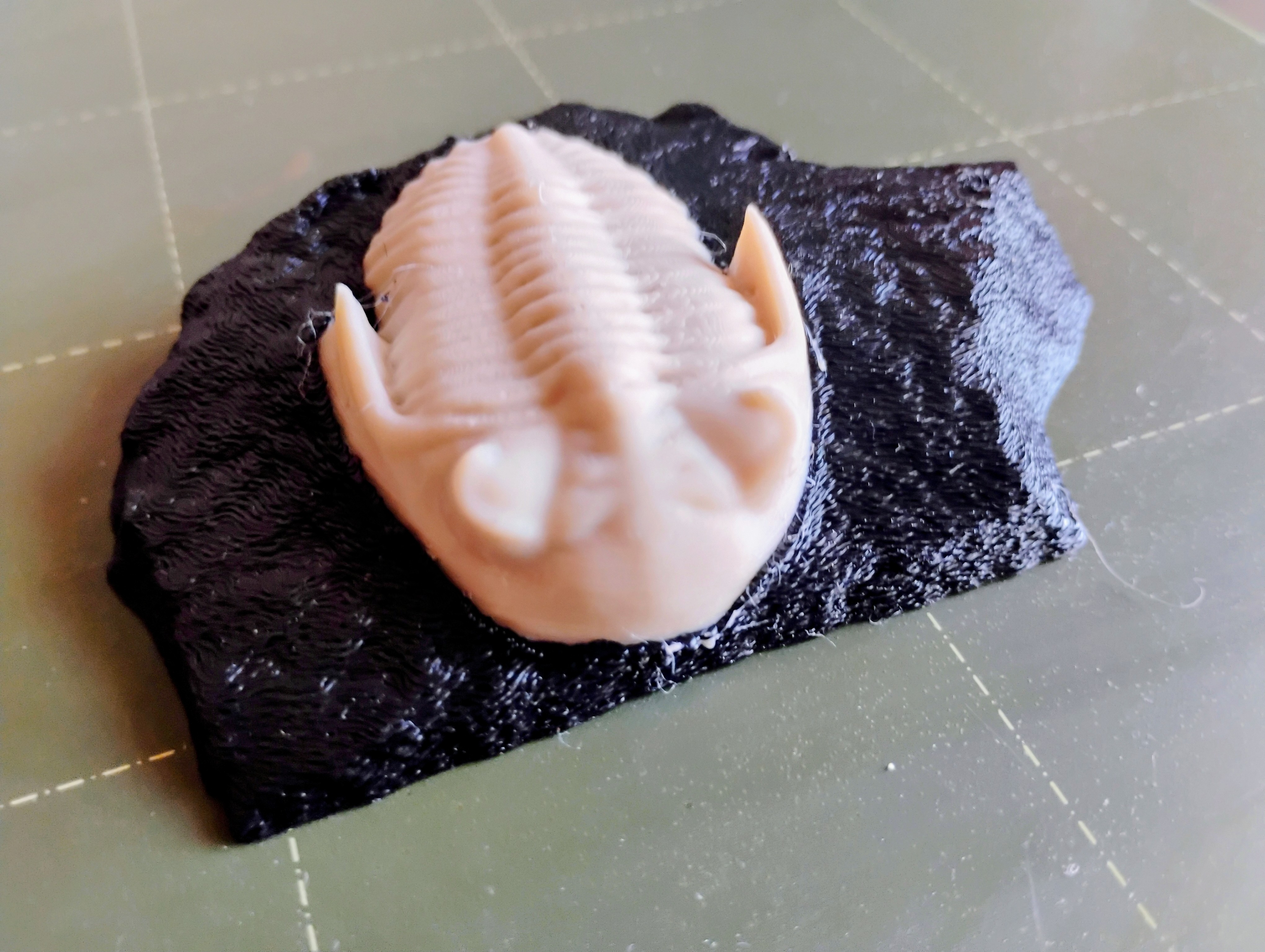

Sure you can precisely align objects by the numbers. But if you are just creating a decorative piece that does not  need precision placement just eye-balling one part on top of another and sinking it in a millimeter or two works just finedecorative fossil
