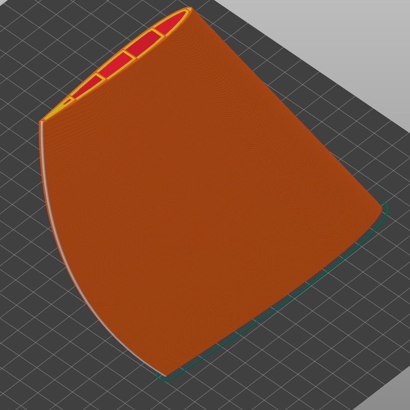

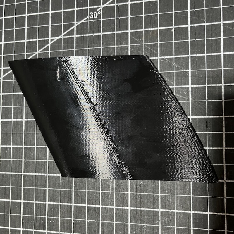

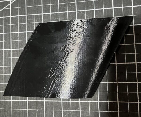

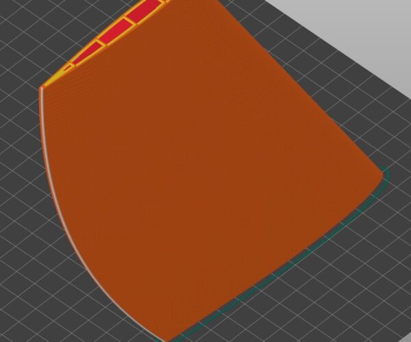

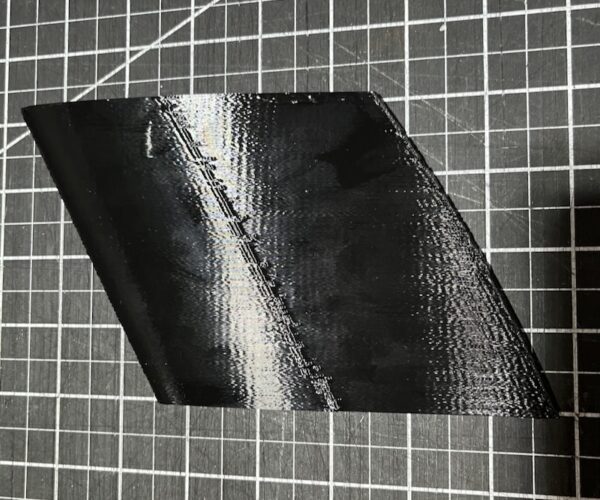

When I slice my part, the seam is shown in the desired location, with seam position set to Aligned.  But when I print the file, it's doing a strange start / stop in two other locations, leading to surface defects.  Previously I have incorrectly specified the seam position or part orientation, resulting in a similar defect, but only at one location.  Why would it start and stop at two, non-seam locations, instead of making a contiguous loop from and to the specified seam location?  Thanks for any insight.
Pics show both sides of the part, and preview with correct seam location.

It may correlate with the need to divert filament to internal structures, especially in thin sections.  If you would like us to look closer save your project as a .3mf file

Thanks, there may be something to that.  But I just reverted to classic perimeter generator, and now it's printing correctly.  It seems like a problem with arachne.
