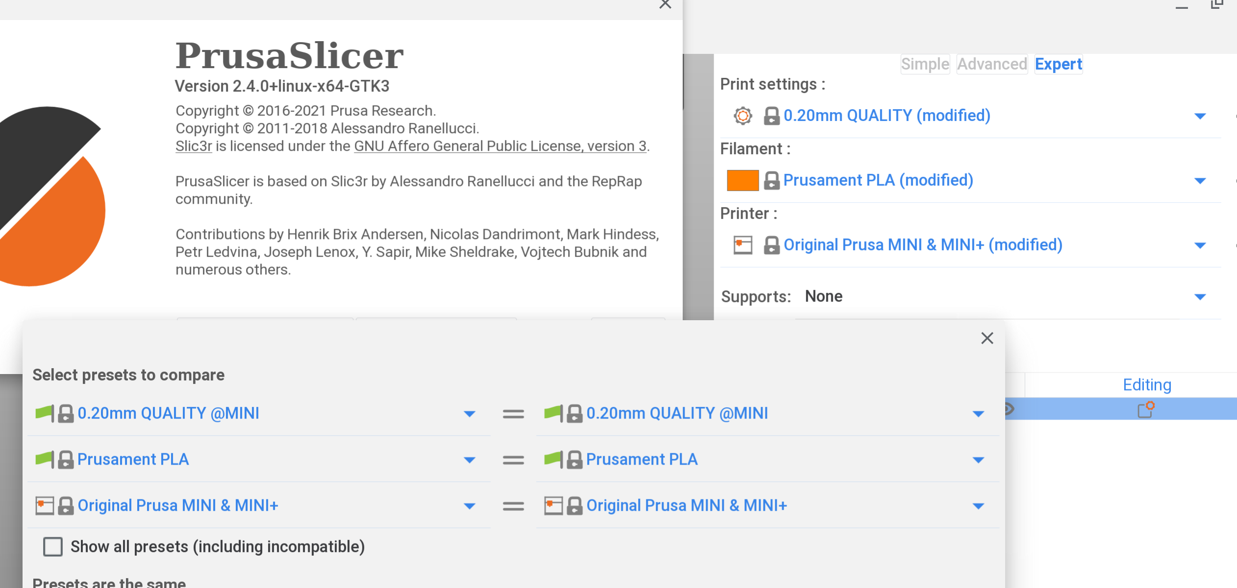

Hi all,

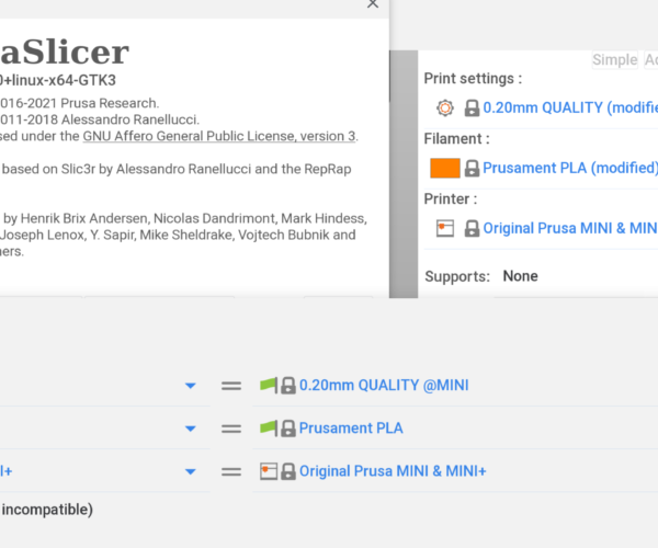

When I open another maker's 3MF project, I noticed that it will modify my existing profiles (Print Settings, Filament, Printer - see screenshot.)
I discovered Window>Compare Presets - but as you can see in the screenshot, PrusaSlicer thinks the presets are the same, but they're not.
How do I open a project and also see the preset changes by the original author without having to examine each value in Edit Settings?
Thank you!
Edit: not sure why the media isn't in the post - added as attachment.

I noticed the same. Unless I'm missing something, it looks like a bug. I usually look for things in red on the settings tabs.

RE: Opening 3MF and comparing presets
Instead of opening a 3mf as that opens the Project (and a project consists of the object, print settings, any modifiers etc) you can use the normal import which should bring the objects in without the profiles.
Compare presets was added in the 2.4 builds.
