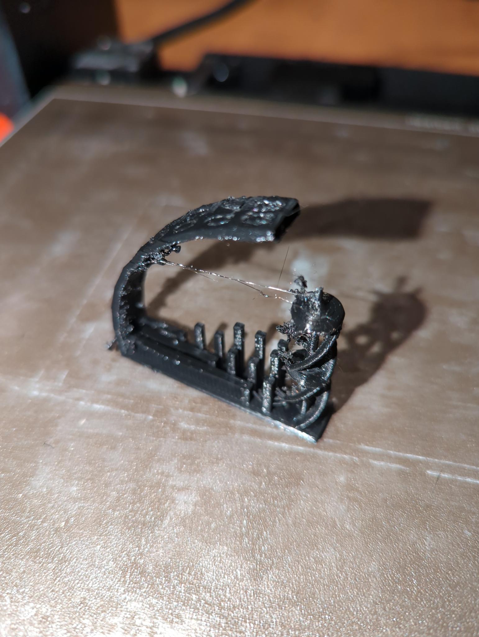

This is the most "successful" print yet.
ail_in_one_3d_printer_test_nano
Posted : 28/09/2024 2:02 am

I just printed these tonight using the Prusament profile, Hatchbox PETG filament, .2mm structural with lowering the temp to 240.  This is with doing nothing to the part.  This is exactly how it came off the printer
I print with some silver Overature occasionally using the same settings with the same results.
Is your filament dry?
And those are scratches in my table, not strings.  There is zero stringing.

Do you have the same setup as I do? MK4S with the MMU3? Your picture is very similar to how my Overature PETG prints used to look before these upgrades using the settings I listed earlier.
Currently, I am trying to calibrate the printer for this filament using the "0.10mm FAST DETAIL" default presetting. Only adjusting the filament settings.

Always remember with PETG: "just opened" and "fresh out of the bag" does not automatically mean that it is dry enough for printing! You should dry it first. Your print in the photo looks like the filament was not dry enough. Why do people first try to change all possible settings in the slicer, waste a lot of time and filament, before they start with drying the filament?
