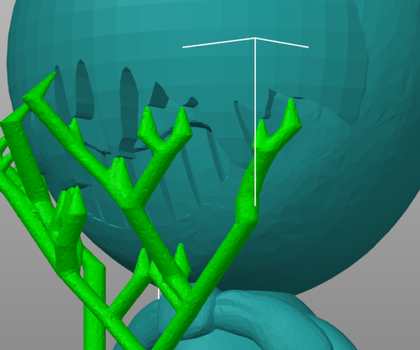

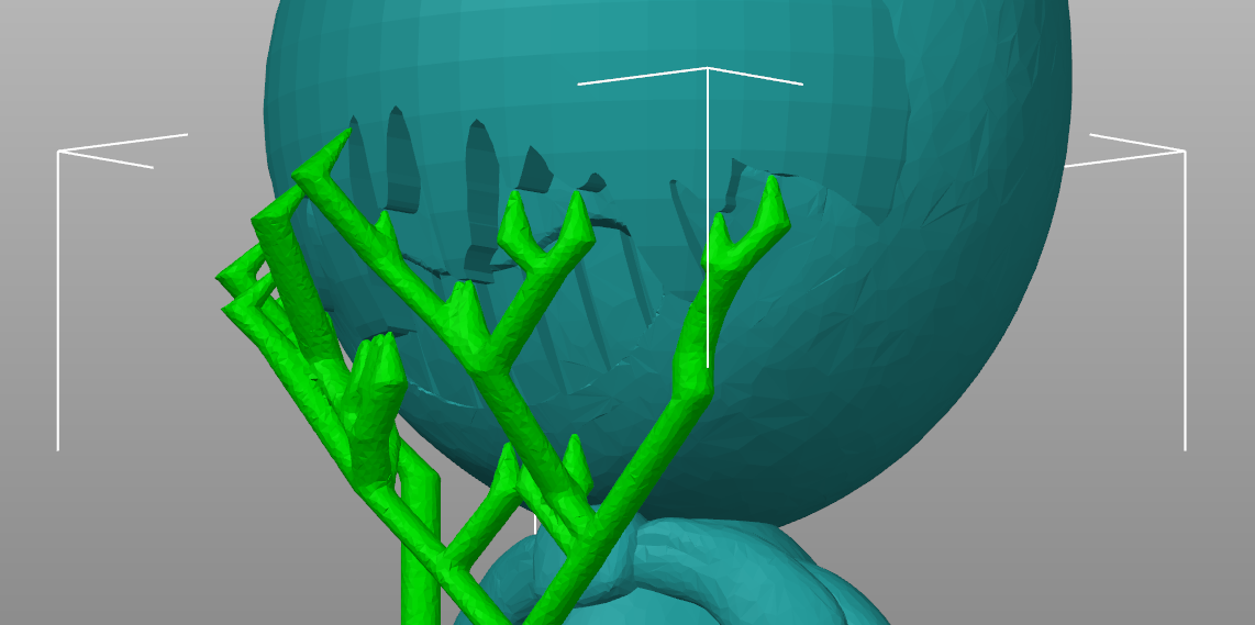

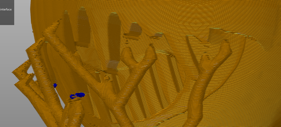

I tried to create tree supports with Mesh Mixer, according to the youtube video tutorial. The object itself looks good, but the layer preview seems to be broken. How do I fix that? Is there any setting I'm missing?

Looks like you have the tree tips too small (I forget the term in MM, but you can increase it to 0.5 mm and get a better interface for slicing).
Or, try enabling thin wall detection in P.Slicer - it may allow the small bits to slice.
