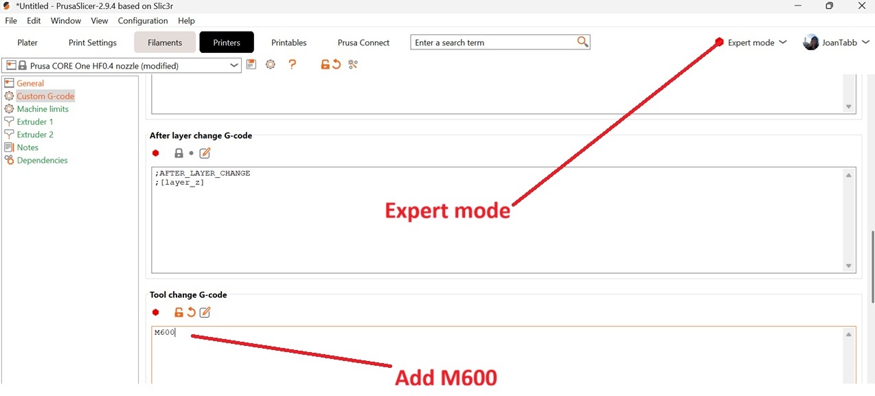

Hi, I must be missing something. I decided to try the multi colour printing today. Printing the toolbox I could see the "tool" colour doing some changing activity and print the purgetowe, but it did not pauze, so no time to change the filament at all.
What steps I took:
- upload the stl in prusa slicer
- split it into parts
- made the settings for multi extruders
- selected the right colour per extruder
- added the extrudeer to the stl files
- sliced all and started a print
So I saw some custom g.code mentioned above. Where to paste that? And will that help me printing with the colours? Any other advise? Thanks.
Can I group the same colours (see stl listing) together so less changes? I noticed I can move the stl to other location..
Some impressions of the print and settings I used now:
Posted : 26/03/2026 4:46 pm
RE: "Manual" multicolor
Did you add
M600
to the tool change Gcode section?
regards Joan    This is likely to add an extra colour change after bed levelling and the purge line, where you need to insert colour one
Posted : 26/03/2026 6:25 pm
dutch3dprints
(@dutch3dprints)
Thanks I did not see those fields in my screen before, was not aware that I had to scroll down further there 🙂 Now beside this code in that place, where do I place the code  from mike_gka ?
Posted : 27/03/2026 10:12 am

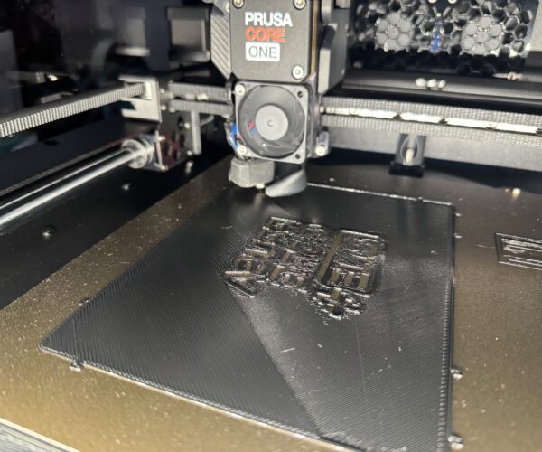

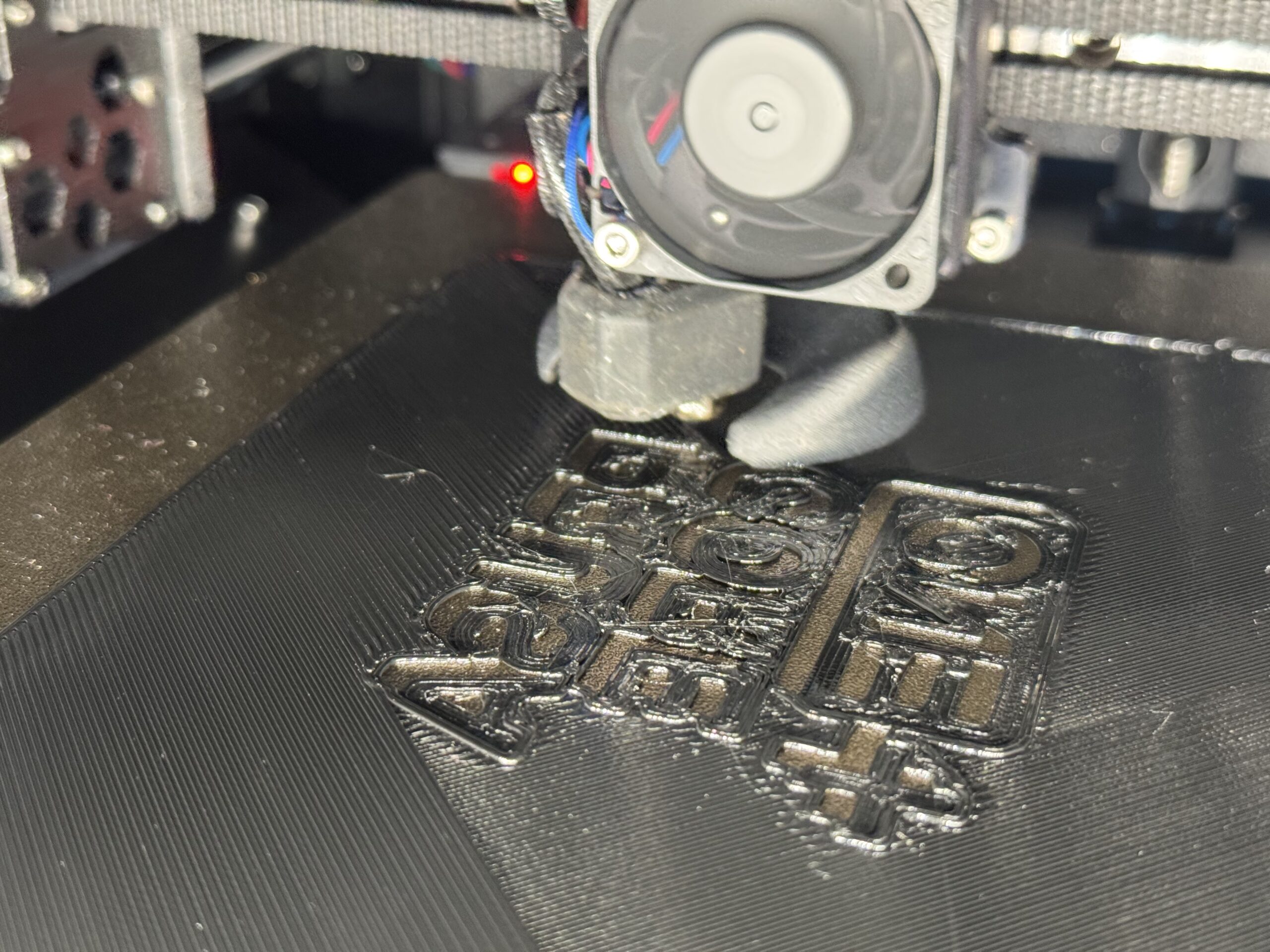

I thought I'd give the "Single Extruder MMU with wipe tower" a try on the C1+ and I keep getting crashes just before the tool change. The nozzle makes a line after purge and then goes through it right after. The issue seems to be Filament -> Advanced -> "Number of cooling moves". If set to 0 the gcode does not reflect this behaviour. On the other side this cannot be the standard behaviour. It probably should increase z here - what am I missing? (Prusaslicer 2.9.4 on Generic PETG profile)
In the screenshot the issue starts with gcode M104 S245 in the first layer tool change. In the picture you can see the result of that on the print plate.
This post was modified 2 weeks ago 2 times by Username7688
