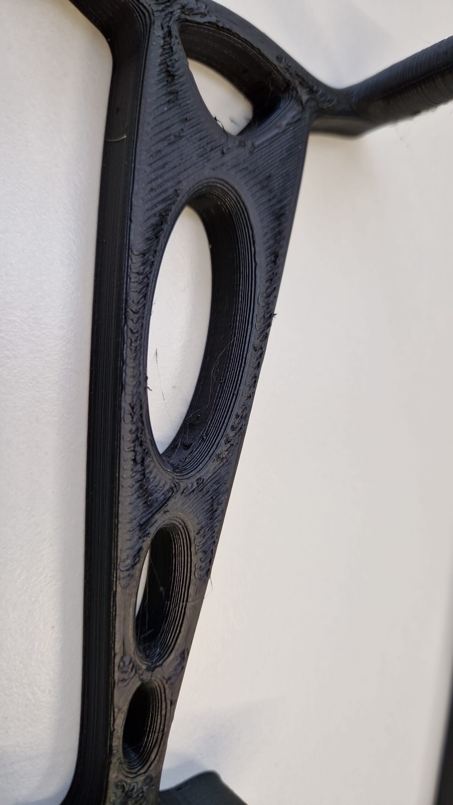

Hi guys
I recently changed to Prusa Slicer from Simplify3d. Printer is a Custom built machine, with linear rails, sturdy aluminum extrusion frame, using E3D V6 Hotend with 0.6mm Nozzle. I tweaked the settings up to this point for this printer and most things are very nice in Prusa Slicer. BUT:
I cant for the life of me not dial in the top layer settings for Prusa Slicer exactly right.
I already burned so many hours with this issue, i just dont know how to proceed. I tried the following:
- Playing arround with the extrusion multiplier
- Different Layer height settings (currently happy with 0.3mm)
- Solid infill extrusion width (tried values in percent and values in mm (currently set to 0.65mm)
- Played arround with custom G-Codes to influence the extruded amount, but no sucess so far.

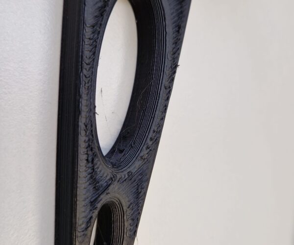

On the example picture:
How can I setup Prusa Slicer to extrude less plastic on top solid infill only?
Everything else is just fine. Extrusion Multiplier is correct (currently 1.02) and overall Part Size is accurate..
Changing Extrusion width settings for top solid infoll does not do anything obviously, as this only changes how far the different lines are spread appart. The slicer changes the extrusion amount to allow for perfect top. Only in my case, for some reason I cant figure out, it extrudes way to much plastic at the top.
How can I control only this feature as I want?
Any tip is greatly apreciated!
