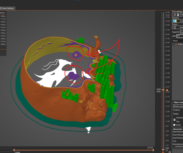

I am trying to print a skull I found on Thingiverse by cutting it in half with the Prusa Slicer and then attempting to glue them together (first time doing something like this, but it makes sense in my head). I really don't want to use an infill if I can help it. I want to treat the skull kind of like a sphere. I have successfully printed the back of the skull this way, but I am having some issues setting up the slicer for the front. When I look at the way the software wants to slice it it looks like eye sockets are going to attempt to be printed with no supports helping. I tried to add supports a bunch of different ways, but I don't know how to force supports inside the object. I can get them to show up on the outside a bunch of different ways, but not to help the eyes. I could be wrong and. I could be wrong and supports are not needed by I am not sure how the filament is going to float in mid air.

Yep, that's pretty much it.  Supports are generated to support the exterior of a volume (ie a 'solid' manifold mesh area).  Infill is generated in the interior to provide support for this shell of perimeters.
Normally you would use some cad software to hollow out the object.  It can be a bit weird to visualise.  Take a sphere, Its manifold, has no holes and so the slicer knows what is external and internal when it slices.  When sliced if you look at the preview you can see the colour keying difference between an external and internal perimeter (if using more than 1 perimeter).  You can print it with no infill but its still outside and inside.  Now if you want a hollow sphere its 2 external shells.  One that you can see on the 'outside' but the one you cant see inside is still an external shell as far as the slicer is concerned.  Its still manifold in that the meshes are unbroken.  Its just one is inside the other.  Its the second external mesh that in effect is defining the hollow area.
Its that internal mesh that is missing from the skull.  Depending on the complexity this can be difficult for cad software to do, at least automatically.

This is what it looks like when I have show the layers up to the point it starts to try to print the eye sockets.

The project is needed for sure but I think the problem is the OP has infill set to 0%. I suspect they have bottom layers set to zero and zero infill to get a ‘hollow’ skull from a solid model. Of course they won’t work as supports are only generated on the outside.

Ok, I might understand what you are trying to get at. Correct me if I am wrong, please.
Should the process for me trying to make this skull object have started with me making the object hollow when it was whole. Then, slice the skull in half and orient it how I want it. Would this then allow me to place supports on the "inside" of the object since it is now not the inside, but rather "underneath" the structure?

Alternatively you could try something like this.
Using modifiers to add the infill back only where needed, it can be removed easy enough if applied sparingly. But I'm seeing many places that need to be supported not just the eye sockets.
