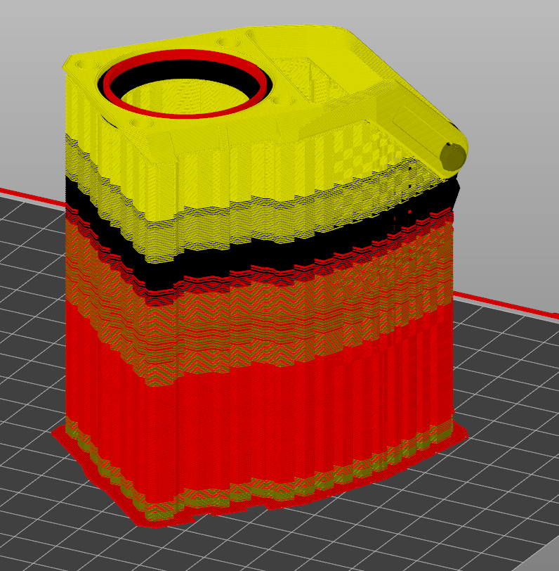

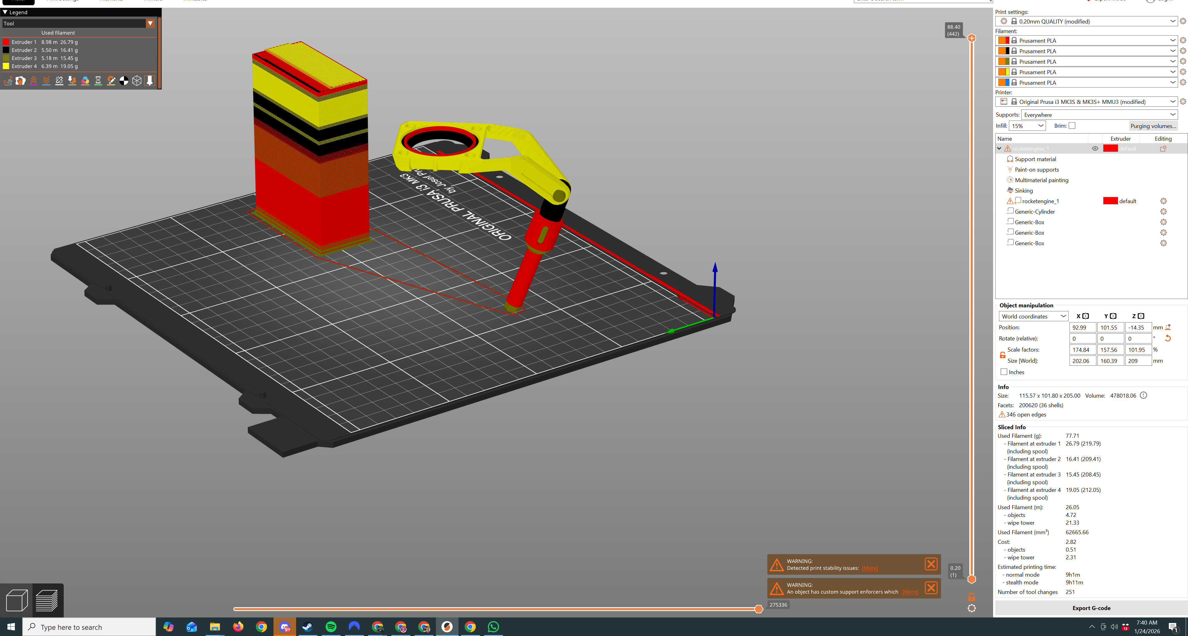

I am printing this multicolor rocket engine. The print is almost done, but one of the struts failed to print. I want to reprint just that strut and glue it to the model.
I can remove the portion of the model I don't want to print with negative volumes. The problem is that the resultant shape needs support. I can't figure out how to get prusaslicer to apply support to the new shape. I have tried "everywhere", "support on build plate only" and "for support enforcers only" settings. No supports are generated during slicing for any of these options. For the support enforcer option I cannot work out how to paint the surfaces that are exposed by applying the negative volumes, but that is moot because no supports are generated for the surface I can paint anyway.
Does anyone know how to to this and rescue my 70 hr print?
Version is 2.9.4 i.e. latest as of time of writing
Sliced view Negative bodies removing the part I don't want to print

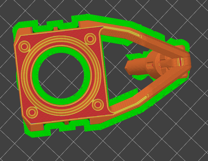

Yes you can do this, and I can help you, I will need you to save your project as is exported from Prusaslicer, then Zip the exported project file up and post it here on the forum, the forums file server requires that the project files be Zipped or they will not allow it to be posted. I can see certain aspects of your project in the pictures, for example you sunk portions of the "Object", as a side note you don't need to add negative volumes to areas of an Object that you sink, (they don't print), however the solution for supports added in areas subtracted by Negative Vol, will be specific to your project. That's the reason for needing the project file.

Quick question? Did you want Organic, or Snug? Snug takes the most time (3 hours of support mat.) and makes the most contact, however offers the most stable support. If you wanted Organic that takes (2 hours of support mat.) you may need a custom Brim which I would add before sending the file back to you, and you may want to consider that you using multi-materials, and sometimes they don't play nice with each other relative to supports, but all that will be on you. I will add the custom brim if you want Organic.
Organic
Inside Snug, just so you can see.

Yes thanks I was able to complete the model by printing in multiple parts.
I also found that the step I was missing to generate support material was to not only select the support option from the usual dropdown but to also check the "Generate support material" checkbox in object settings.
