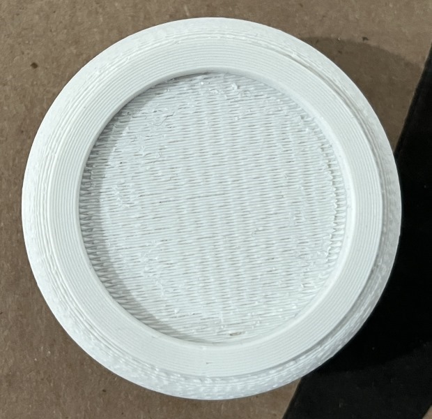

I changed the filament from ABS to ASA and I've been making steady progress with my part except a curved overhang section. I'm using support enforcers and so far I can't get good support to go higher. This is a picture of the underside of the  part.
Here  is the support enforcer I defined. Notice it comes up to the widest diameter of the part
And here is the sliced part. Notice the support material barely goes above the brim.
What parameter do I need to change to get the support material to cover the entire underside of the part as intended with my support enforcer cylinder?

I did another print and left the support material in place. I get the support material generated for the recess on the bottom.
However, from the top / side view, I don't see any support material contacting the part.
I was expecting it to make contact up to the widest part of the curve.
Does anyone see a setting I have that would cause the lack of support material on the curved sides or could this be a bug? I'm still pretty new to 3D printing so I'm leaning toward the first explaination just not the cause. Thanks for any suggestions.

thanks. look at the first picture in the original post which shows the problem I'm trying to solve. I want to get full support for the underside to get a clean print. The edge has a continuous curve. Here is the part and the support enforcement cylinder which goes up past the widest point of the curve.

Early attempts had no support which gave the same poor printing on the lower curve. As the print progresses from the bottom there isn't enough support for the next higher layer which is why I was trying to add external support.

Snuffleupagus I ran your file unaltered, and it detached from the base plate at about 2.9 mm from the base plate. I also made a copy of the project and set all speed settings back to the mk3.5 defaults. When I ran that file I watched the progress of the printing and saw the outer ring (red and blue arrow) starting to lift off the plate and begam to rotate round the inner support material disk.
So I don't make the wrong changes, what sets the gap at the green arrow? I think it needs to be more attached to the ring (blue arrow) to help keep the outer rings from coming loose. Same question for the gap at the blue arrow. It needs to be less attached. In the test it was so attached to the inner ring that I couldn't break it loose with pliers.  Once I get the faster version printing I'll make  the same changes to  your original file so I can see the effect that printing slower has on print quality. Thanks again for your help.

JimD, this sound like a bed adhesion issue, you may want to clean your platter really well, and add glue stick or Layerneer bed weld if you have that, other causes could be that you need to adjust the nozzle's distance to the bed a bit.
To answer your question, the Green arrow points to the Support enforcer called Generic-Cylinder, and the distance to the wall is controlled by its scale. This was done this way because the support enforcer that the Blue arrow refers to, called Tube needs to be closer to the overhang that is causing the trouble. In order to get this overhanging area to print well I scaled the Tube just under the first part of the 90 degree overhang of the first overhanging layer, then to continue support I adjusted the "XY separation between an object and its support" to 20% with "Top contact Z distance:" set to 0.1mm. I actually did a lot, I printed two and both printed nicely, the supports around the overhang were removable by fingernail they zipped right off, and the supports in the middle were removed easily with a pen knife.
I'm posting several close up images rotated and from several angles of the prints I did, so you can see that I'm not making this up.
These were printed with Prusament ASA
When we consider that this is ASA printing at 250C on a 105C platter with 0.1 detachable supports on a 90 degree overhang, I think its a very acceptable result, Also consider the amount of material present internally this can very easily be sanded and vapor smoothed. But we have to get you to this point.
I really believe you have an adhesion issue first and foremost, and before changing the file settings I would look into that.

Everything arrived and is installed. For good measure I did a full calibration of the printer. The results with Layerneer and using your file were great. I did, however, set the speeds to the default 3.5 settings which only took 1 hour.  I did have a little problem removing part of the outer ring. Bottom support disk came off cleanly. Thanks for your  help.
