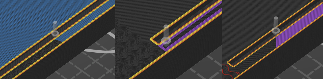

Prusa Versions: 2.5, 2.6 Alpha 5, 2.6 Alpha 6
Hopefully applicable Print Setting: Perimeter two (2) or three (3) as noted below, Top Solid Layers 4, infill 5% Gyroid, Top Infill Pattern Monotonic Lines, Fill Angle 45, Perimeter generator: Classic or Arachne, 0.4 Nozzle, .02 layer height
I have a print with a 6.35mm 'lip'. If I use three (3) perimeters then the second and third top layer print parallel to the perimeters resulting in overfill and crashing of the nozzle. If I change to two (2) perimeters then all top layers are printed at a 45 degree angle with no overfill/crashing.
Questions:
1. What is the minimal width for PrusaSlicer to use the set Fill Angle?
2. Is there a setting to force Prusaslicer to always use the set Fill Angle?
