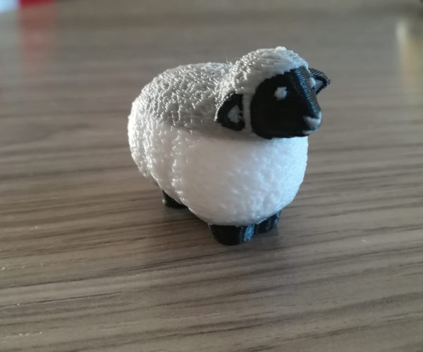

RE: Feature Request for Prusa Slicer - Gradient Colorchange
I played with colourchange on the MMUv2 and the results were not very good...
when you don't want colour bleed, it seems impossible to get away from...  as ably demonstrated by this picture of a member's 'Sheep' print
dav
however when you try and force that effect, the results don't seem so effective.
this hollow cylinder was printed with successively shorter lengths of filament without using a purge tower of any sort, and the bleed from one colour to the next is almost imperceptible
Before you ask for G code. I didn't work out how to force the MMU to run end to end colourchanges without a purge tower, I simply printed a single colour model, and fed pregressively shorter lengths of different colour filament into the extruder by hand.  you can see some graduation in colour, but I don't think it's a particularly useful option.
the bottom picture is PLA Filament on a ' washed and dried' textured build plate, no other surface treatment
Posted : 29/04/2020 1:25 pm
