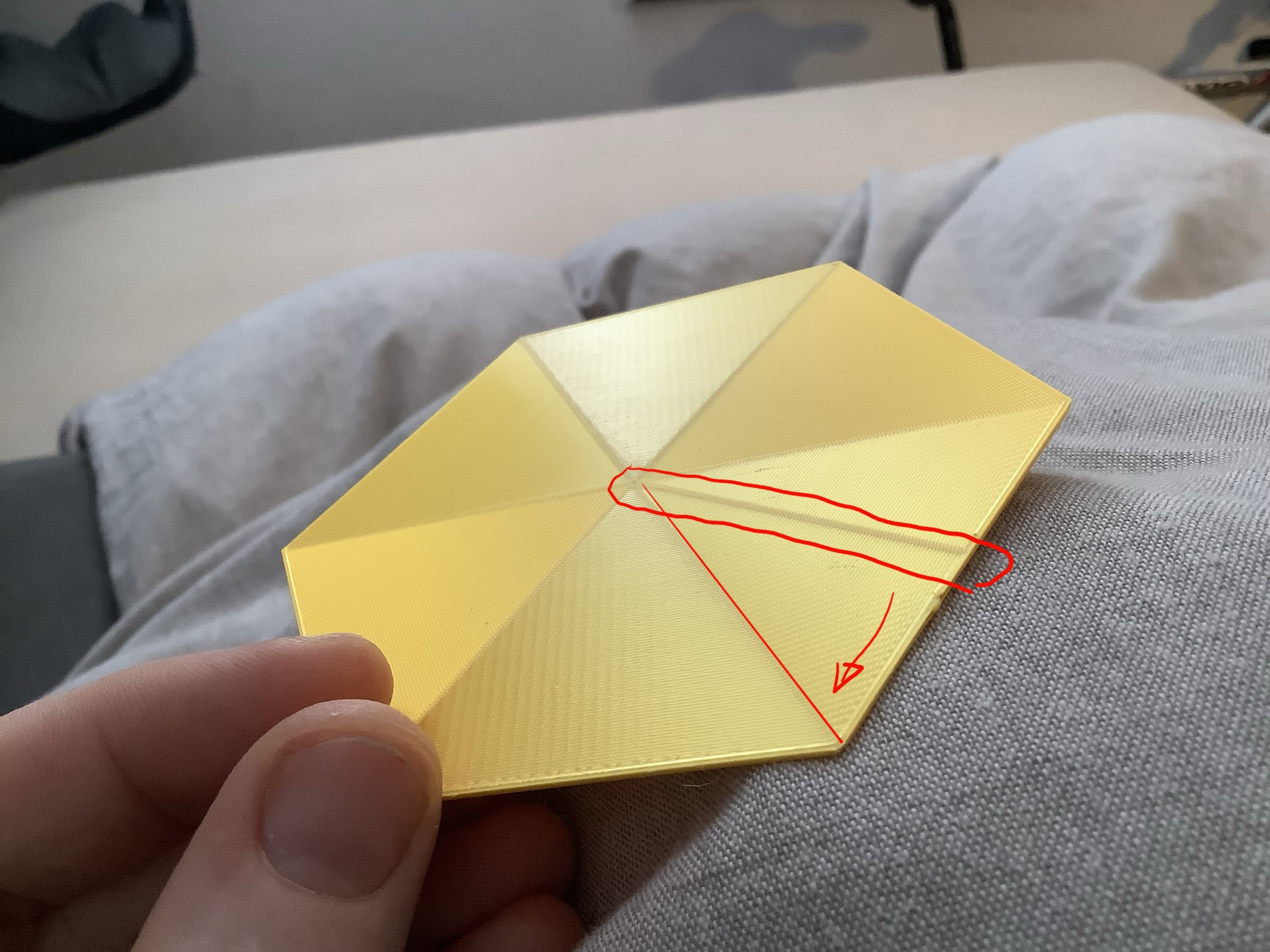

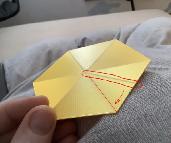

is there any way to move the position of the seam when using concentric infill?
technically it‘s not the seam all the other seam setting control since we are talking about one layer but still it would be wonderful to achieve a look without this nasty line.
i tried rotating the model, changing from arachne to classic walls, Printing with lots of perimeter walls to not use solid infill at all on the top layer. All didn‘t change the outcome
thanks for any ideas in advance
                            Posted : 23/12/2024 7:40 am
                    I found the answer
Print Settings > Layers and Perimeters > Perimeter Generator
Select 'Classic'
You should be all set.
