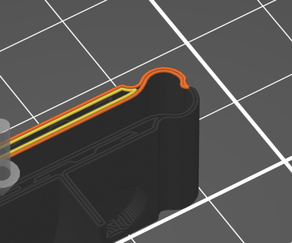

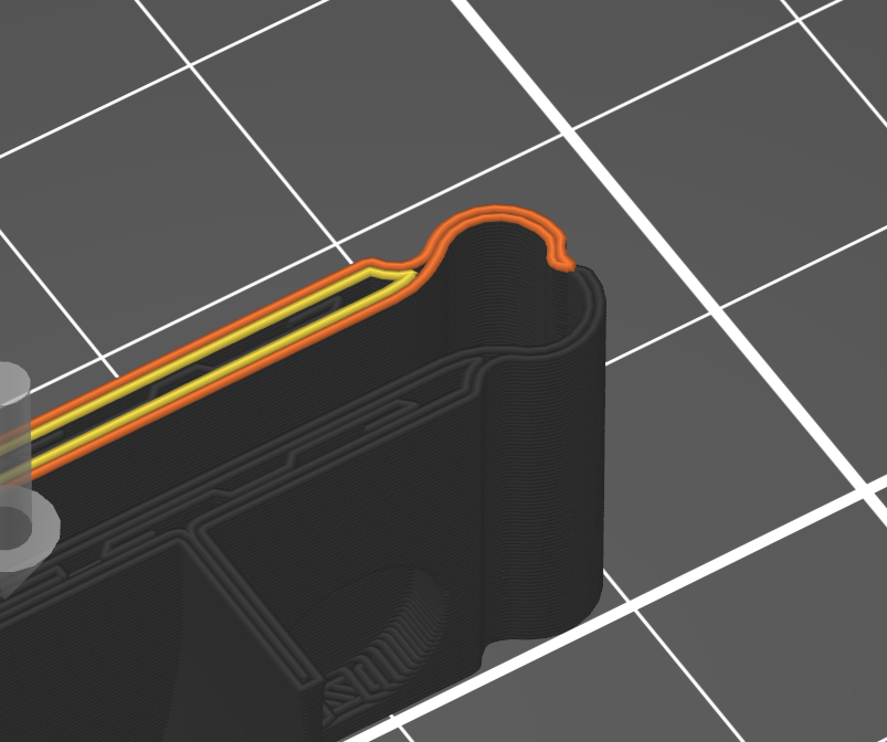

Clarifying question about how to change how the slicer slices. I have a thin wall that is supposed to work as a living hinge, as such I need to have this section be a continuous layer as seen in figure one. Figure two shows how most of the layers were sliced normally, with a gap in the middle that is causing the failure in the living hinge.
Figure 1: Example of how I need each layer, with a continuous run along the living hinge
Figure 2: Example of how the living hinge is split, resulting in an ed print that isn't fused together.
I tried adjusting the seam settings in the slicer without success. Then I moved on to Scarf seams. Arachne didnt solve the issue but Classic did, specifically:
-  Scarf joint placement (everywhere / Scarf start height 0% / Scarf joint length 20mm / Max scarf joint  segment length 1mm / fill gaps / Perimeter generator Classic)
Two questions:
- One, is this the  proper way to move the printers starting position on a print?
- Two, what is going on under the hood between classic and Arachne perimeter generation?

Did you try seam painting to force seams in specific region? https://help.prusa3d.com/article/seam-painting_168620
(this is similar to paint on supports, which describes it better how to use it https://help.prusa3d.com/article/paint-on-supports_168584 )
