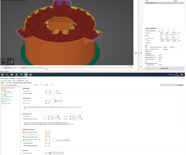

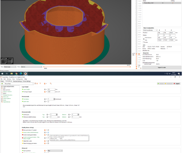

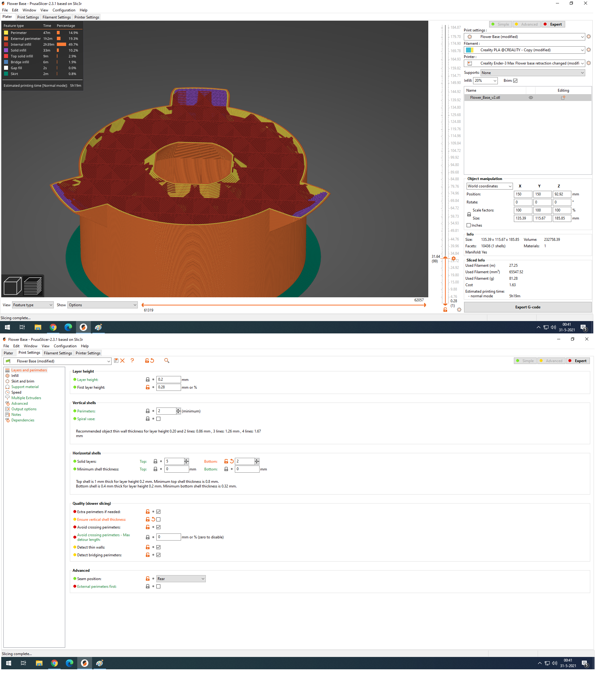

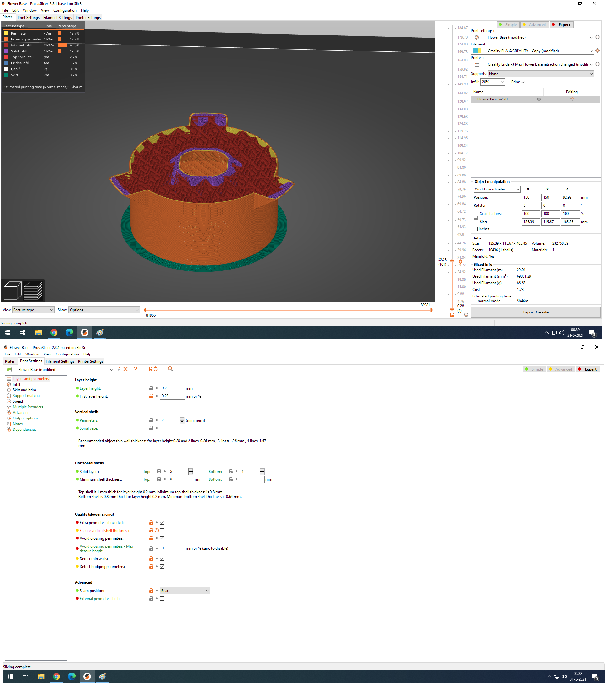

Good evening y'all,
I changed from Cura to Prusaslicer for the additional surface finish options that Cura doesn't have. I am very happy, but the above issue and similar is driving me crazy. I read solutions like set top/bottom layers equal, disable vertical shell thickness, change from 2 to 3 perimeters.
Now changing the bottom layer to 2 and changing from 2 to 3 perimeter seems to work, except it feels to me like a temp fix because the actual issue (is it an issue and not a feature lol?) doesn't seem to show up in Cura.
I am very curious if someone can help me with what setting I am messing up and or if the screenshots may help if the feature isn't a bug.
Ensure vertical minimum thickness Disabled + bottom layers 2 + perimeters 3 Ensure vertical minimum thickness Disabled + bottom layers 2 Ensure vertical minimum thickness Disabled Ensure vertical minimum thickness enabled
Publié : 30/05/2021 11:14 pm

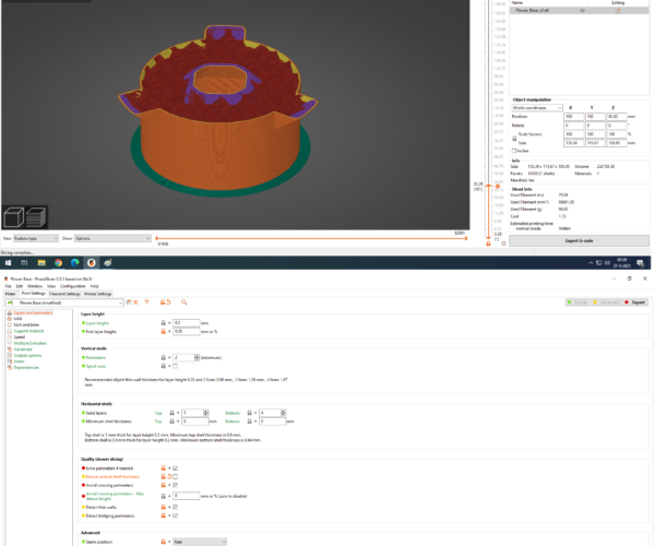

Kelko
(@kelko)
RE: Avoid solid infill near sloping walls
Sorry for the double post, but I couldn't edit my older post.
I added an additional screenshot with "Extra perimeters if necessary" disabled
Publié : 30/05/2021 11:22 pm
