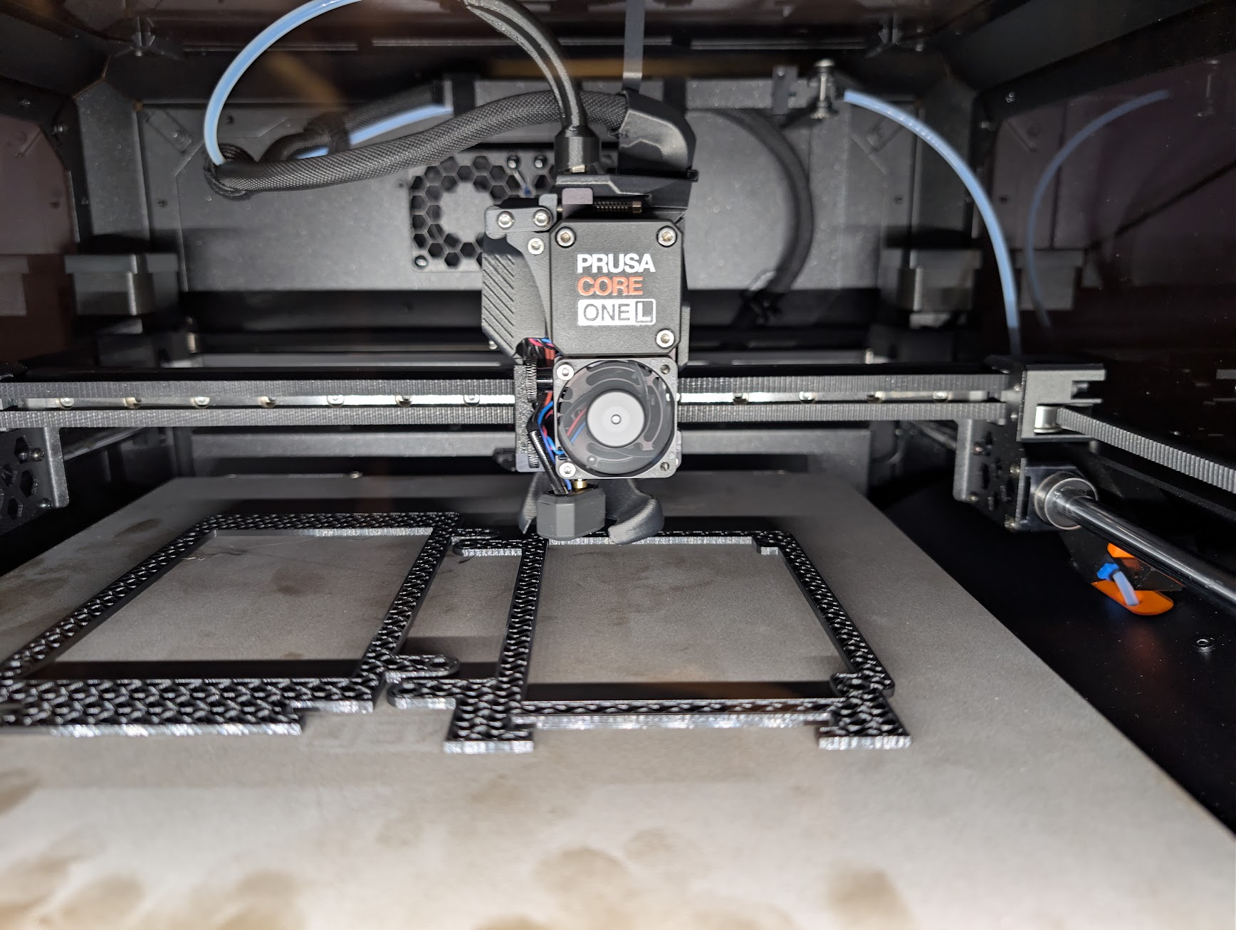

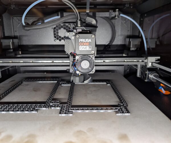

Hey guys,I need your help. I'm currently setting up a new Core One L. It looks like the print head is mounted crookedly. Should I just ignore it and start the first print? What do you think?
Thanks in advance.

It should be perpendicular to the bed, but it's not.
Does it pass the tests? If yes then ask Prusa Chat for guidance or see the docs for Core One kit assembly/replacement for more details how to readjust it.
If no, then it ask Prusa Chat immediately, because that would be really bad that if it skipped quality check or got skewed during the transport?

well, its doing a great job I think. I'm not sure if this might lead to greater and faster wear and tear. *shrug*
But thats a good advice.. I should at least ask in chat. Thank you for your advice!

Today, I had time to take apart the extruder and take a closer look at the whole “crooked extruder” issue.
With the help of David from the support chat (one of the screws couldn't be unscrewed and I had to carefully destroy one of the less important printed components—a replacement is on its way).TL;DR ... Basically, the extruder was just not mounted straight. In the end, it wasn't a big deal.
Thank you.
