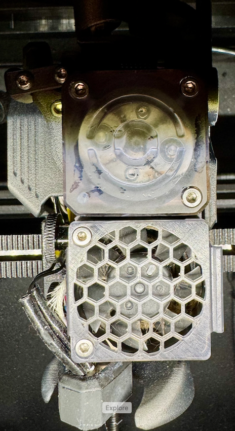

3d0zer
(@3d0zer)
Core One L - Squeeking Sound from Printhead
Video:
Only when the print head is moving fast.
Seems not to be the belts, they are not always in sync with the sound.
Only with faster print moves.
Sound listened with ear close, seems to come out of print head.
- Cleaned the Nozzle,
- Checked already the cable and bowden guide arm, also the bowden itself.
- Searched for solutions, did not find.
Changed the nozzle today, but printed fine afterwards. It started now during a long print.
Hope you can help me.

Hard to say but I'm wondering if it's coming from the planetary gears in the Nextruder. I printed a clear cover for mine so I can see what is going on. Might want to pop the cover off and check if they are properly lubricated.

I was indeed thinking about the extruder already, gears have not thought about it.
But as I could not repair it during this print, I pulled back the filament / bowden on the side of the printer (just some tension, not pulling hard) and put the bowden back in place... sound is gone... and comes back later and now it is gone again, so it is extruder related and maybe gears indeed. Tomorrow when the print has finished I will inspect further. .
