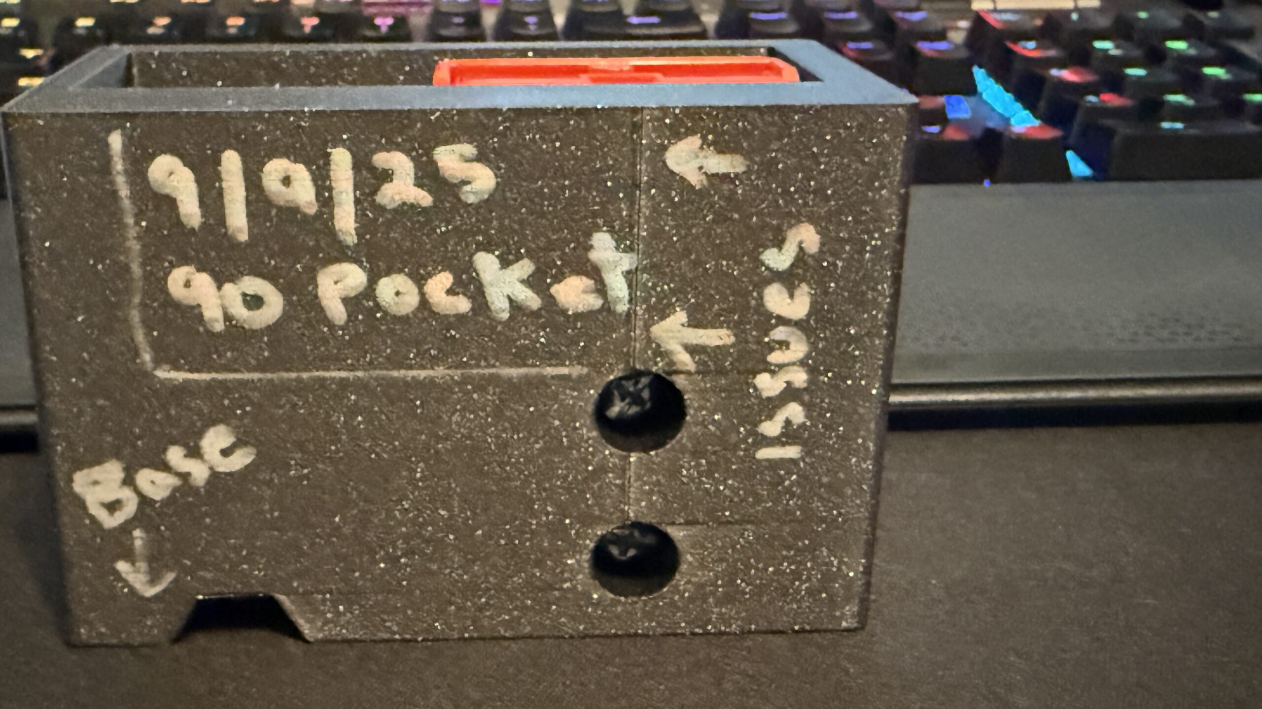

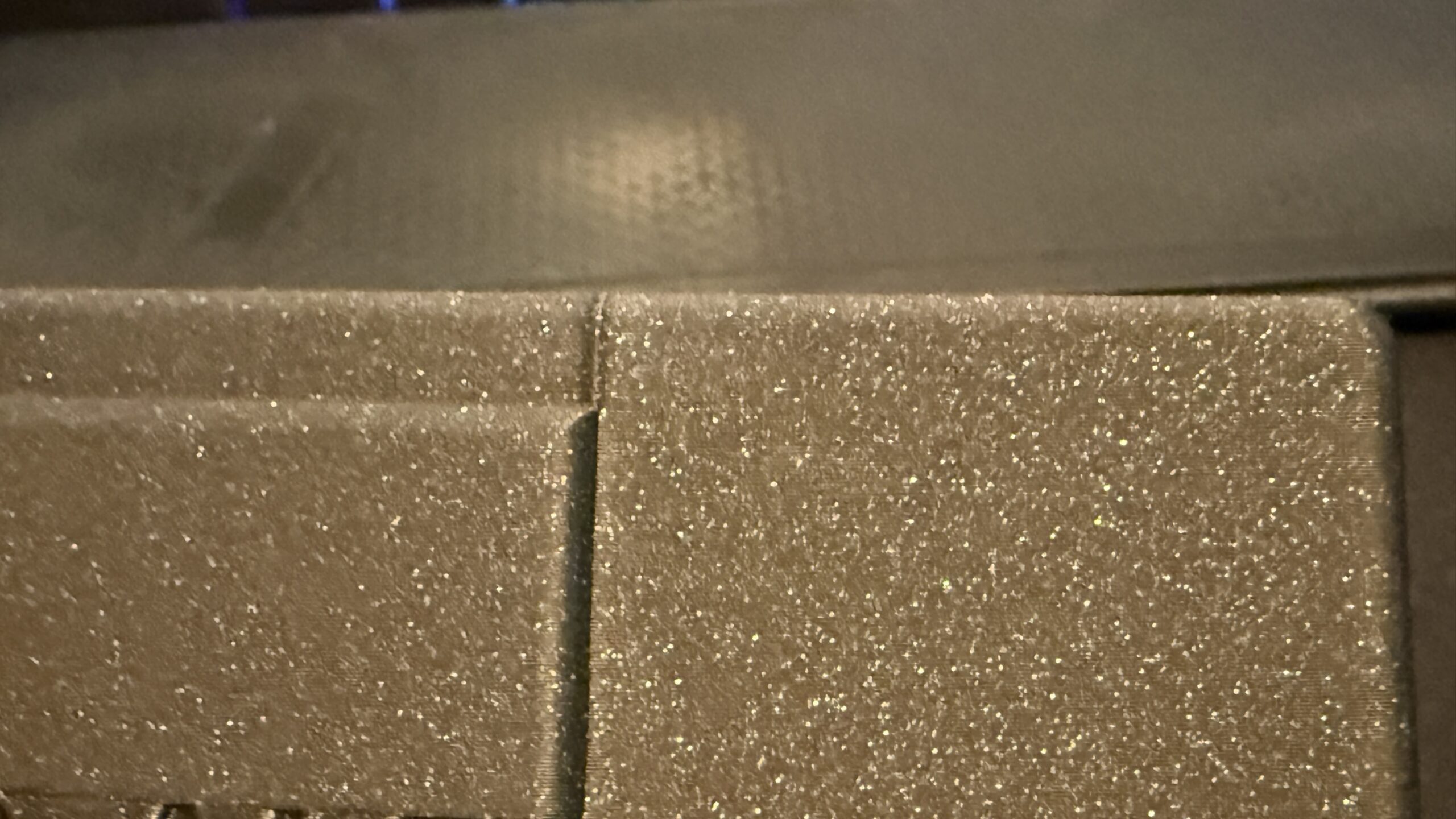

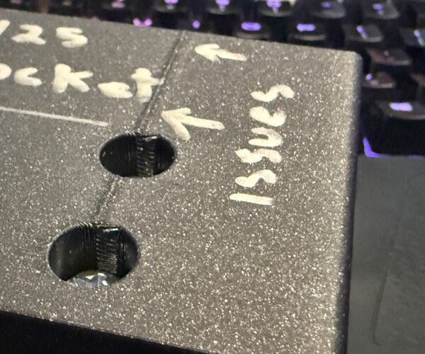

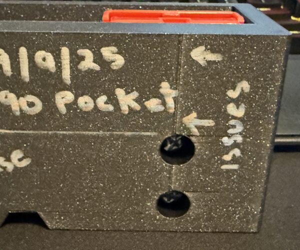

Take a look at this pics and tell me what you make of this "bump" in my prints.
The issue is using my Core One, Prusament PLA, bone stock .20 mm SPEED profile, 15% infill, with HF0.4 nozzle.
All the pictures I'm going to show you, were accompanied by what I can only describe as a bang/thud.  Never, ever heard anything like this sound from my printer before.  The one shot with with the sharp corner and steep z-axis change, the noise was very loud.  Like OMG my printer is broken loud.  The others were pretty subtle, but noticeable.
3 Prints, all made thud
Hopefully you can see them with this iCloud link.
Is the the slicer allowing the head to come in contact with the print?  Is that what I'm hearing?
If the pics are in order, the first 2 you can see the hump between the two holes, the next 4 are the same export just flipped 180° in PrusaSlicer.  Those have the hump all the way to the top.  So just flipping the job give different repeatable outcomes.  The last is the pic with the god awful sound.
How do I stop it?

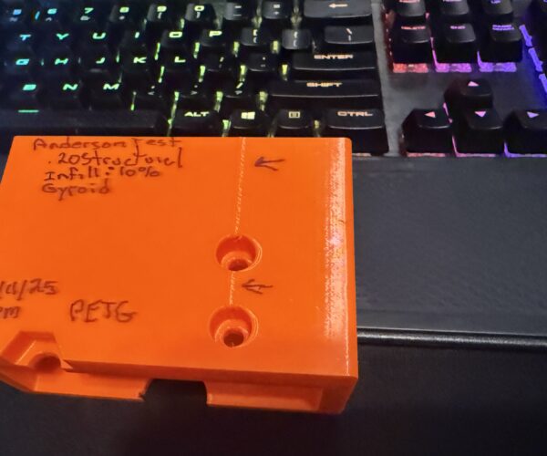

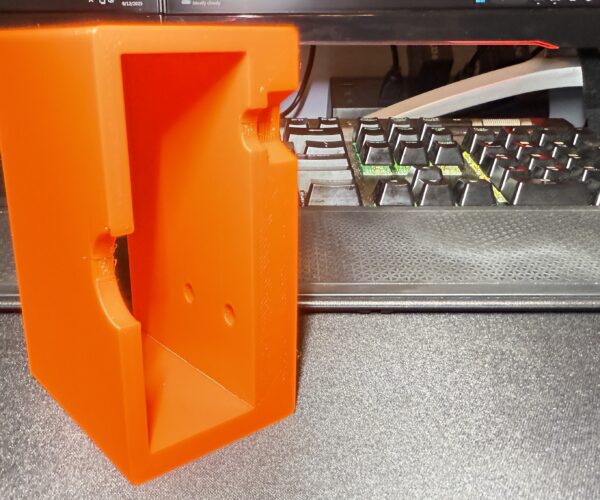

Just ran another test, with Avoid crossing perimeters: Checked and Supports Everywhere.
No change.  Orange does make it a lot more noticeable.
I'll keep trying.

Okay let me see how I can get you guys some pics.  To answer your question, I would assume so?  Everything else is flawless only these two 3mf files that exhibit this issue.
I've got a test running using these parameters.
0.20 Structural
Supports: None
Infill: 10%
Fill pattern: Gyroid
It's only 37% done, dog slow but I don't see this hump any more.

I think I got it 🙂  The print from yesterday that I thought was fine was not.  No change.

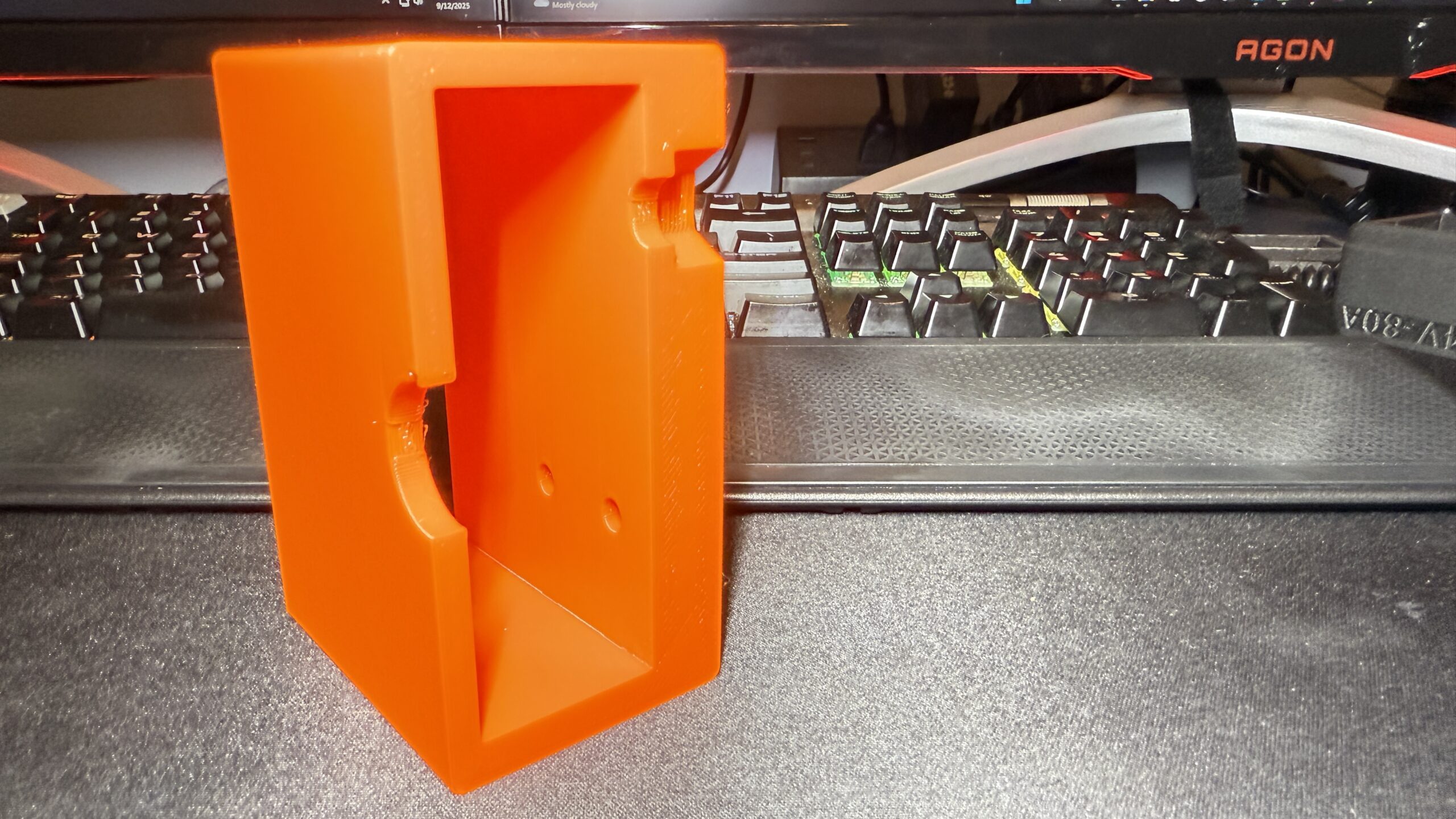

This is yesterdays test print.  I have a video and you can see the printer transition layers at the exact point of the problem.
Then you can see the back of the print.  No issues there.

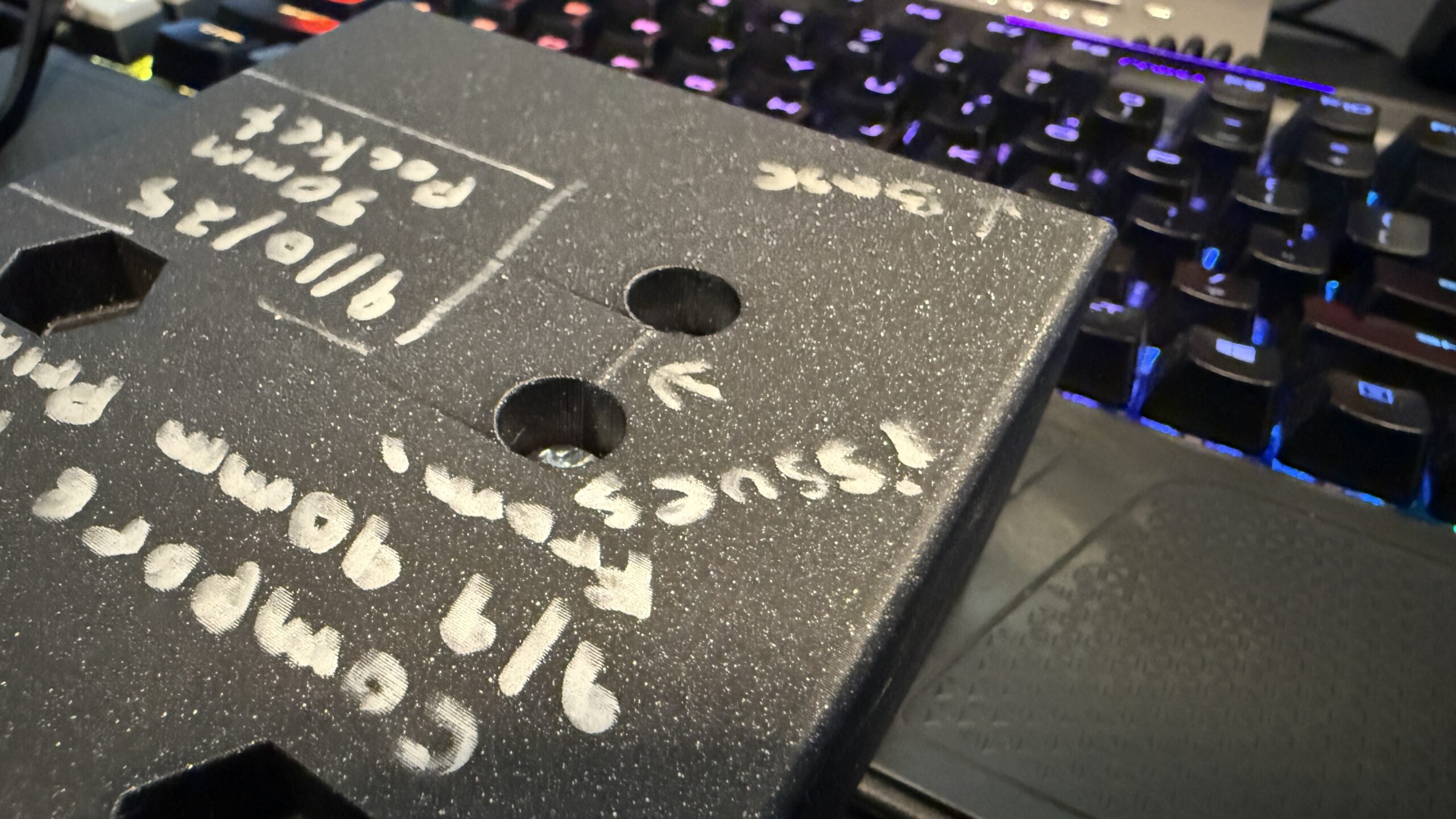

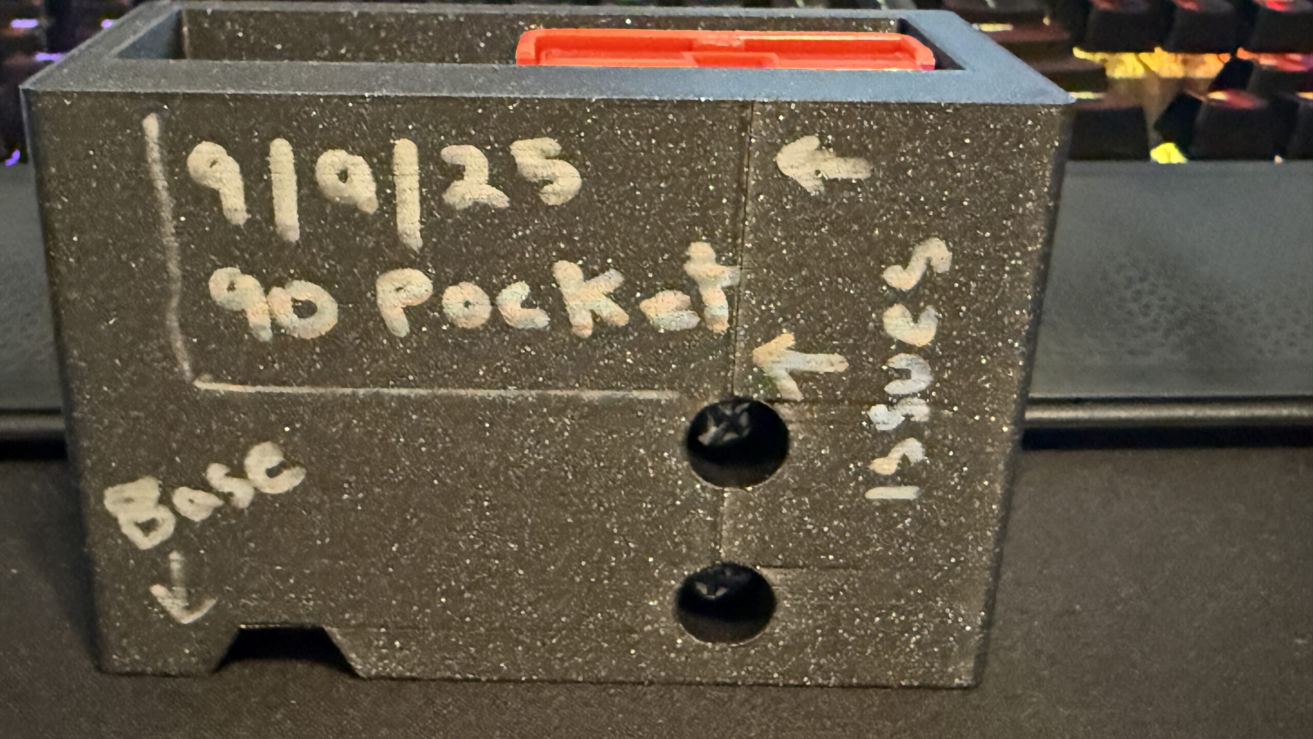

I am going out on a limb here but I would bet that you printed this part oriented with the face with the cutouts facing the build plate (i.e. the bottom most picture of the black part).  If I am correct, then most likely what you are seeing is the "seams" where each layer begins and ends.  From the appearance I would bet that the slicer setting for "seam position" (Print Settings -> Layers and perimeters -> Advanced) is set to rear meaning you are going to get a nice vertical alignment of seam "pimples" on the rearmost surface of the part (the other possibility is "aligned" but the slicer should have tried to hide the seam in a corner then.
If I am correct in my assessment, then there are several seam settings that can impact this.  First, (assuming PrusaSlicer) make certain you are in either "normal" or "expert" mode (top right corner of the slicer window the mode is a "pulldown" selection.  In these modes there are several settings that affect seam position (aligned, random, nearest) and one called "scarf joint placement.''  The first setting will do nothing for the appearance of the seam except change where the slicer stops and starts each layer.  The second changes the way in which the layers are extruded with a "tapering" of the end of the layer (a scarf joint as used in woodworking) to eliminate the hard stop/start that causes the visible seam artifact.
There are other thing that can be done to minimize visible seams (temperatures, retraction settings, etc) but my bet is that you can get perfectly acceptable results with just the seam settings on most parts.

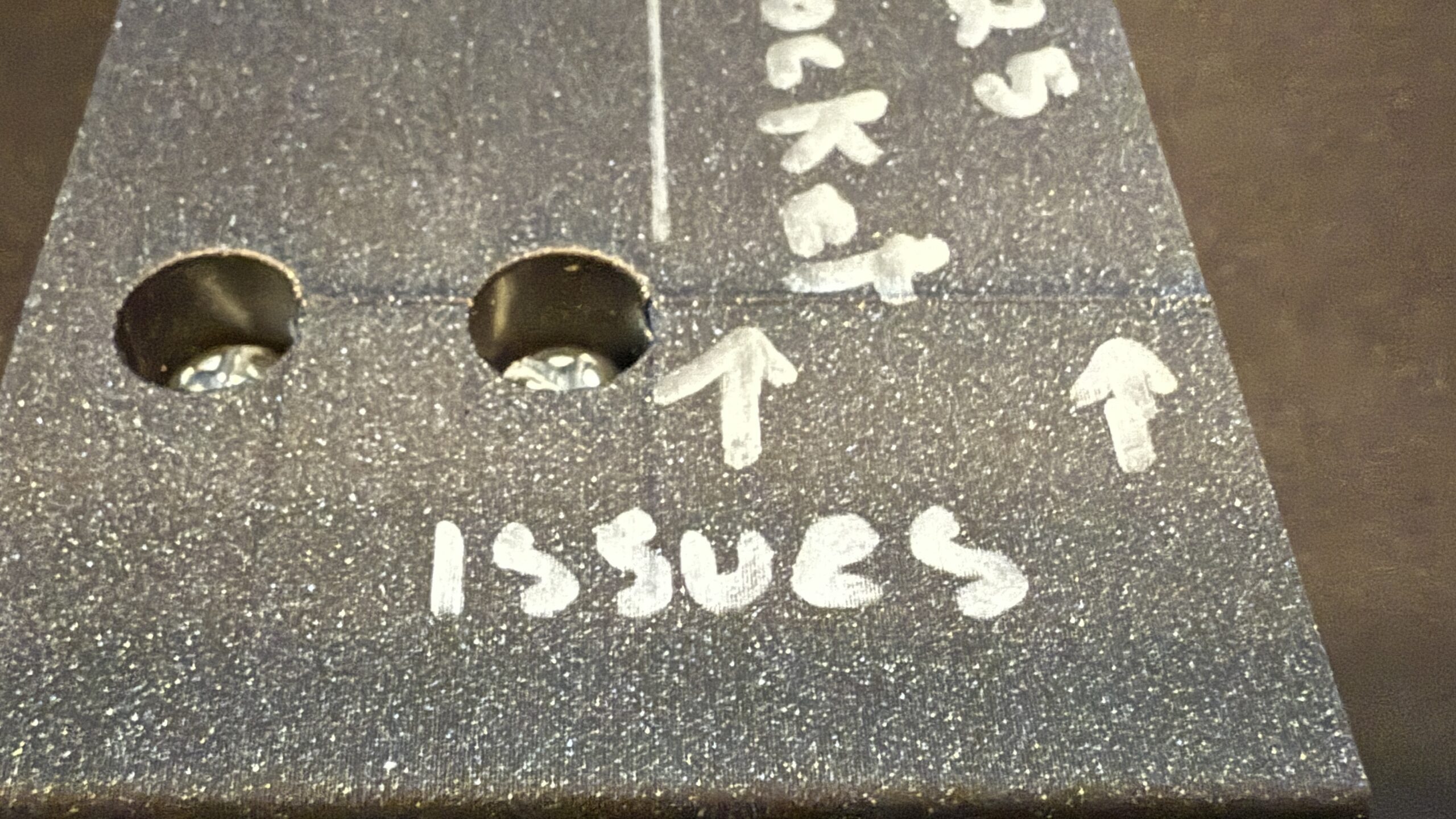

Can you guys get to the Dropbox folder?  I just dropped the 3mf file that generated the Orange prints.
The first 2 pictures where the only ones printed with the hex opening as the top "furthest from the build plate".  They showed one seam, only between the 2 Anderson connector mounting holes.  If you look close you can see the text "base" scribed with Sharpie indicating that surface was on on the build plate.  B kinds of looks like a 3, sorry.
All other prints had the end with the M8 Hex bolt head on the built plate.  Those prints the seam started at the top of the 1st Anderson mount hole but continued all the way to the top.
Going to see if I can find this seam position setting.

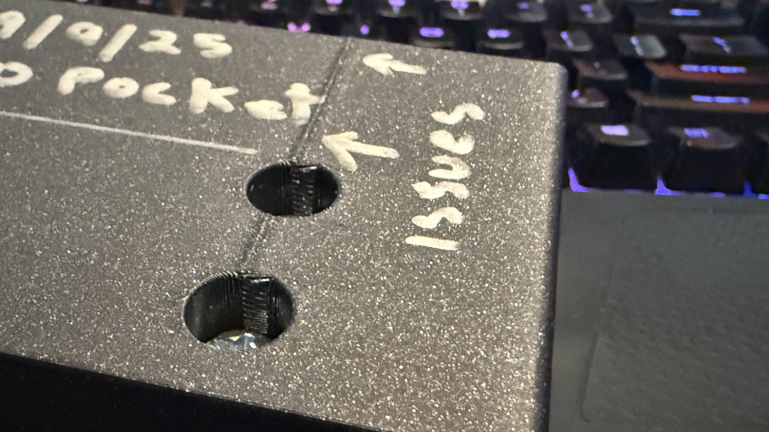

Hope I'm doing this correctly.  I looked at the Advanced -> Seam position and it's set to Aligned.

Not exactly an apples to apples comparison since: 6.4.0-alpha firmware, PrusaSlicer 2.9.3, 0.4HF Obsidian, 0.25 BALANCEDk, 10% Gyroid, Prusament PETG. The rest are just the default settings. No crashes with the infill and the only seam is between the two screw holes. Not going to do anymore tests because don't want to eat up anymore filament but have you tried with setting the seam to 'Random'? Or perhaps adjusting the Seam gap distance?

Try printing this. Don't move the object in any way, the rotation around the Z axis is there intentionally to move the seam to one corner where it won't be as noticeable. Or you can paint the seam anywhere you want where it won't be as noticeable.

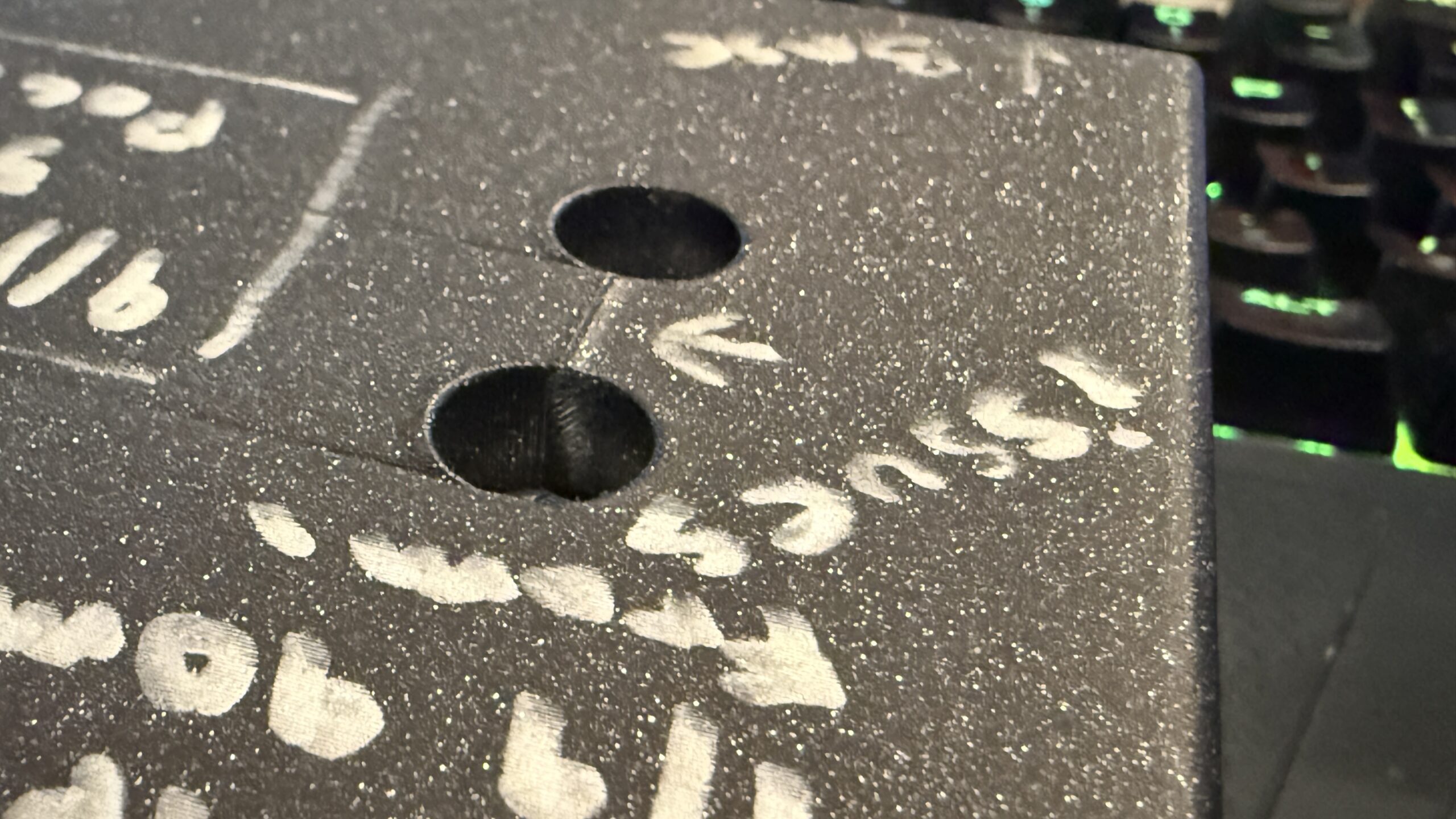

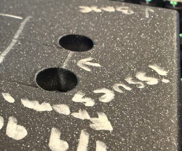

Very similar results when I flipped it 180° on it's X.  Seam, if that's what I'm dealing with, only appeared between the 2 Anderson connector mounts.
I've got @miroslav-h4 project printing now.  Fingers crossed.
Thanks for trying!

It's just about to start the 2nd Anderson mount.  I think you may have done it?  I can notice that it no longer pauses (and makes some adjustment) as the print head makes it run of the perimeter.  It's super linear, just as it was went it was printing below the mount.
Master, what can I take away from this?  Was the placement and Z rotation just some random values, I'm guessing not.  Looks pretty deliberate to the very untrained eye.

As mentioned you can paint the seam where ever you want, for example on an inside wall or try setting to random which will scatter it as dots.
