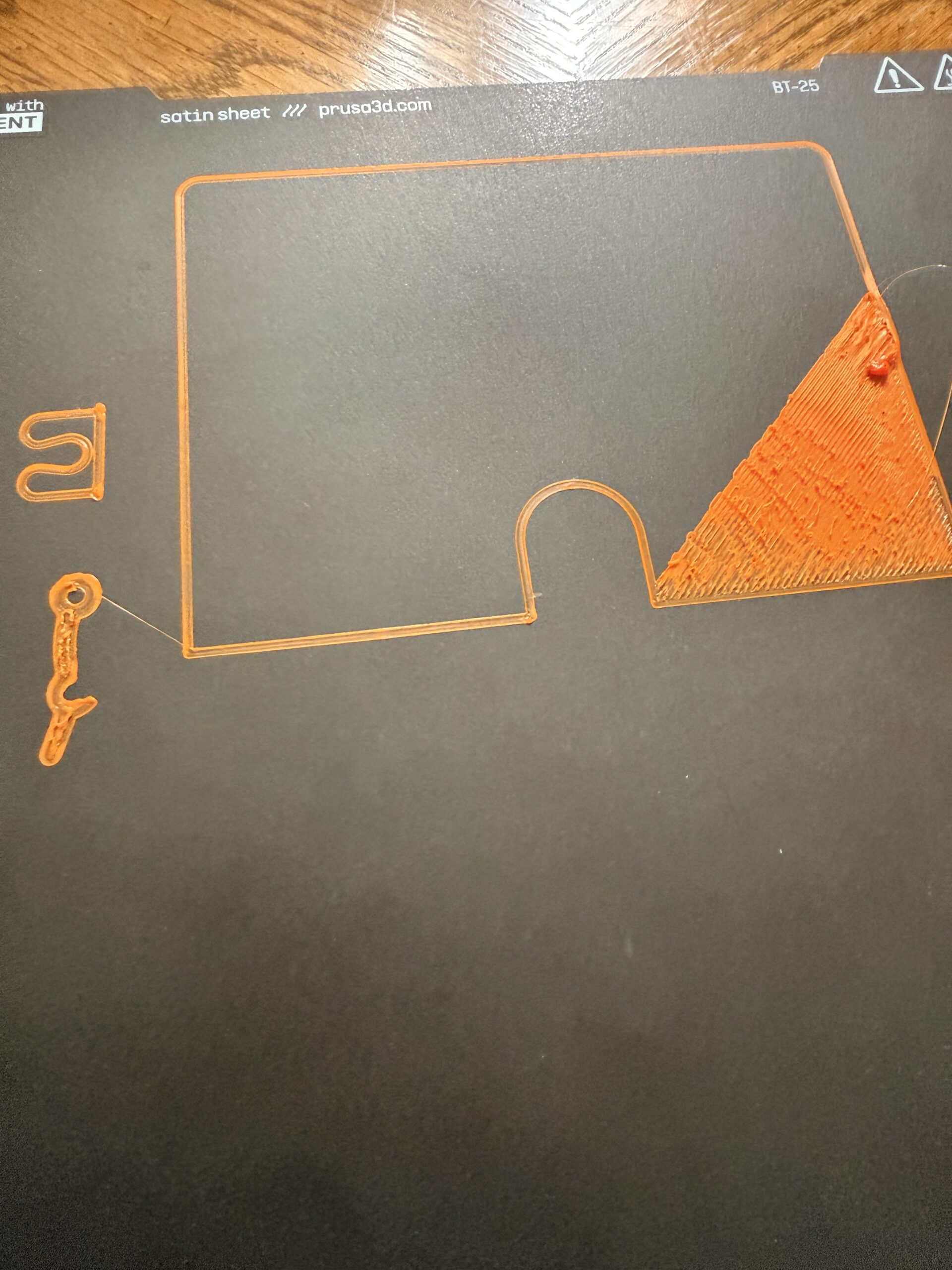

I was trying to print parts from this toolbox.  To save time I added the trays, latches, and holders all on to a single bed. But it looks like there are duplicate parts being printed plus the filament is stringy as if it is wet. (I swear I just dried it). I was printing in Prusament PETG. I've attached my .3mf file from the print if anyone cares to take a look.

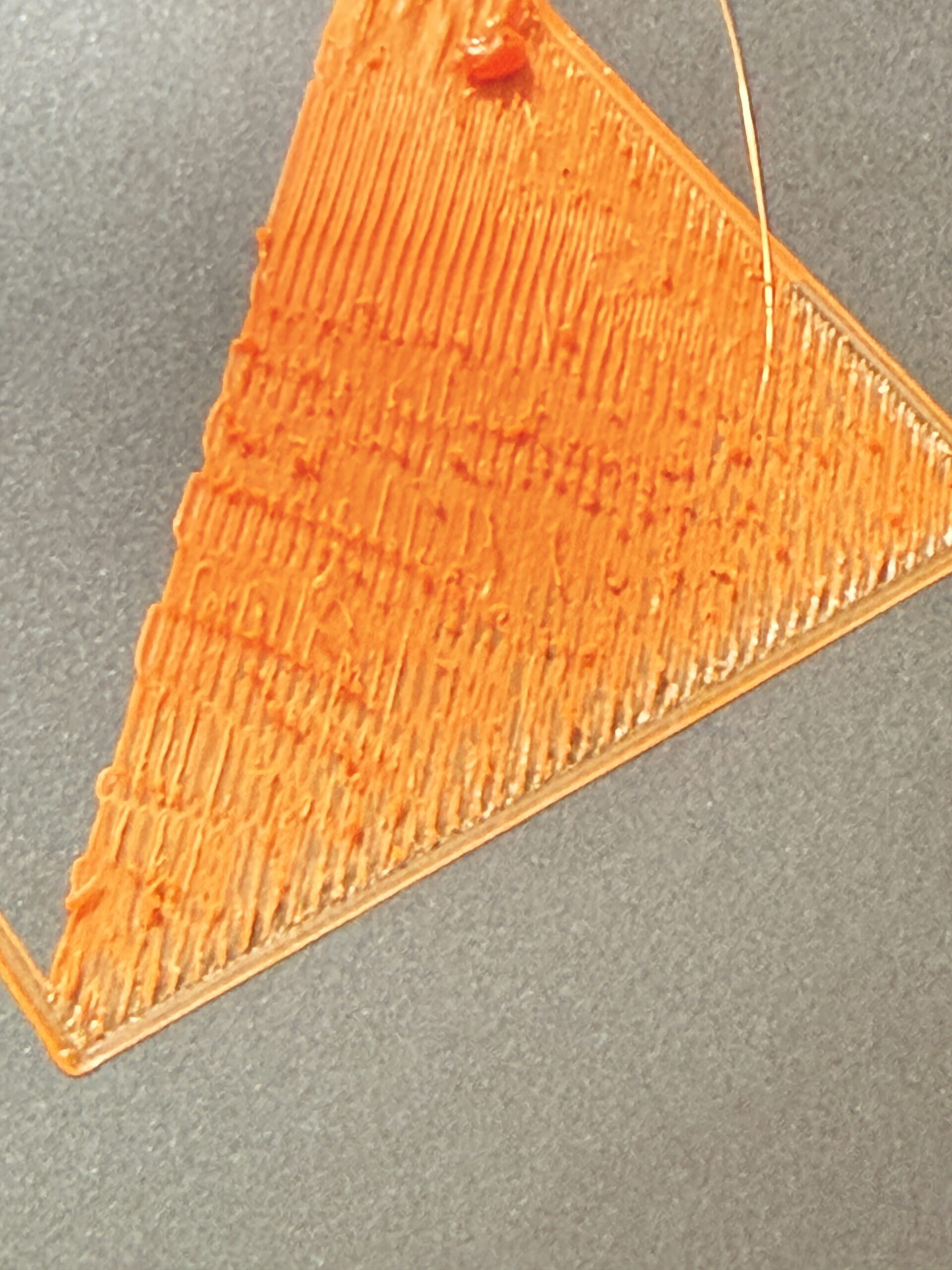

I tried it again. This time I cleaned the bed with soap & water and watched the first layer. It immediately went bad so I stopped the print. Can you see the glob and spikes in the triangular section? That is not right. Other than this the printer seem to run fine. No extra noises or weird movements.
Prusa Core One
Posted : 19/01/2026 9:25 pm
mnentwig
(@mnentwig)
RE: What happened with this print?
check the side of the nozzle facing the print, whether there is carbon buildup or any other material that doesn't belong there.
I wonder where the filament blob on the top right end of the triangular section comes from. This might have formed on the nozzle.
I'd do cold pull (with PLA filament as it's sticky), might be one of the channels in the CHT nozzle is clogged. Watch the end of the filament, it should show the internal structure of the nozzle.
Looks to me like the bed leveling was off, which can happen easily with PETG if there's still some crap hanging on the nozzle, or if you inadvertently leave the priming strip from the previous print on the sheet (ask me how I know…). The nozzle cleaning procedure doesn't seem to clean it properly.
I suggest you print one of these nozzle brushes ( https://www.printables.com/model/1284808) and clean the nozzle while it's heating up for the bed leveling. There are also a bunch of models for nozzle cleaners mounted to the steel sheet but I've not seen a need to try them.
Posted : 19/01/2026 10:12 pm
I just printed a benchy in PLA and it came out as good as previous benchys.
BUT i did find a huge blob of orange on the nozzle. I cleaned it with Scotch-Brite. Not sure if Scotch-Brite is available outside the US, but here is a link. https://www.scotch-brite.com/3M/en_US/p/d/b00042849/
