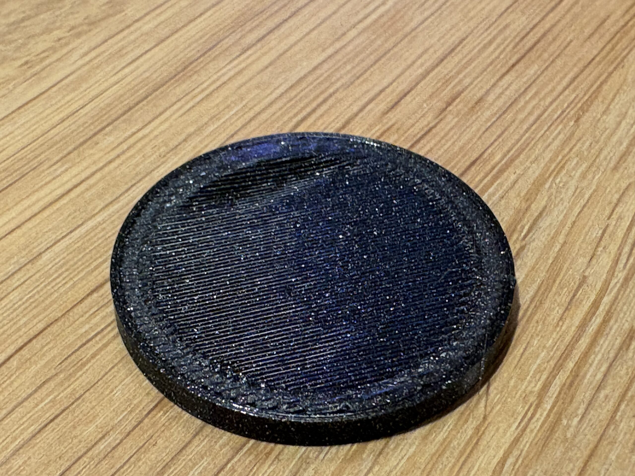

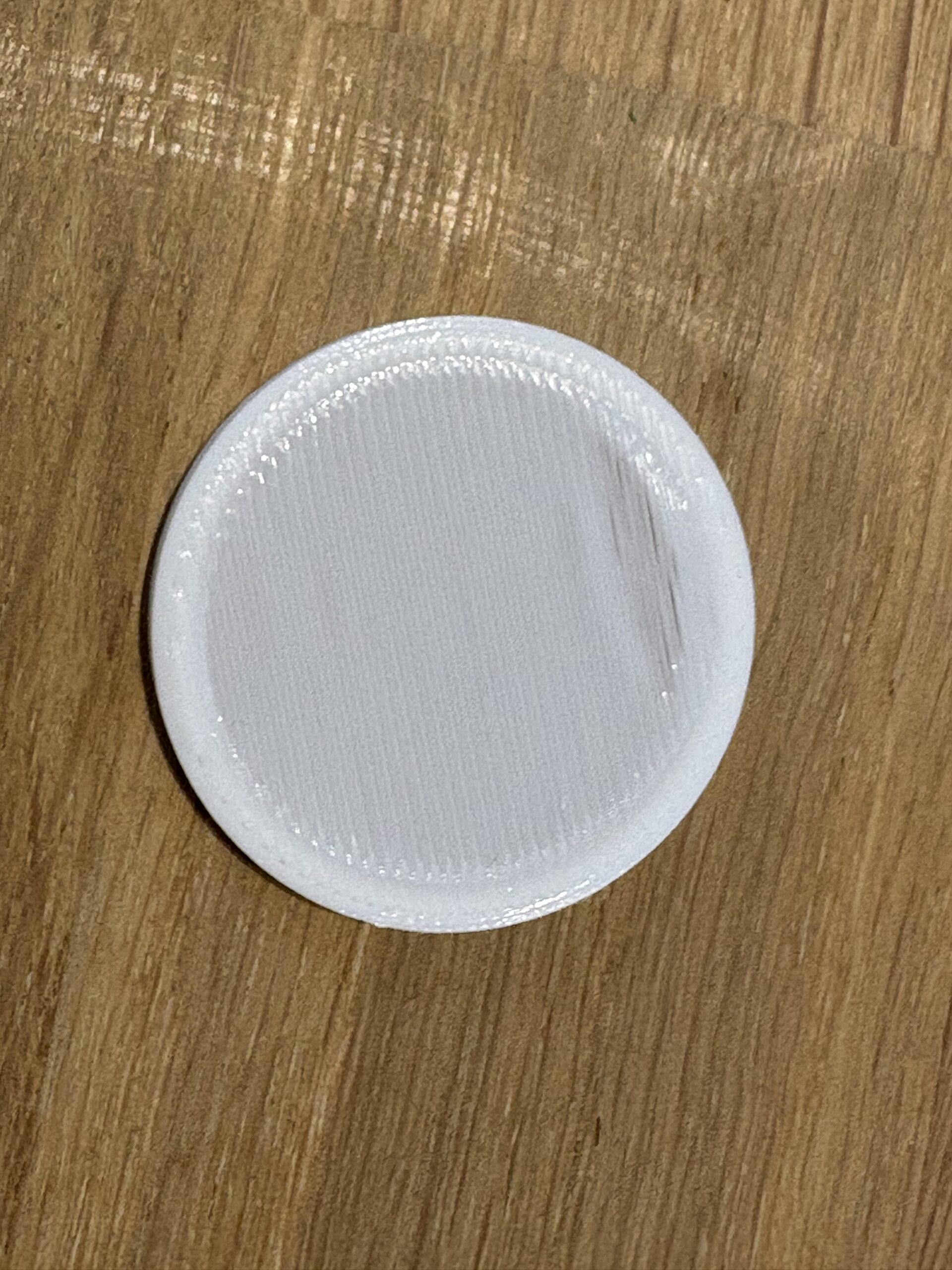

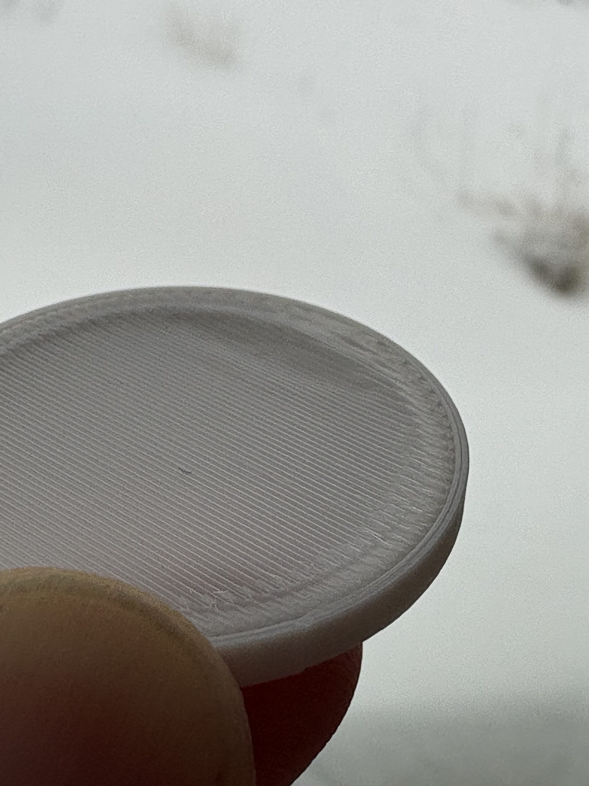

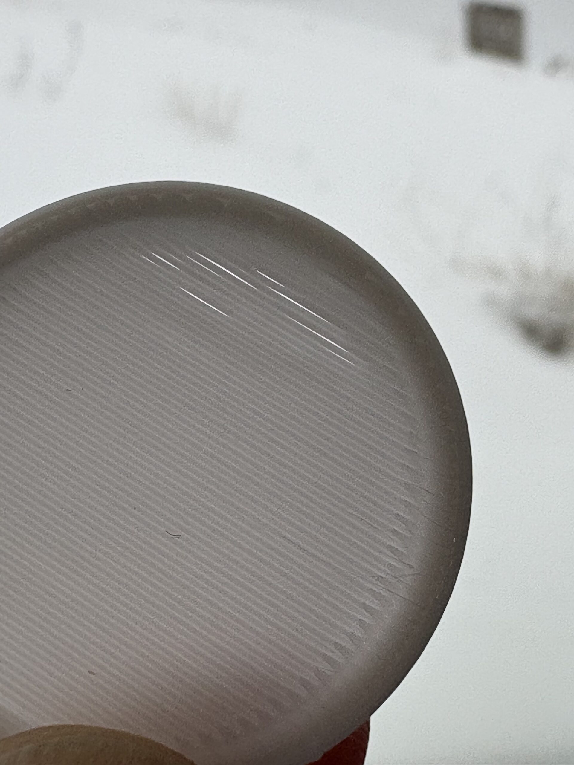

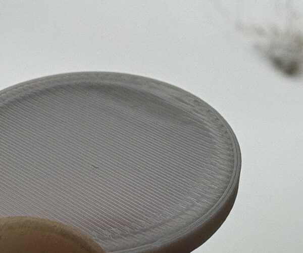

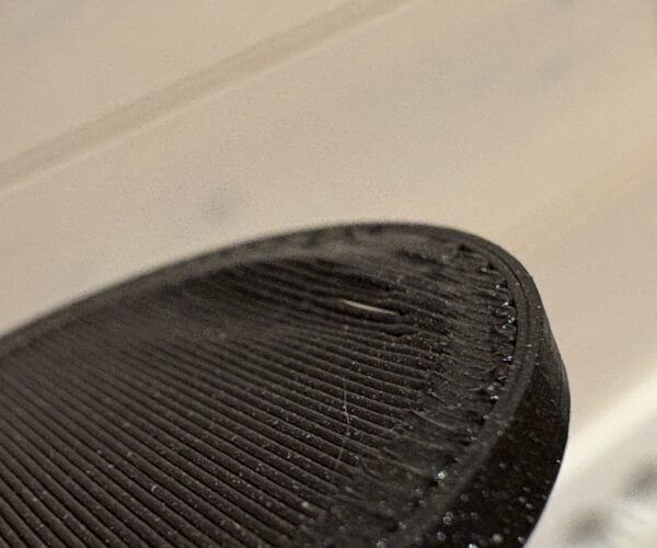

I am working on learning to create my own print profiles. This bridge test shows a consistent artefact that I don't seem to be able to get rid of, any ideas on what to try next is appreciated. The printer is a fairly standard Core One.
This test piece is intended to be harder that the others I have found in that it is just one single layer bridge of 0.2mm thickness.
Settings
Filament: Prusament PLA signal white, dried.
Nozzle: 0.4mm brass standard flow
Temperature: Tried 225-230. 230 seems a fraction better but not significant
Thick bridges: Seems like a total failure, keep off
Bridge speed: 18-27 mms/s, no speed completely remove artefacts.
Bridge flow ratio: 1.75-1.85, tried a lot of combinations of speed and lower/higher bridge flow ratio but higher values lead to more artefacts while lower lead to under extruded bridges not bonding.
Once tuned to above the test models all generate the same type of artefact just at the first strands of the bridge bulging. This artefact prints the same regardless of bridge shape, after the artefact the print settles to a good solid bridge. There are signs of under extrusion in these bulges but these disappear as the bridge becomes more stable later in the print.
The first things tried are bridge speed and bridge flow ratio. A higher bridge flow ratio does not remove the bulge, going higher than 1.9 the bulge increases. Bridge speed between 18 and 27 seems best, increasing speed does not remove the bulge, lowering speed does not remove the bulge.
I have tested a few different shapes and print orientations. The span of the bridge does not seem to affect the artefact, it always occur on all shapes at the first part of the bridge, then the print clears up. I have tried rectangular, square and round shapes, the artefact is the same on all of them. I have tried different print orientations and bridge angles, they make no difference.
Initially it seemed as if a 100% fan would move bridge extrusions and bond them into artefacts but once bridge flow ratio and speed was homed in changing fan speed between 70% and 100% does nothing.
One theory was that the plate temperature affected the bridge. However moving the bridge higher does nothing.
The next theory was that this is related to changes in volumetric flow. I aligned speed ton all slicer features to achieve the same actual volumetric flow in the whole test piece. This does not affect the artefact. A bridge speed of 18mm/s matches with a prints speed of 30mm/s for other slicer features.
Best so far
Temperature: 230
Thick bridges: keep off
Bridge speed: 18mms/s
Bridge flow ratio: 1.85
Matching speed for perimeters and infill 30mm/s, this matches volumetric flow rate across the print to remove influences from abrupt changes in flow.
The print starts the bridge from the side where the artefact appears, this is consistent. There is a slight bulge that then collapse to a dip with some under extrusion. After this the print recovers to a good bridge with good bonding and no bulges or sags.

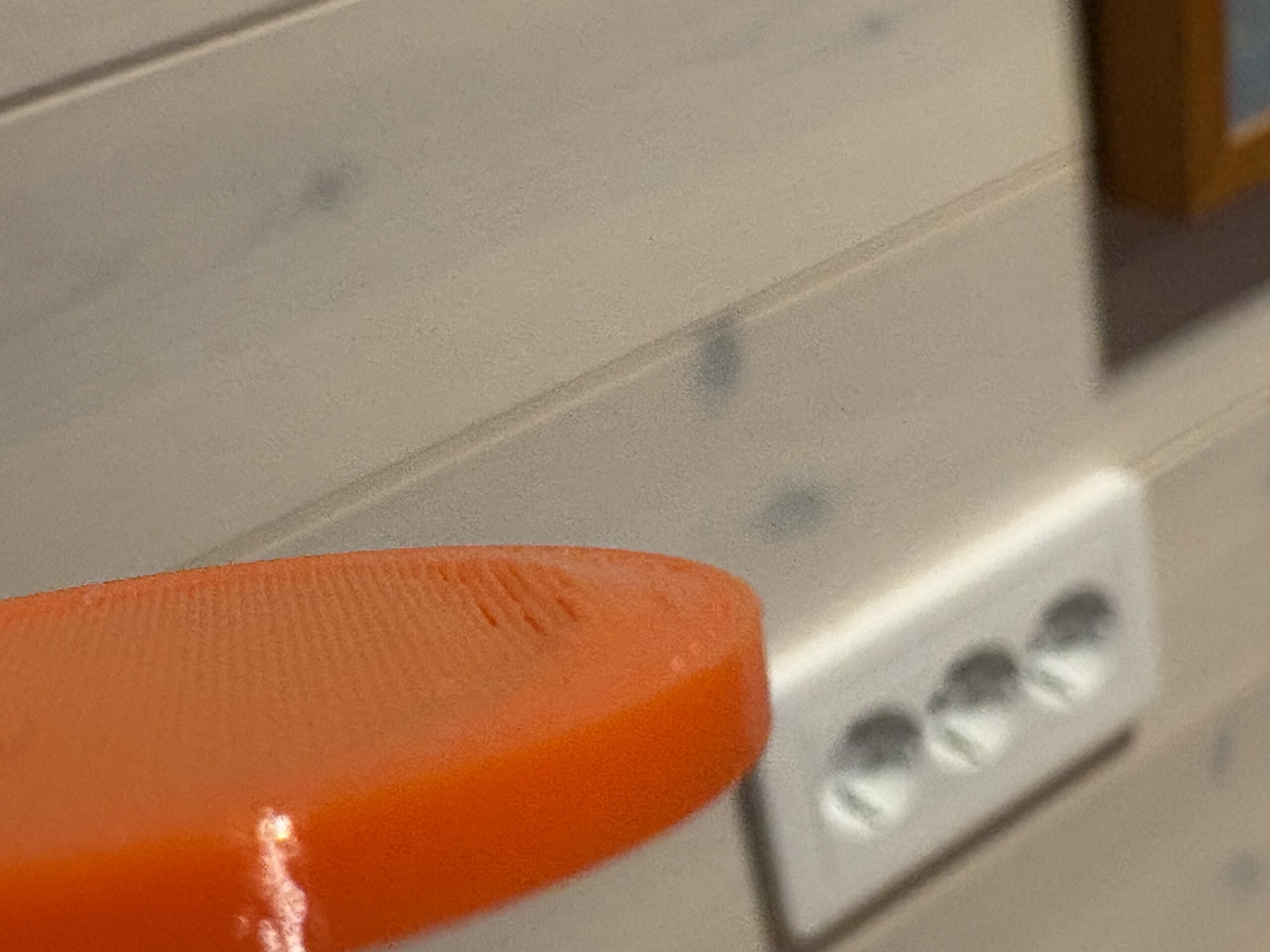

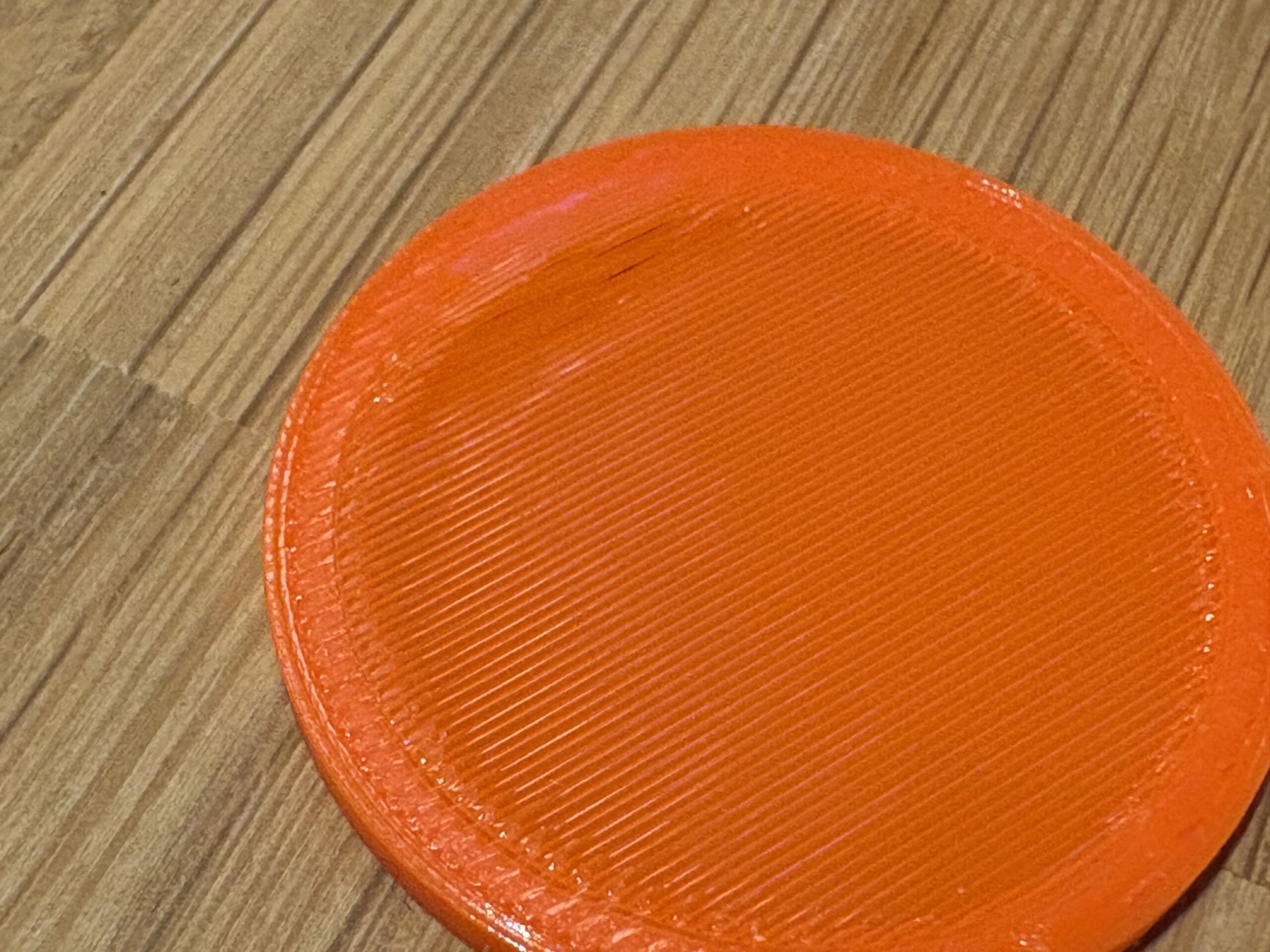

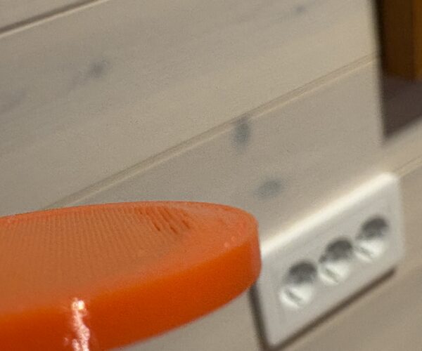

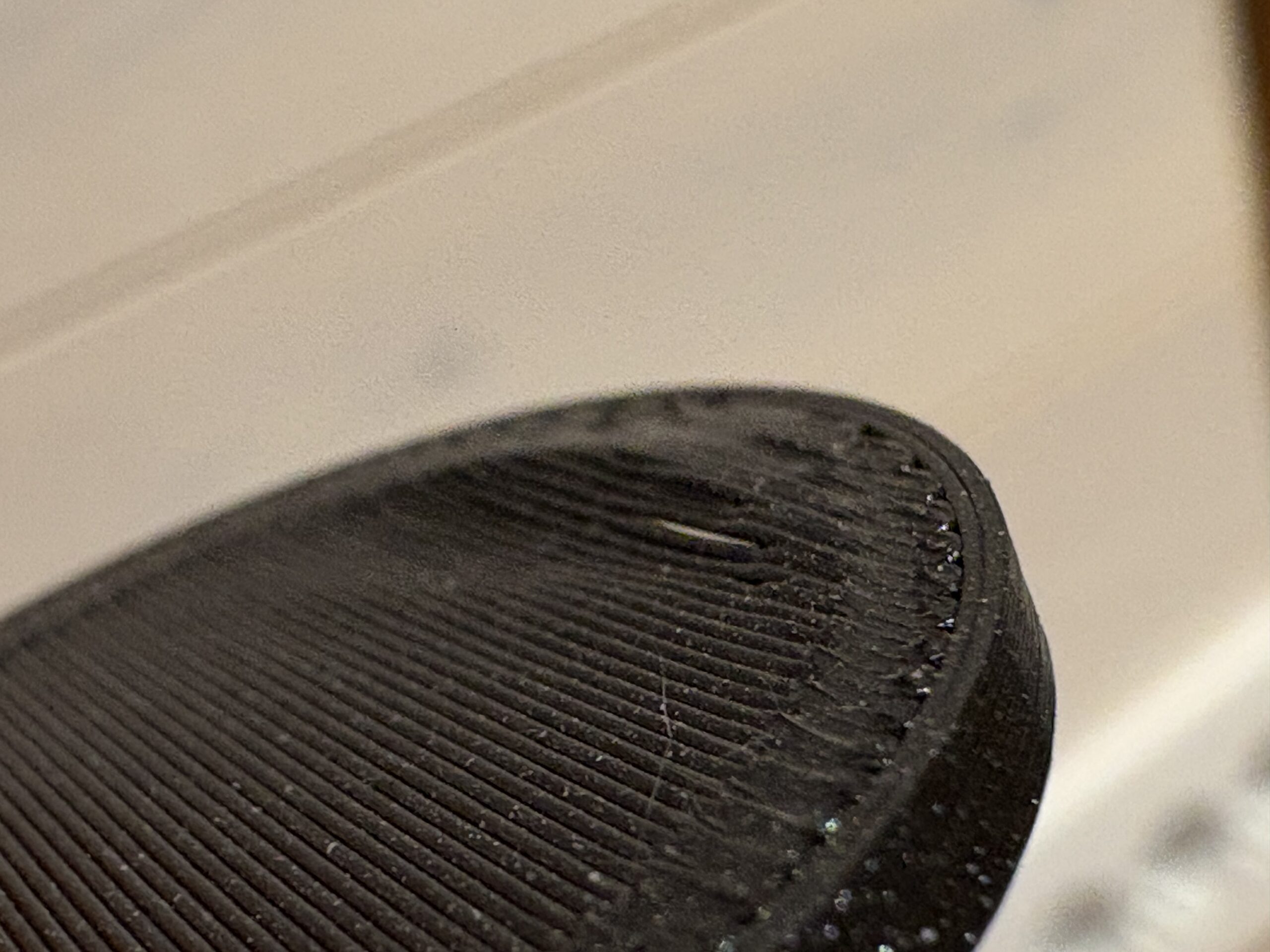

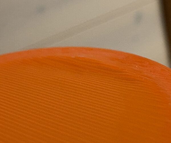

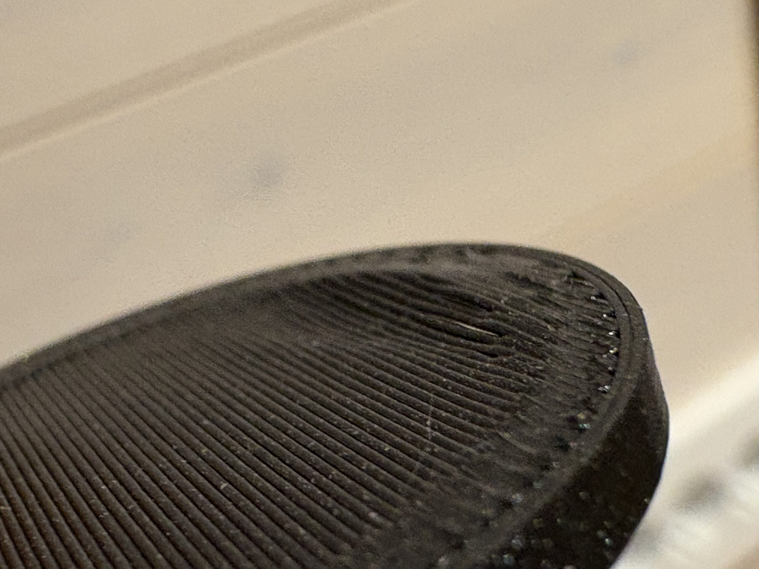

tried same gcode in prusament PLA orange and galaxy black. It is a bit hard to see in the picture but side by side comparison they are more or less identifikation, same shape and same gaps in the sag part. The orange has not been used for a while and was at 30% moisture before hitting the dryer, the galaxy black is never and more recently used. The white is most fresh and most recently used, none of that seems to matter though all 3 print fine and replicate the same artifacts.

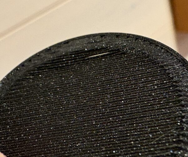

So, here's one after changing the flow to 175% and reducing the speed down to 13 mm/s. The lighting makes it look pretty bad, but it's way better than where I started. This is Buddy black PLA. It can have a lot of gloss but it's cheap and I use a lot of it.
A thought. There's a small contained area under the bridge. The air flow changes as the bridge is filled in. What's going on is almost certainly thermal and maybe that has something to do with it. You might try a taller ring or put ventilation holes in the side.
They sell some rather good thermal cameras these days. We use one at work and I was impressed by the resolution and close focus ability. More than I want to spend, but if I were in "research" mode, it would be cheap tool, under $300. https://thermalmaster.com/products/thermal-master-p3-pcb-master

Thank you. I have been considering airflow and cooling as well, it was an early suspect. I have tried different shapes and that does not alter anything but changes airflow, but maybe not enough. The thing that finally made me look elsewhere is that if I change the bridge angle making the printer start the bridge from another angle towards the bed the artifact stays in the same  first part of the bridge unchanged.
A thermal camera would be but limited use otherwise, I will look around if can rent or borrow one somewhere. I have another idea towards the same line of thought to split the shape into multiple bridges to see if it matters if the bridge starts towards the edge or if this also appears if the bridge starts further into the top where the bridge stabilizes on the current model.

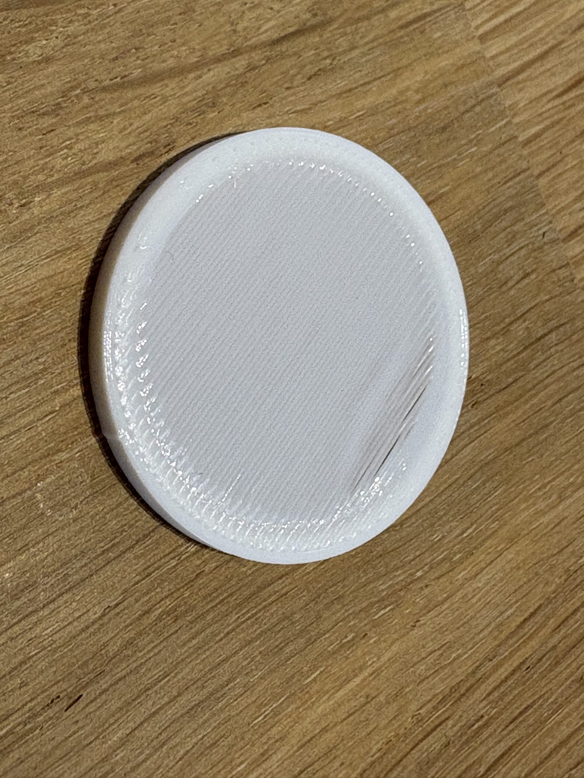

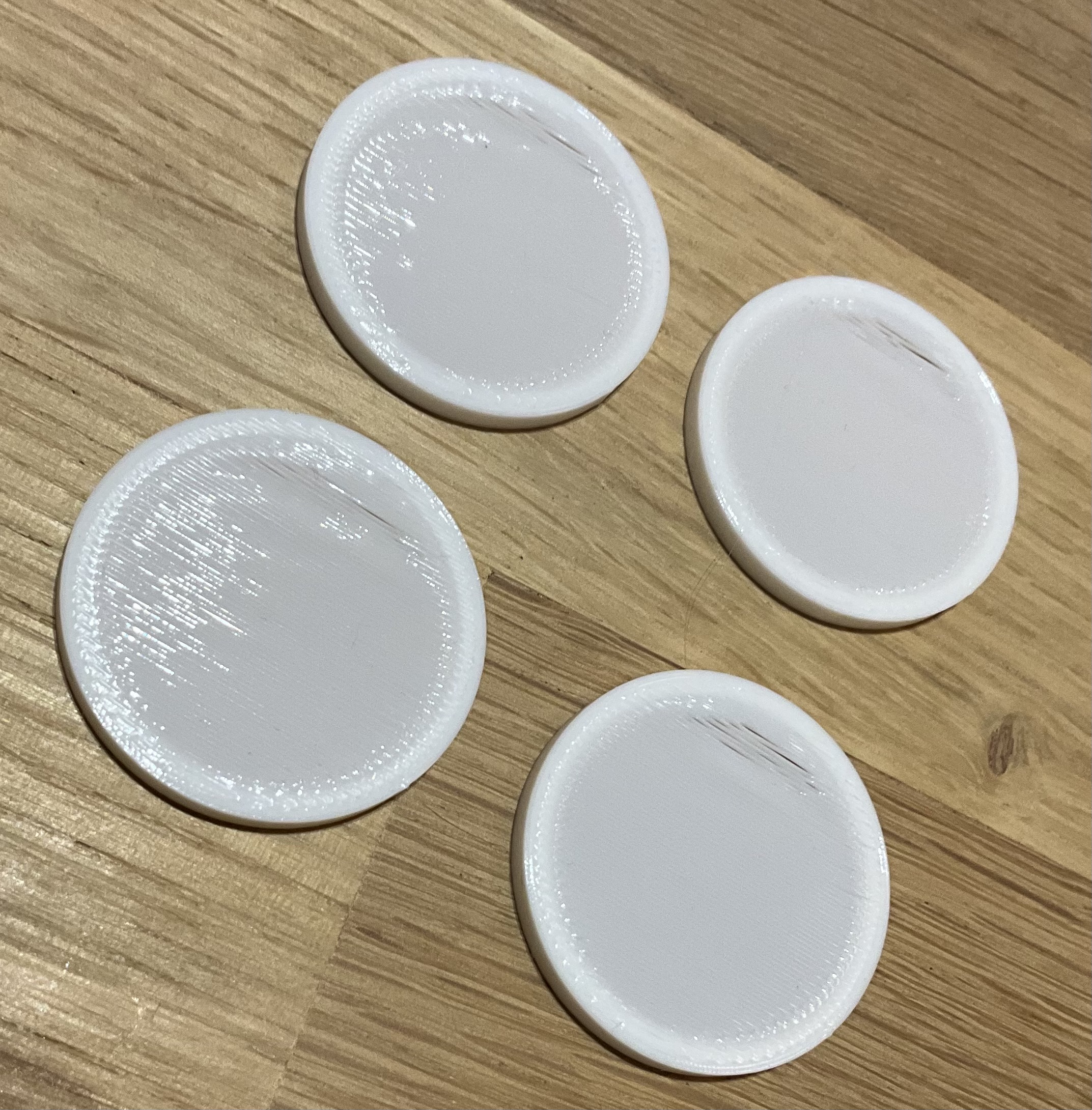

Yesterday I noted that the printer does a travel move with a z-hop and associated retraction just before the start of the bridge. To verify if the z-hop + retraction has some influence on this I disabled both setting z-hop height and ramp to zero and retraction length to zero.
The left piece is without z-hop and retraction, the right side is with the z-hop at default and 0.5mm retraction. This does not appear to have any impact on the bulge.

The bulge is winning so far, I tried a draft shield just to see if that would do anything, nope, still there, still the same.

Another data point- I made the part taller, with vent slots on the bottom. Didn't make much difference.
Posted : 12/02/2026 12:31 am
andhson
(@andhson)
Posted by: @conrad-2
I tried to make the part taller as well but without vent slots and found the same, it makes no difference.
yesterday I toyed with a slightly different layout of bridges by splitting the internals into segments. When the length of the bridges go down that masked the problem quite well but as soon as I make the bridges longer the pattern is back on all the internal bridges that start with a longer bridge segment, there is one that started to print at a tip and that masked the problem the same way as the shorter bridges. I also had some issues with the bridge anchors but I think that is a separate issue with my model which is still work in progress.
the idea with this model was to try to see if the problem occurs only on an outer edge or if it occurs the same on internal bridges, and it does seem to indicate that it does not matter if the bridge is at the far edge or somewhere else.
