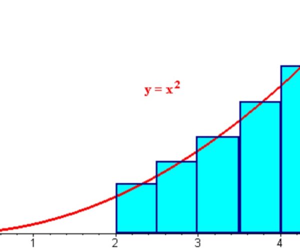

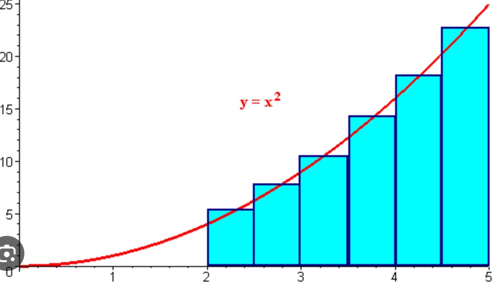

You are printing in layers. So when printing curved or sloped surfaces you are approximating that shape. By changing the layer height you get a better approximation and less of a stair step effect
This is a math example (integration) but it's the same thing
Posted : 17/01/2026 8:31 pm

Ah. It’s like a ADC in music. Converting analog to digital. Thanks
