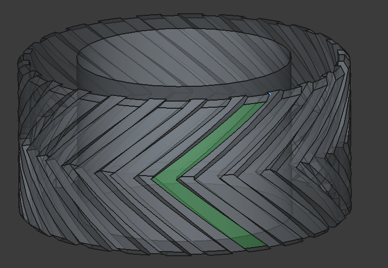

mnentwig
(@mnentwig)
RE: My experience printing Siraya Tech Flex TPU Air on a Core One
in CAD, looks fairly accurate:
Posted : 14/05/2026 1:44 pm
