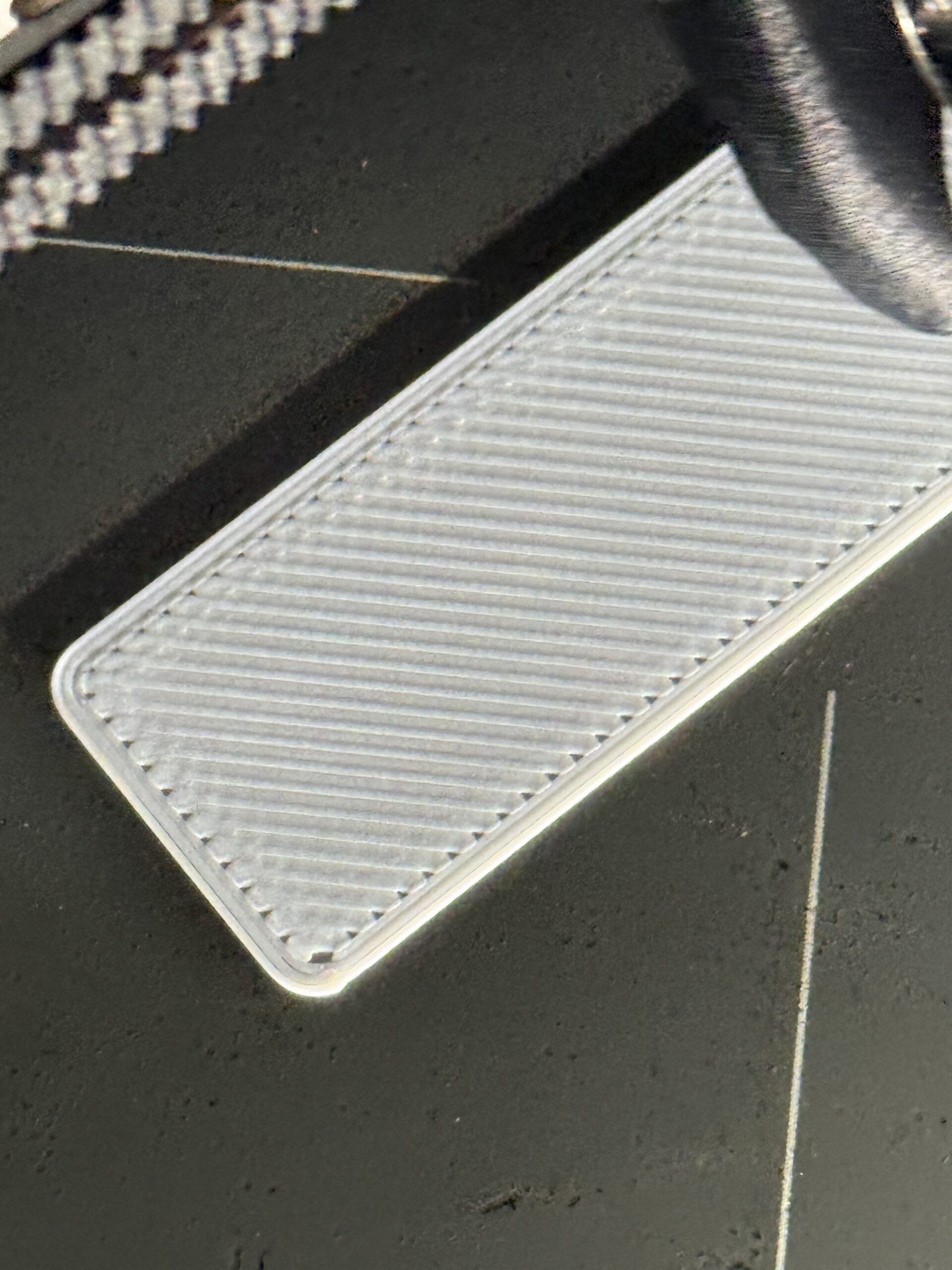

RE: Layer shift again?? This is getting frustrating
You might want to check the extrusion multiplier, e.g. via a thin-walled calibration cube. It might be too high for the material.
Too much plastic with nowhere to go, the head gets stuck eventually. But this is just generic advice, maybe someone else can spot "evidence" from the picture or confirm it doesn't look overextruded.
Another potential "gotcha" (according to what I've read) at the back of the print are overhangs that curl upwards when cooling, trapping the nozzle.
BTW, looking at the above picture (pin holes in the white part), my AI proposes to crank up infill/perimeters overlap from default 15 % to maybe 30 % 🙂

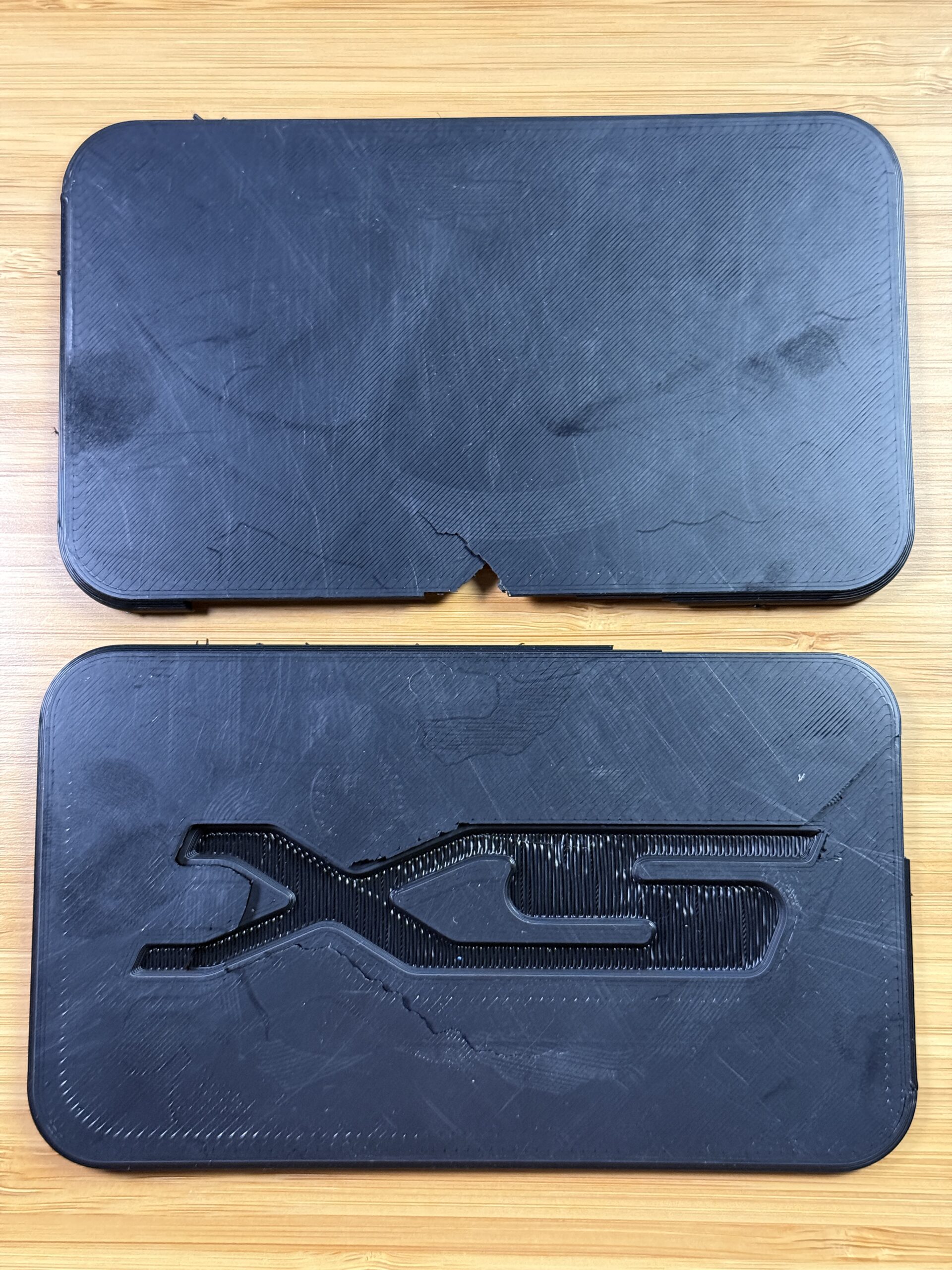

Please show us the underside of a failed print.

Azonic3D
(@azonic3d-2)
haha, yep that was one of its suggestions. Set to 25% on the white print:
Posted by: @mnentwig

Azonic3D
(@azonic3d-2)
@diem here is the underside of the failed part above. Don't mind the cracks, that was from ripping the shifted layers off

Azonic3D
(@azonic3d-2)
To clarify, the above black part, was with the 0.6mm ObXidian nozzle, with the default 0.40mm STRUCTURAL print profile.
