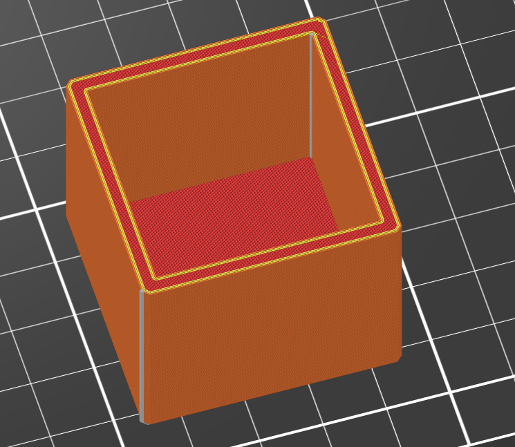

I printed a lid for a small drill index I created.  It's just a square box, with a few chamfers on the sides.  3mm wall thickness.  Printed with Overture PETG using a 0.25mm brass nozzle.  One of the interior vertical walls have little blobs and things sticking out.  The junk interferes with using it as a lid, so I had to remove some of it.  Why just one interior wall, out of 4, and perfect exterior walls?  It's a beautiful print, besides that one wall.  I'll package up the 3mf shortly.  Here's the interior view.  I put the part on it's side, to take advantage of the lighting.
Any suggestions would be most welcome.  This is the cap that covers the stub machine drills.

Any idea why there's crud on the inner wall?  Here's my original index on the left, printed with a 0.4mm nozzle.  The cap, which has an inner wall with zits, in the middle.  Finally, the reprinted index with bigger font, so I can read the drill sizes.
The cap is also printed using a 0.25 nozzle, since I was printing the legend "Metric Stub Drills" and "1.0mm - 2.0mm".  Those letters did not come out well.  I need to use a bold font, and a little larger.  I have already edited my CAD file.  Need to print it, but would like to know if there are any changes that should help in the slicer.
The font is 2.5mm, and not bold.  The filament has smeared inwards, maybe elephant foot.  There are supposed to be decimal points and a hyphen...  The slicer output looks fine, but the print does not.

Because you asked the wrong question - changing to a larger nozzle will greatly reduce the overpressure problems at the seam and if they don't go away we will return to the stock 'Dry your filament' answer.

No sir, I asked a perfectly valid question.  If the pressure advance is incorrect for the nozzle size, then that should be addressed, if it's a bad preset.  I posted my 3mf, for that very reason.
A fine nozzle was used because of the text size, since the text won't print correctly with a coarse nozzle.  Tried that...  Had to go to a slightly larger font, and a bold font to get it to work at all.  Knew one trade off was print time and accepted that.  I've printed small objects with the fine nozzle and haven't seen this artifact before.
The filament was directly connected from my PrintDry unit, through a teflon tube into the Core 1+.  The dryer temperature is set to 65C.  The PETG is stored in containers with 0.25kg of quite dry desiccant.  (Not 0.5gm, but 250 grams of desiccant.)  It's not wet filament.
Well at least I got a clue what it might be.  Not that helpful, but a clue.  Sorry to bother you sir.  Seems like asking questions on a Prusa forum isn't a very good way to get decent help these days.  It used to be.

Thanks for the 3mf. If you turn on Travel in the preview, you see extensive travel from one side to the other, which may or may not coincide with where you see the zits but that has been the cause of "internal zits" issues for me in the past.
If you go to Print Settings>Layers and Perimeters>Quality and turn on Avoid crossing perimeters, those travel lines disappear (and hopefully the zits).
Caveat: Apparently Avoid crossing perimeters may cause lawyer shifts. I have rarely seen that myself but you may have to pick your poison.

Sorry, the forum being the forum again… Was unable to add photos or edit my post...
Original Settings:
With Avoid crossing Perimeters:

Thank you so much for showing this!  Never understood why the head moved around so much.  Thought that there likely were more "economical" moves.  It's a tough general problem to solve (slicing).  Excellent choice of graphics to show the possible issue.
