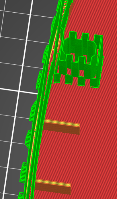

260226 Questions Filament support structures englThe 3D object is a mounting bracket for the climate control unit in a Mercedes Benz Vito. The original bracket had to be replaced due to modification work.
To print the device’s control opening, I am using painted‑on support structures.
I am working with the Prusa CoreOne+ printer (upgraded from the MK4S) with a 0.4 mm nozzle.
Filament: Prusament PETG Anthracite Gray.
The printed structures themselves come out clean, with no stringing or other defects. Unfortunately, the support structures do not.
Please see more details in the appendix.

It's hard to see in the screenshot and photos how the support structures actually look, where they are anchored, and how they meet the bridges that need to be supported. Could you share your .3mf file please? If you want to upload it as an attachment, you will need to Zip it since the forum unfortunately does not allow .3mf attachments.

Ich habe weitere Versuche gemacht. Die Stützen stehen auf organisch. Wenn ich mir die Layer ansehe, verlaufen diese auch in Längsrichtung
wie der Ausschnitt Bild 1.

I tried that. The supports are set to organic. When I look at the layers, they also run lengthwise, just like in the first screenshot.

Yes, you need to dry your filament.  That measurement of the humidity in the chamber isn't telling you anything about the moisture level in the filament, particularly a few layers deep on the spool.
