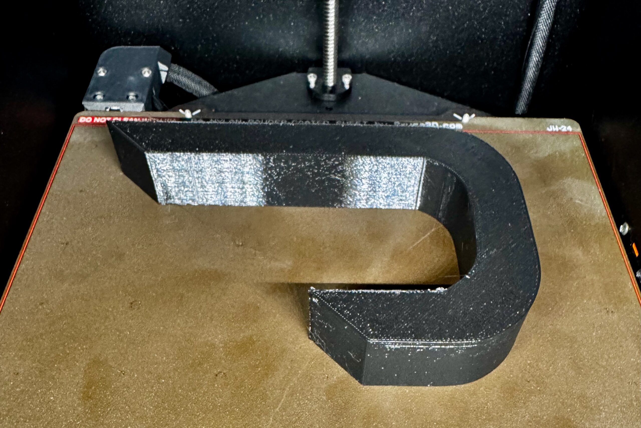

Just printed some smaller objects (80x20mm). It's crazy strong yet flexible. The interlayer adhesion so far is really good. Surface is very glossy, smooth and slightly slippery compared to what I'm used to with the PA-CF filaments which are matte and fuzzy. The nice thing about this filament is that is comes in a multitude of colors as long as they are all black.
Nozzle 0.6mm Diamondback, 0.2mm layers, 290C nozzle, 100C bed, minimal cooling fan only after 4th layer.
Generic PEI Textured Sheet
  • No brim, it warped off the bed (as expected).
  • Printed with 5mm brim, successful print
  • Printed with Magigoo PA, no brim, successful print.
Next I'll do a large print with sharp corners that covers most of a Prusa PA Sheet.
Posted : 13/09/2025 2:00 am
OK, this is my new favorite filament. It's insanely strong and prints as easily as PETG once the temps are dialed in. Only negative is it doesn't come in other colors but then for an "engineering" filament I suppose color is not important. This was printed on a Prusa Nylon sheet

Before I do that, I need more information. What are you printing? What size/type nozzle are you using? What type of print sheet?
If you want to start with something generic then, for a HF0.4mm nozzle: 250C nozzle, 70C bed, 19 mm^3/s max volumetric speed, 1.016 extrusion multiplier and 0.38% XY and Z shrinkage. The only thing really that you can use across all prints is the shrinkage. Everything else really depends on what you are printing and with what kind of nozzle.
If you want to attach your zipped 3MF I can tweak the settings for you.
