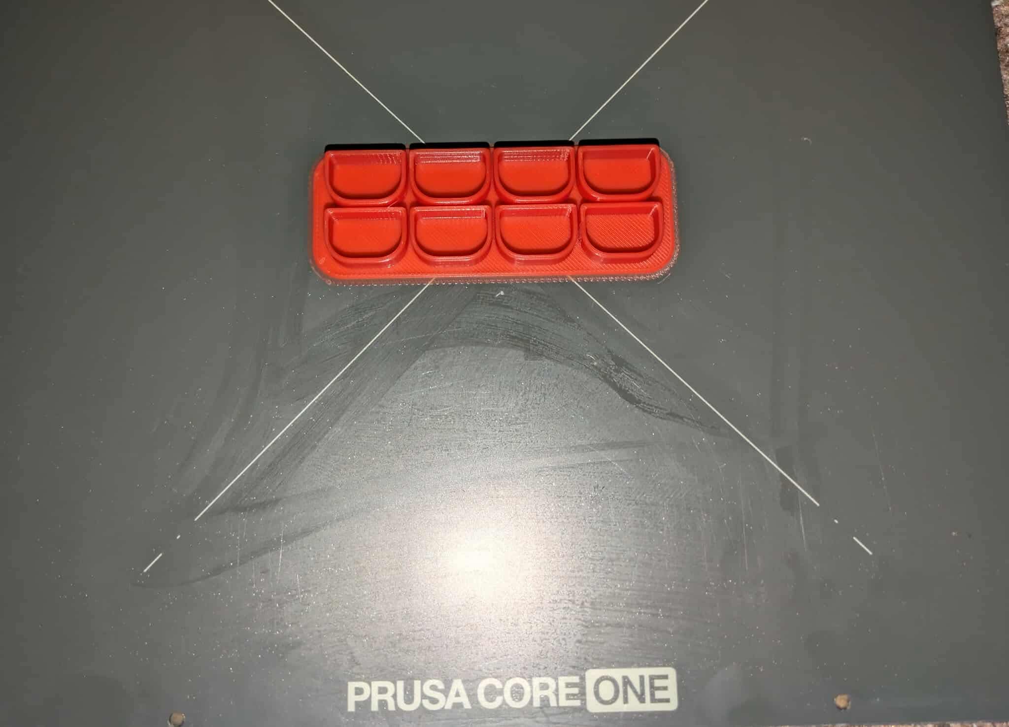

I’m having issues with the first layer. After printing (see pic) it’s almost like the brim is turned on or supports which is definitely not. What else could be causing this? I’ve tried turning down the speed.
Posted : 08/07/2025 3:55 pm

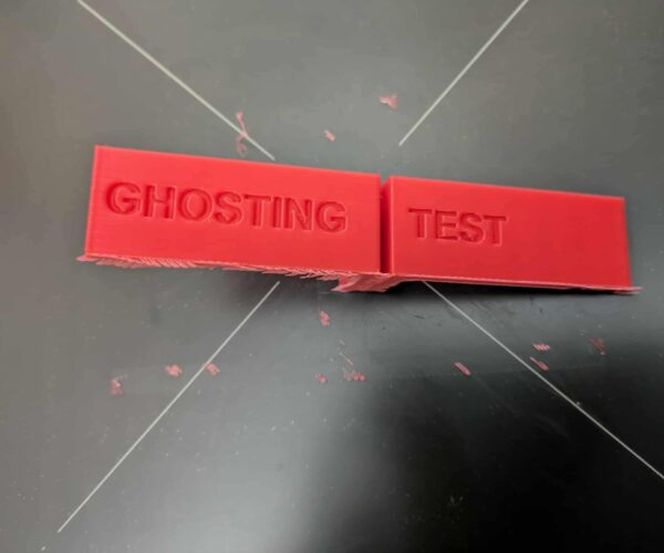

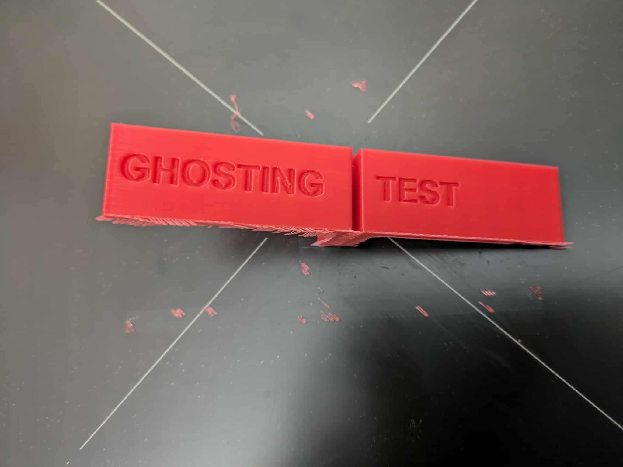

More apparent on this picture, printing in PETG on a smooth plate.
Posted : 08/07/2025 4:29 pm

RE: First layer problems?
Looks like you have a raft below the print. By default it is usually turned off. For the "ghosting test", if necessary, use a brim instead. Its adhesion surface towards the bed is small. Alternatively you can model so called mickey mouse ears to ends and corners of parts that tend to warp upwards.
For PETG the smooth plate is not ideal. Using glue to limit adhesion is mandatory on it. The first picture shows a high adhesion. Yet you do not have to use that much glue. Nowadays, the satin-sheet is a nice allrounder for printing on PETG, PLA and other filaments. see prusa's material-guide table. On the satin sheet you do not need any glue for PETG at all. Degrease it with plain dish-soap and hot water. If you stay away from the sheet with your fingers, you can print many dozens of pieces without any cleaning or glueing in between.
For scraping I can recommend a ceran-board scraper. Round the corners a little and use it exclusively for the 3D-printing sheets.
Thanks, just to confirm I don’t use a lot of glue and have been printing with PETG for over a month, successfully. All of a sudden this happened on the last few prints. I use dish soap and warm water to the clean the smooth plate too.  Raft was definitely not turned on neither brim or supports.
I can’t understand how it’s just started when I’ve not changed any settings.
I had a very similar problem using the Prusa textured steel plate… printed totally fine for a month and then started having first layer issues on very fine printed items suddenly. Did everything you did, and the solution was build plate glue.
Build plate glue….Nano Polymer Adhesive…
 It sure if anyone mentioned this, but Prusa indicates you should be using a “release agent” on the smooth PEI sheet with PETG… or it could damage the plate.
I think what they mean by release agent is really adhesive… by putting a thin layer of adhesive on it, it allows it not to damage the PEI sheet.
