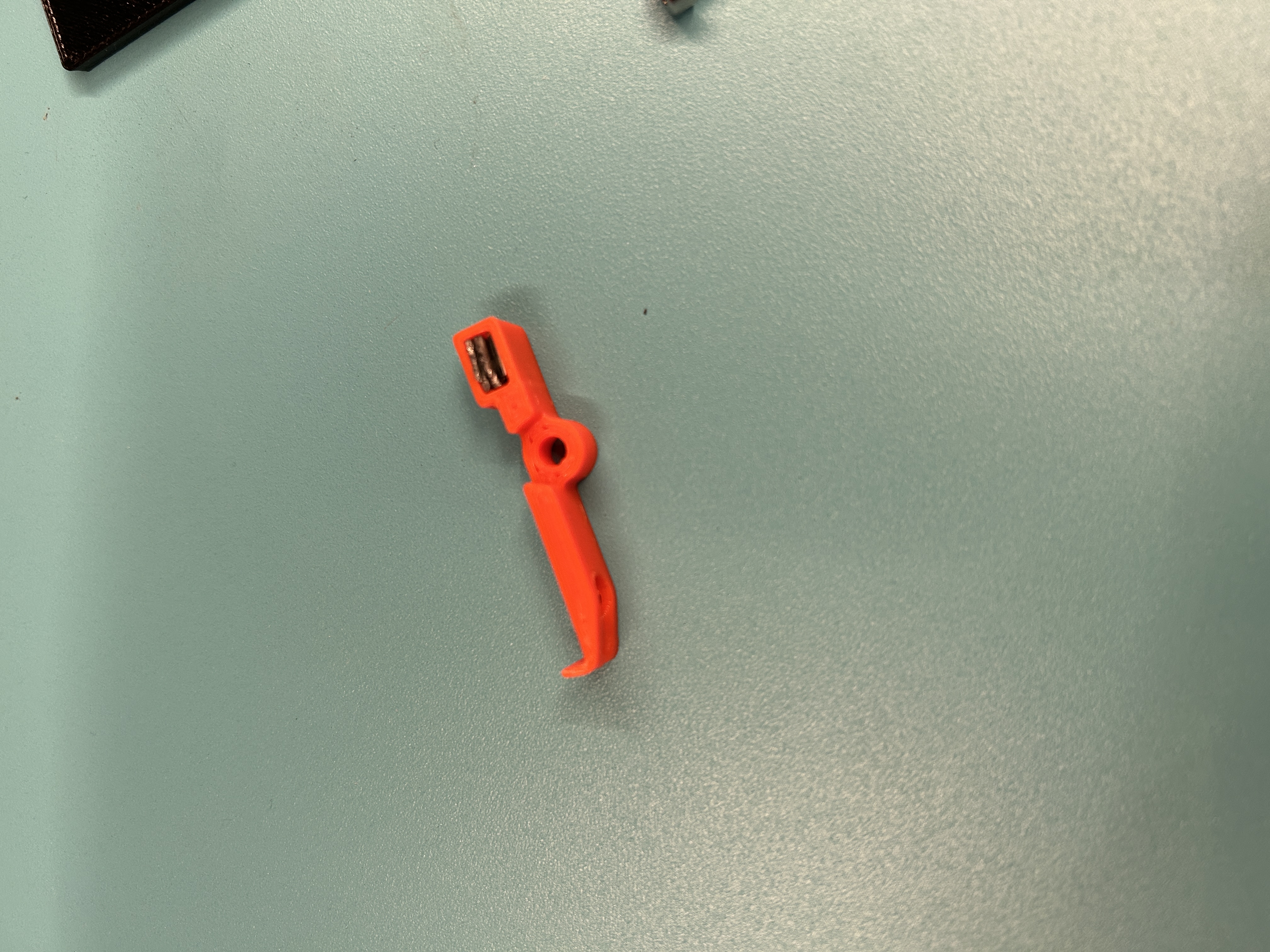

If I switch my other MK4s to core one I'm probably going to bite the bullet and do the filament sensor mods and not just the bogie parts. The bogie parts, IMHO are a must have if you print with tpu at lot.
The filament sensor mod (with magnets instead of spring) is easy enough and makes a lot of sense. Not sure why Prusa doesn't use this approach. The bogie mod is not just for TPU but I've found better overall for various extruder gear issues I was having.

Hi everybody. Regarding the sensor mods.
I modded both sensors.
The mod for the side filament sensor works like a charm and it‘s done much easier than expected. I printed a lever with a slightly bigger „magnet“ hole. When testing with a spare one I noticed that the weight of the lower magnet is basically enough to work properly. So I left the upper magnet but put some pieces of lead into the hole.
I used only one magnet for the mod on the nextruder sensor. 2magnets as suggested had to much resistance in my opinion. So I added only one opposing magnet but put a small piece 2mm plastic behind. That way the sensor opens reliably,but now my setup is soft enough to push the Prusa tpu all the way through without disableing sensors or disassemble the tube
