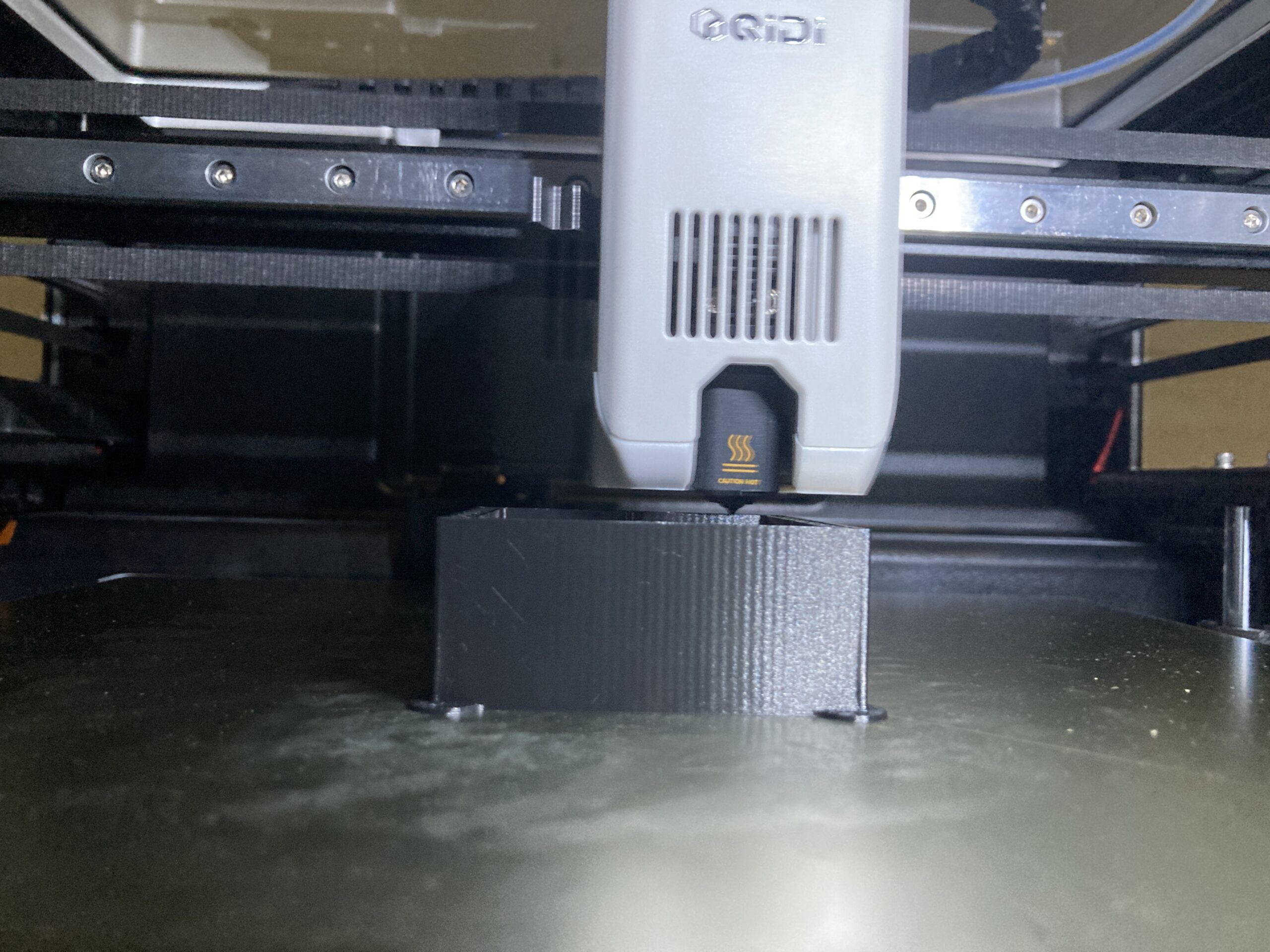

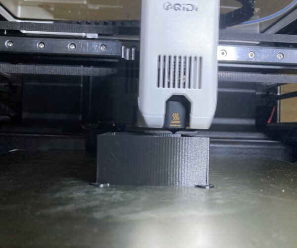

Interesting discovery for me today while running a PA calibration on our Qidi Q2 at work...I see prominent belt ripple along the pure X movements. 🤔. Granted this isn't a VFA test, but so far I'd seen only very smooth walls from this printer.
-J
I think Qidi use speed exclusion zones in their slicer profiles to avoid belt ripple problem speeds - the PA test might have overridden that?
That wouldn't surprise me. I was calibrating some FR PC/ABS, and had slowed the MVF to 6, to try and improve quality. It had printed the ezPC beautifully, but needed some work with the FR blend. If I'm able to get the fan settings tuned and get the corner details looking right, I'll speed it back up. It does support the claim that a big piece of this belt ripple problem is connected to speed.
