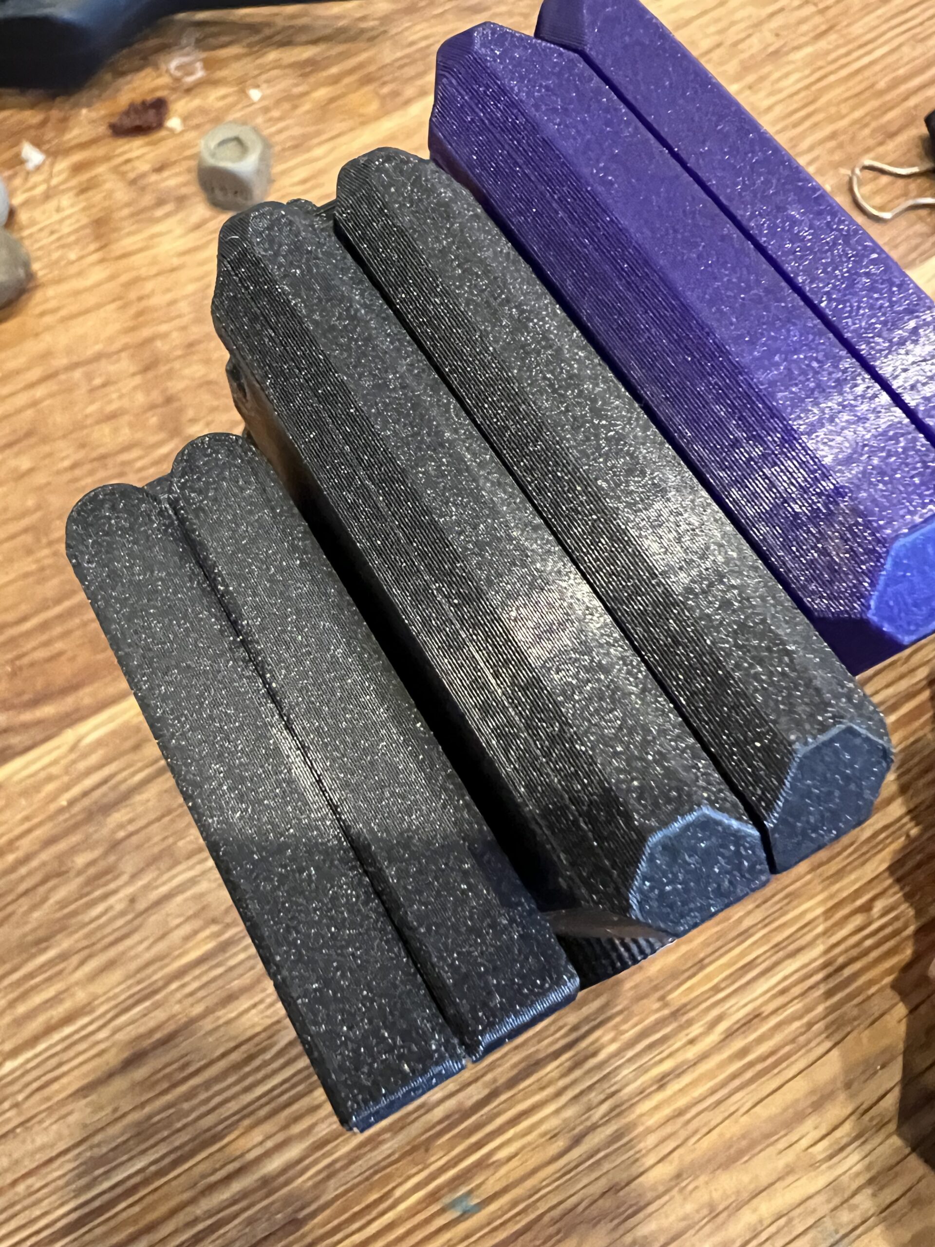

Just got my Core 1 on Monday, so I haven't had much time to test it out, but I can see similar artifacts, maybe not as pronounced but it's hard to compare given differences in lighting and shininess of the print.  The only thing I have done to the printer is adjust the belt tension as it arrived with one belt around 100 Hz and the other audibly higher but off scale.  I printed out an octagon (PLA, 0.2 height, structural profile) so I can see the effect of motion direction.  Not much difference between the x and y, but moving at 45° to the axis increase the frequency of the artifacts by 2x which makes sense since one of the steppers will be running at 2x the speed.  Like posted earlier the period is around 2mm when traveling along one of the primary axis.  I'm interested to try it again with an angle closer to 22° and see if I can see a beat frequency between the two separate drives.
Along the x or y axis (sorry lost track of the orientation)
45° relative to the x or y axis:
I tried to measure the height of the ripple with a feeler gauge.  It is certainly less than 10µm peak to valley, but would need a better setup to get a more accurate measurement.  I can't really feel the ripple with my finger.  Since I print mostly structural prints this isn't really a big issue for me personally but more interested in figuring out the cause.
Yep this is the same artifacts I am witnessing just less pronounced. Even down to the 45 degrees double frequency. Thank you for printing this, it is very useful representation

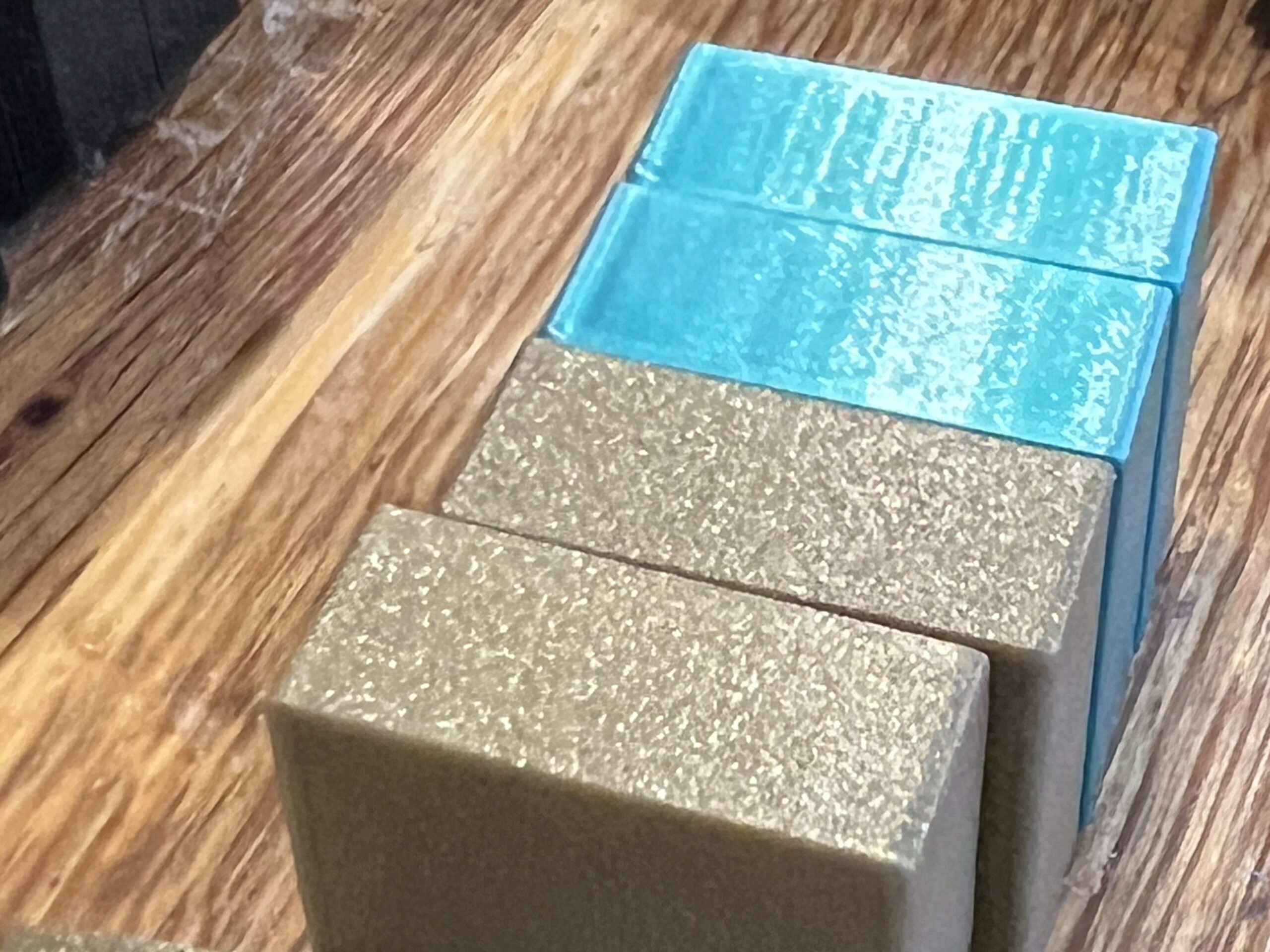

I thought I’d look back over the past weeks prints
I've never noticed the VFAs, they’re not that noticeable and difficult to photograph
what’s interesting is that it appears on the same model with the same filament but disappears with a different slicer profile
Posted : 22/03/2025 6:00 pm

I’ve been using the standard 0.15 speed and structural and 0.2 speed and structural.
because I didn’t notice any differences on print quality I’d opted for 0.2 speed as my default go to.
unfortunately with those I photographed above I don’t know which is which. But what’s is definitely true is I have models that exhibit zero VFAs purely because of the slicing profile that was used.
I will report back when I figure out which on!
it’s the slicing profile that’s results in the filament being more matt finish.
Posted : 22/03/2025 6:13 pm

Here’s an example of the 0.2 Speed profile on the left with No artefacts and an overall much nicer print
On the right is the 0.15 Structural profile with the VFAs and even the top surface is rough to the touch and shows many artifacts
Posted : 22/03/2025 9:21 pm
