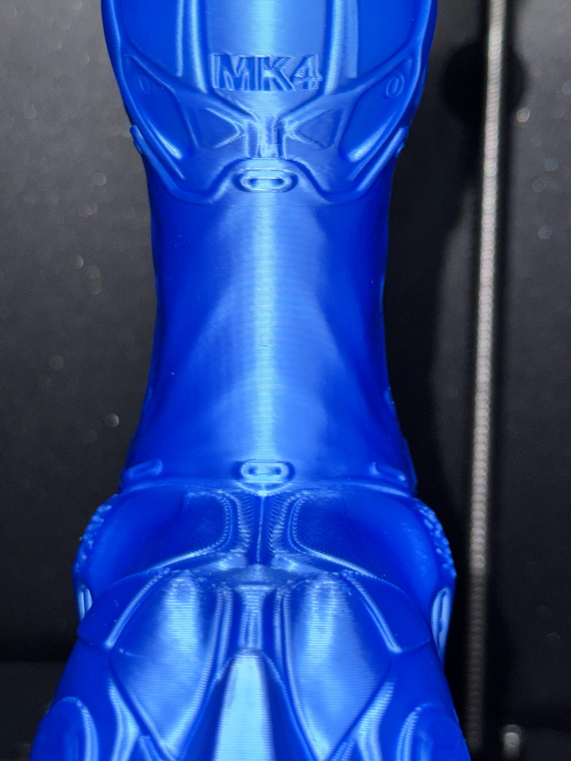

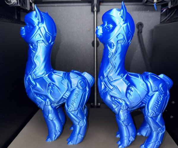

The gcode based Robo Alpaca printed flawlessly using Overture Blue Silk PLA.  In fact, the print quality is astoundingly good. Without supports it almost printed the belly perfectly as well.  ...but VFA is what I was looking for, and it is not apparent on that print.
However, it's likely a tweeted gcode by Prusa, so I got the STL, sliced it, and I'm printing another one that will not be tweaked.  I will get pictures of the two from various directions and post them later.
I will also run the VFA test from a gcode based model and post that information / picture here as well.
The 6.3.4-RC firmware did show minor improvements in VFA prior to tensioning the belts using the newer webapp and different belt locations.
To reiterate: I did not have any issues using the webapp or performing the updated belt procedure. Of course, if I had used German based instructions then the procedure may been more detailed / specific, and I wouldn't have suffered from a lack of self-confidence like I  did with the English instructions! 😉 Bahaahhaahaha

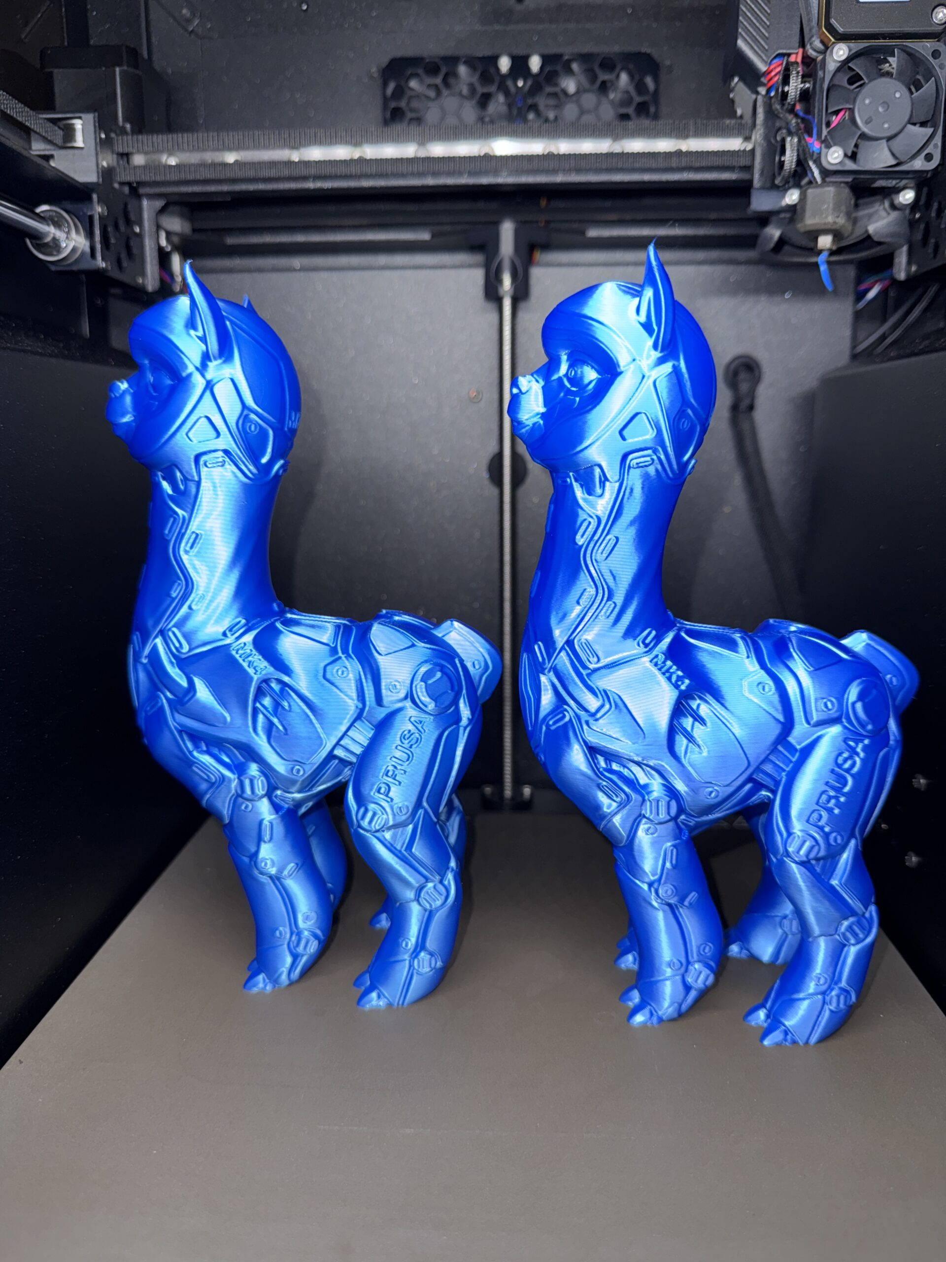

Printing of Robo, alpaca to test VFA with new belt and firmware… VFA test next:
Post new belt adjustment procedure and firmware 6.3.4 Gcode Robo Alpaca on right, sliced Robo Alpaca on left, testing of new firmware and belt procedure

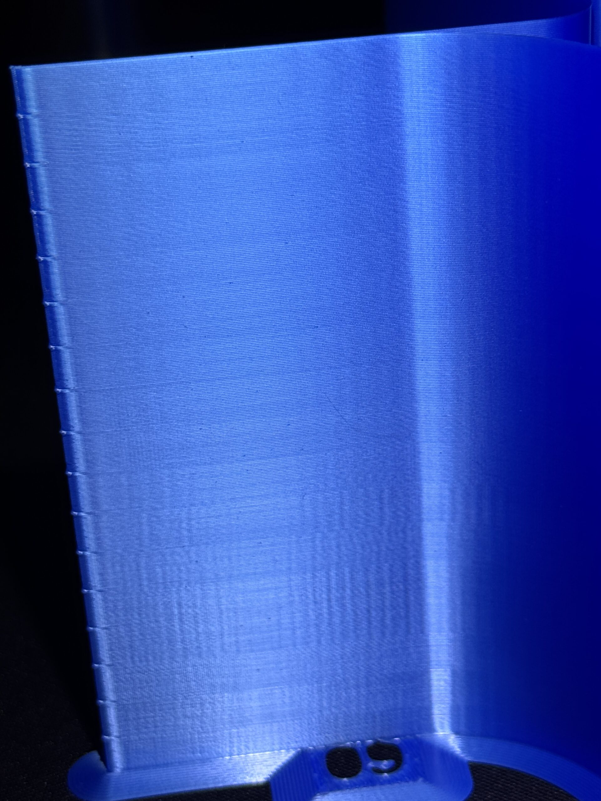

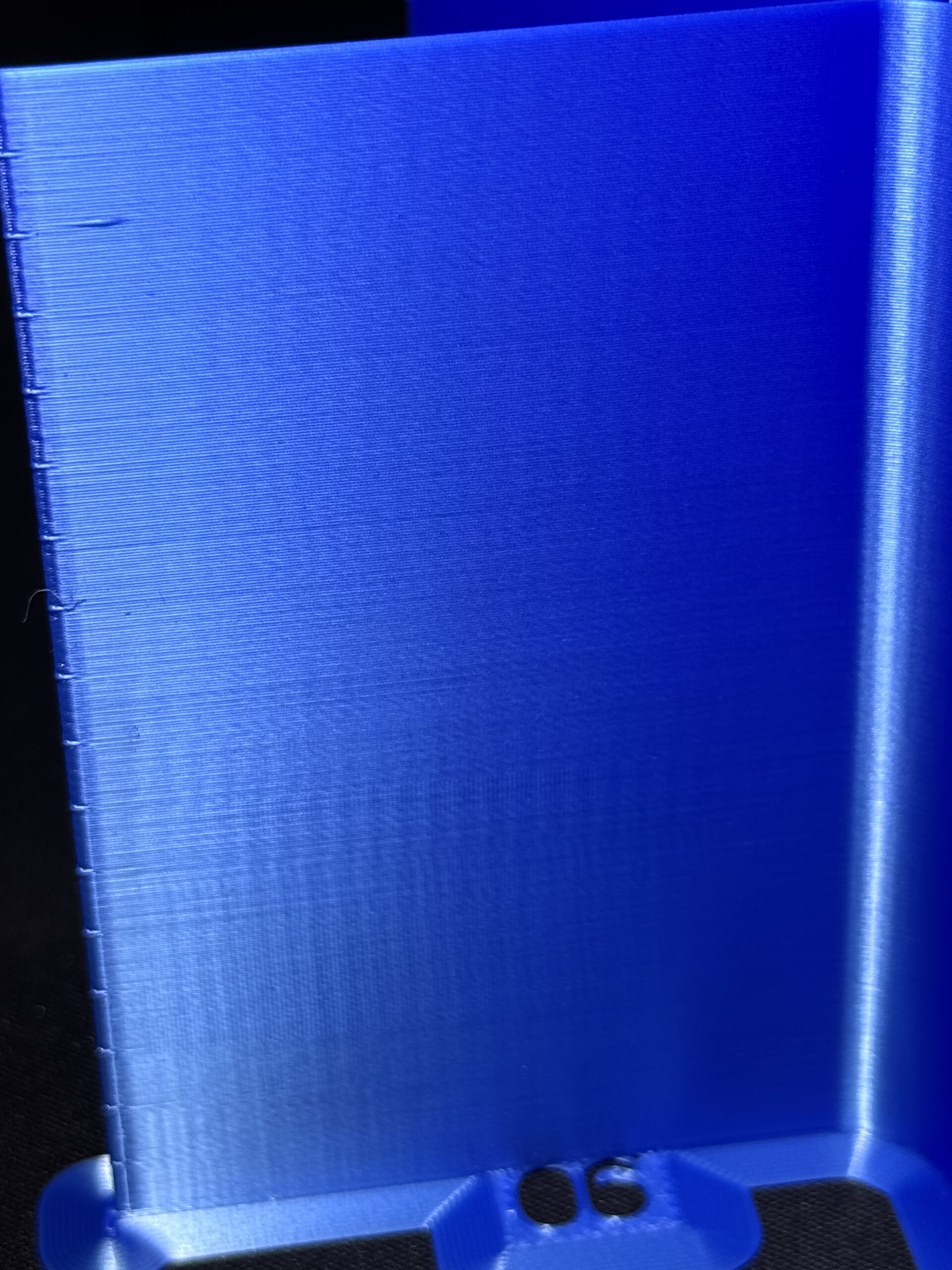

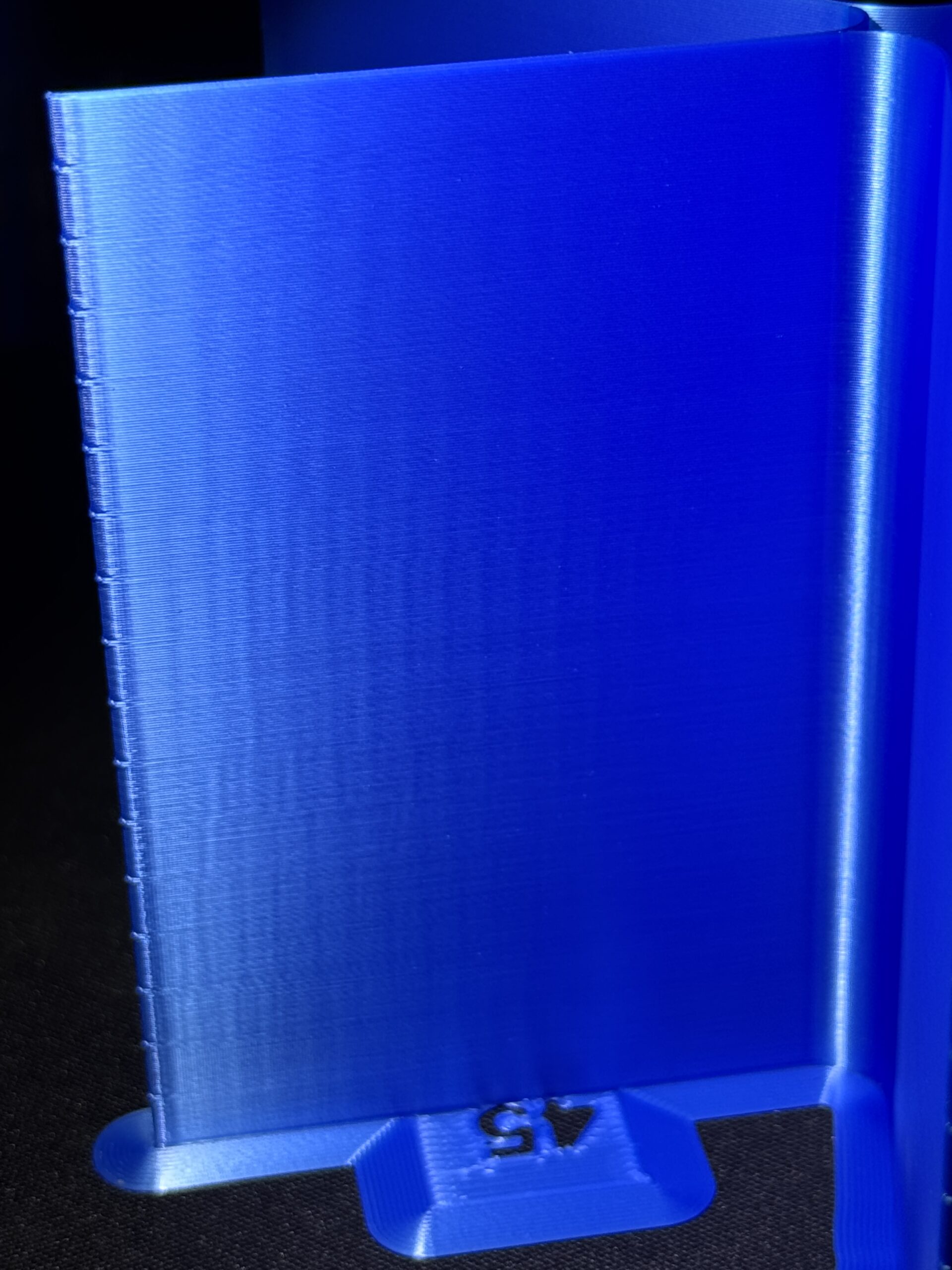

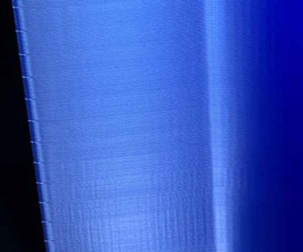

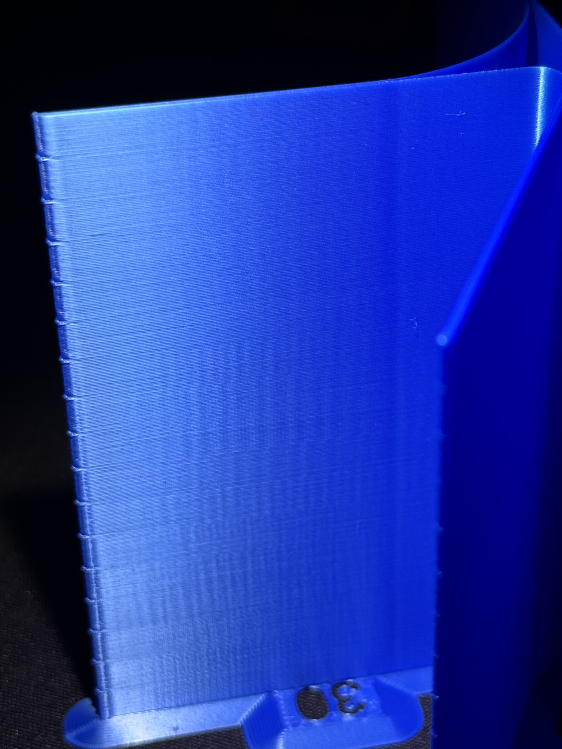

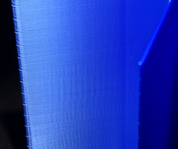

VFA Test Tower for Core One out takes:
